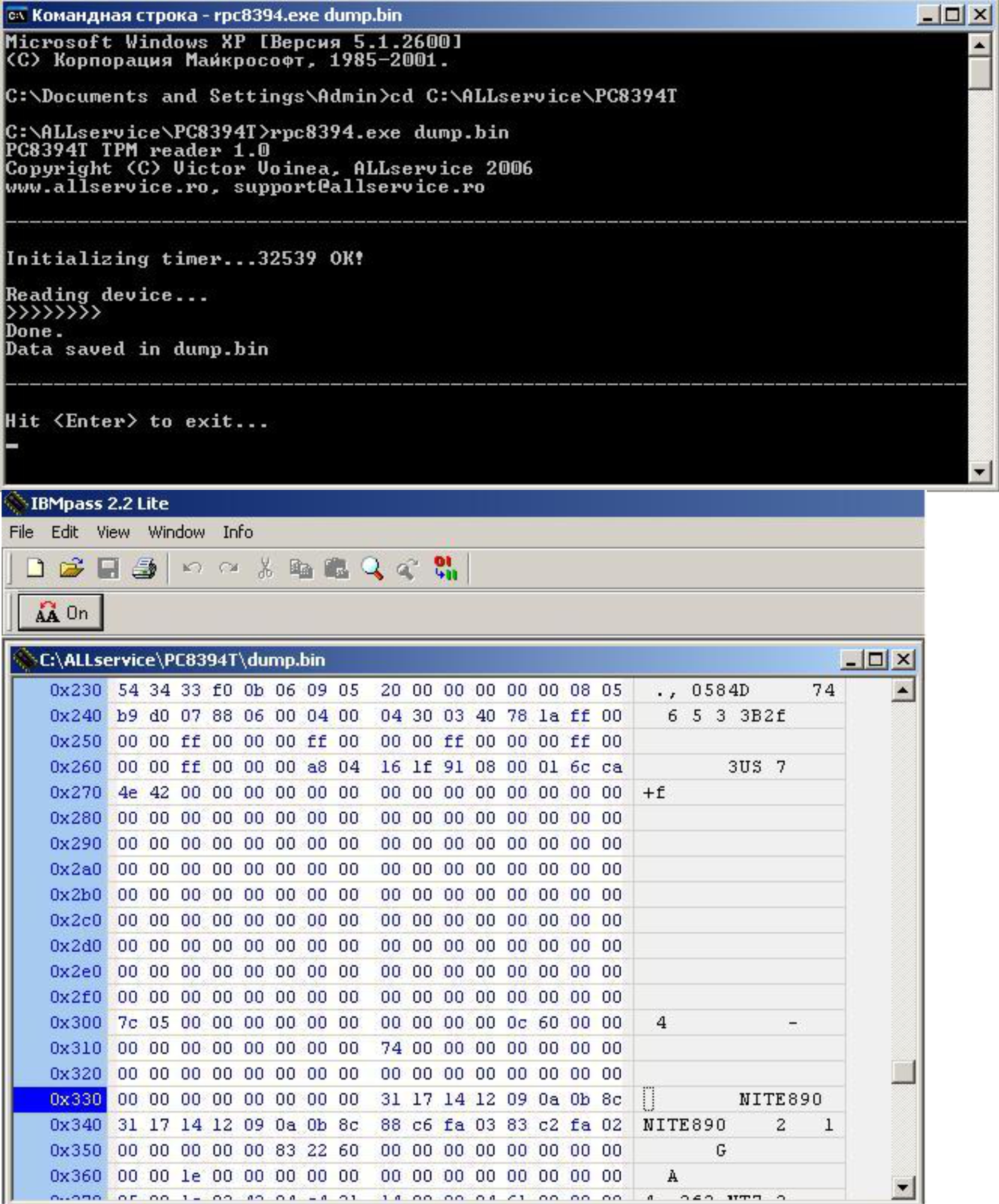

        #43
        Re: IBM pc8394 tools
        Dear my friend!
        I speak little English but I will try to explain to you.
        First run cmd: 1. Step START. Step 2 RUN. a window appears and enter the path to the rpc8394.exe file, but you have to type the name of the new .bin file
        example:
        C: \ PC8394 \ rpc8394 / ibmt60.bin
        Press OK
        After you go to that path on the HDD and find the new ibmt60 file and find the BIOS cipher in IBMpas.exe
        example:
        step 1.
        Start IBMpas.exe
        step 2
        File - Open - ibmt60.bin
        step 3
        Press the "AA Off"
        Look in line 0x330 and 0x340. and read Code
        good!

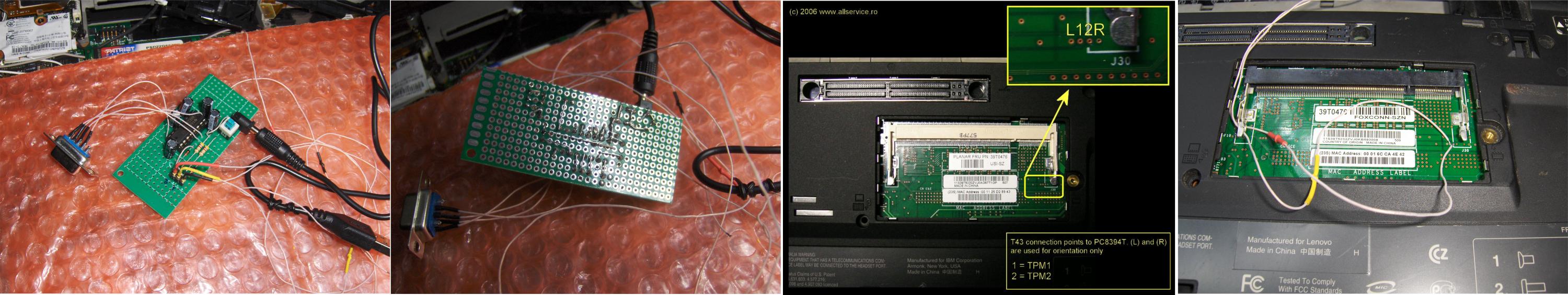

                          #52
                          @throwaway111
                          I have checked your save.zip files inside and none of them is correct.
                          Are you connecting the interface to the points indicated in picture included in PDF file (under bottom RAM slot)? Long time ago had unlocked this same ThinkPad R52 model, I remember that I had to scratch a little those TPM1 and TPM2 contacts.

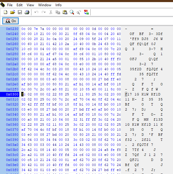

                            #53
                            Hi all! Someone unlocked the IBM T43 bios?
                            I took a dump with a minipro TL866a programmer.
                            T43
                            Forgot to specify, EEPROM - atmel 24c64an
                            At what addresses in ibmpass to look for a password?
                              #54
                              From the RPC8394T/WPC8394T interface manual:
                              Open the dump file you've created before in IBMpass, activate the A-A button and search for 0x330, 0x340 lines. The password is located on 0x338 and 0x340 in scan code.
                              When the pass phrase is activated, the password is encrypted using TCPA RSA-SHA1 algorithm. In this case the dump must be modified and the TPM chip reprogrammed.
                                #55
                                I opened my dump t43 in IBMpass 2.1 Lite. I can't figure out where the password is.
                                  #56
                                  Got back to my T43.
                                  Assembled interface for PC8394T on MAX232.
                                  Saved the dump, read it with IBMpass.
                                  Got SVP.
                                    #57
                                    @Karter
                                    Great! You were able to recover the Supervisor Password at offsets 0x338 and 0x340 (“NITE890”).
                                      #58

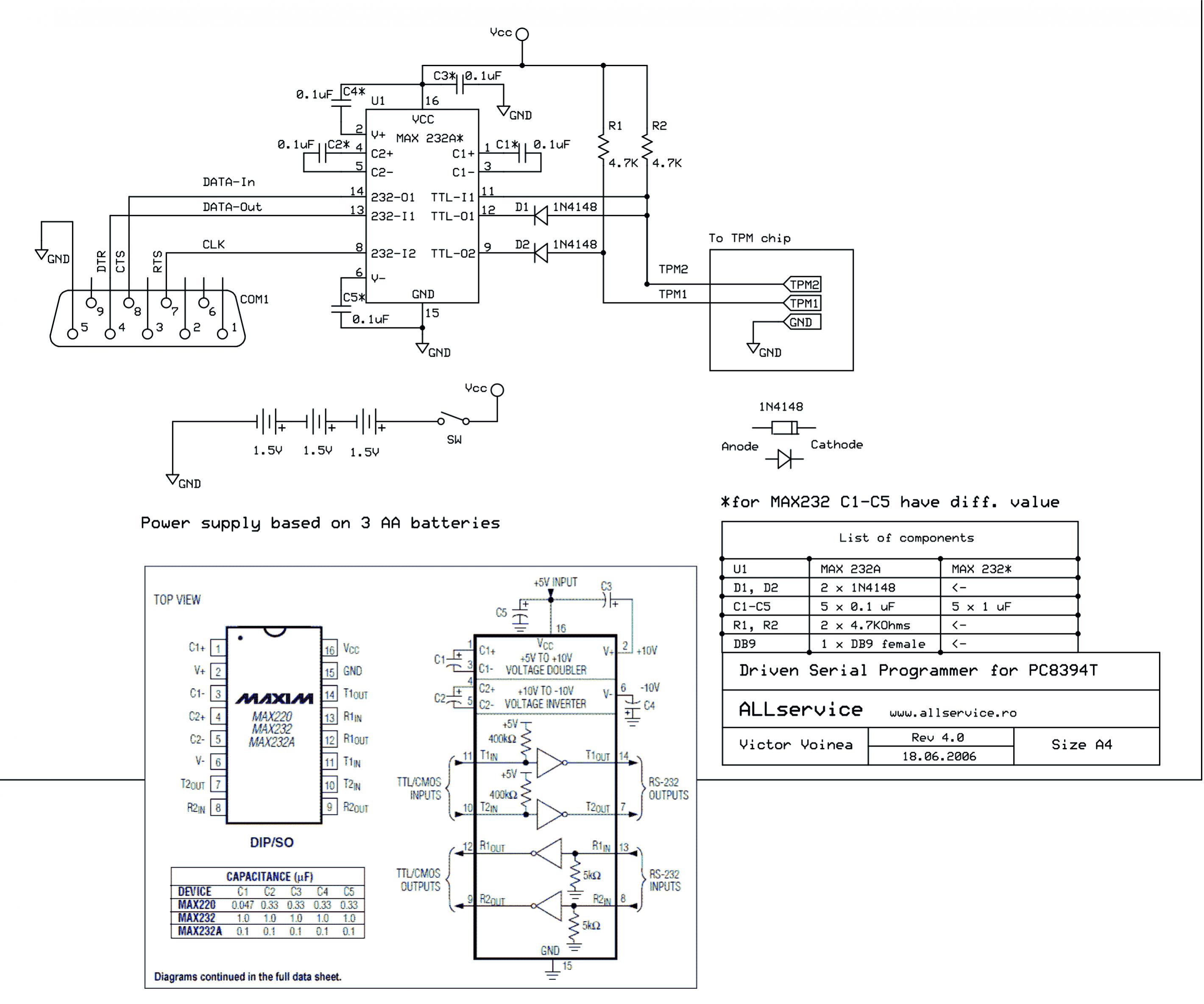

                                        #59
                                        Hello there
                                        I'm about to try my luck with a Thinkpad T40, but there's something that bugs me.
                                        If you read the diagram, the top schematic caps C4 and C5, are somehow inverted as how the manufacturer schematic connects them at the bottom. I'm no longer sure what the orientation of the Caps are.
                                        C5 should be neg. connected to the chip pin 6 on the bottom schema, but in the top diagram is clearly C5 pos. connected to pin 6.
                                        C1 and C2 and C3 (C5 at bottom) are wired the same in both schemas. Since bottom looks official, now I'm unsure. I've followed the top schematic until completion, but it is right?
                                        Cheers.
