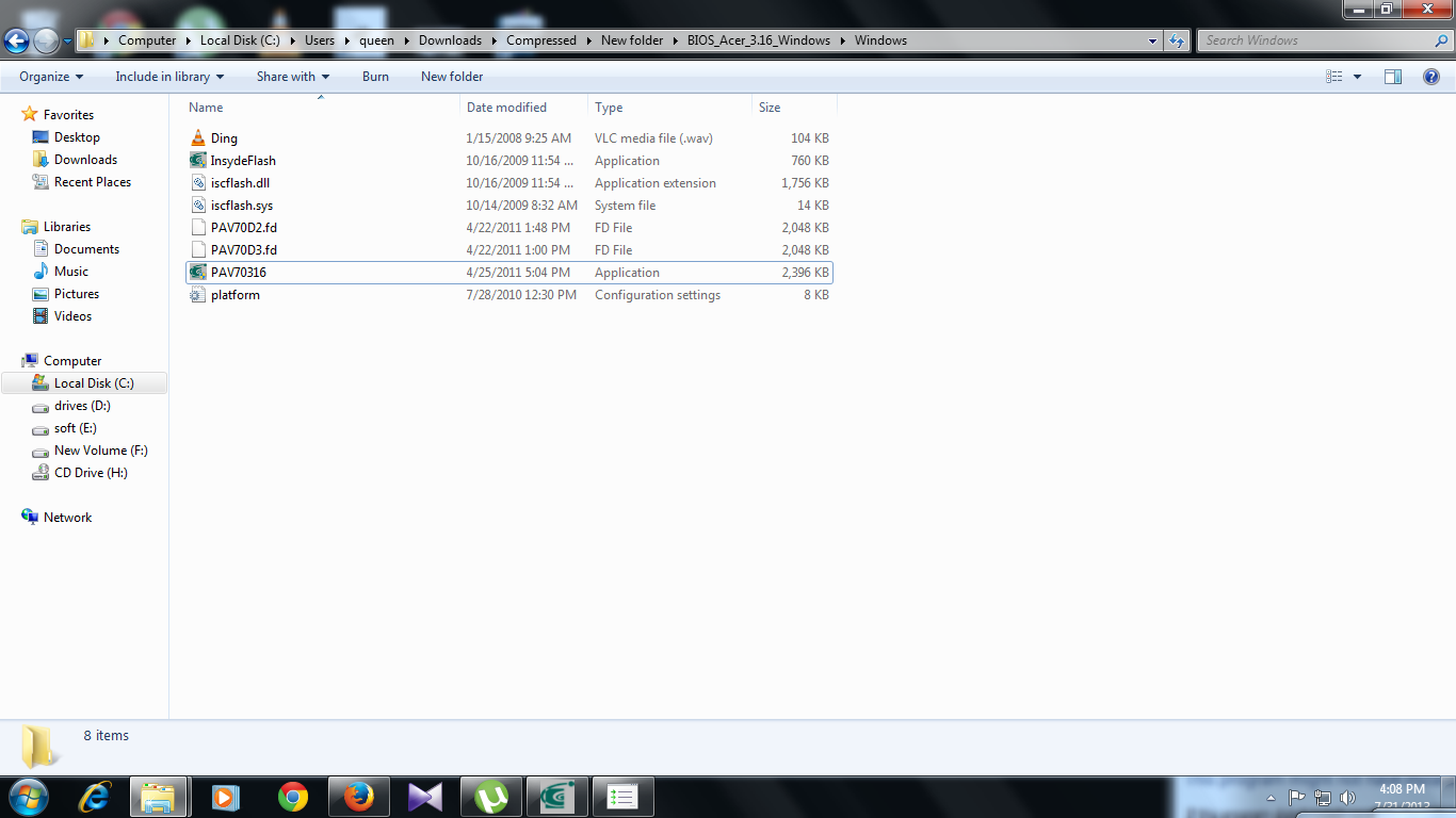

              how to identify a bin file ex-bile acer 4736z extractor files

                Post the contents of the "platform" file. Is your laptop working or not? If yes, you can try the flash program that will flash the bios in windows.

                  This looks like a windows flash for this machine: global-download.acer.com/GDFiles%5CBIOS/BIOS/BIOS_Acer_2.04_A_A.zip?acerid=633942225688215564&Step1=Notebook&Step2=Aspire&Step3=Aspire%204736&OS=V10&LC=en&BC=Acer&SC=AAP_2

                    The KALG0204.fd looks like the bios file if you need one.
                    Here is a link for 2.08 bios: http://driverscollection.com/?file_c...d30b091f63d515
                    Bios file should be KALG0208.fd
                    !!! When you do the bios update through Windows, and it freezes, just let it sit, it should eventually finish !!!
