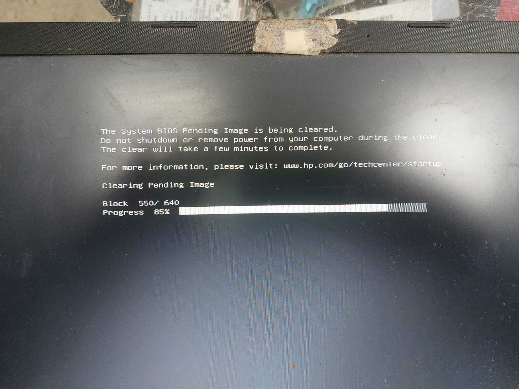

    Hi i have an hp 14-dk0001ns PROD ID : 6PC65EA#ABE S/N : 5CG012DD0G
    Laptop starts but screen stays black and fan is spinning i suspect bios is corrupted , can you please fix it for me
    here i attach bios file

    Use the bios from post #14..085B1
    DMI 283000 - 283FFF
    KEYWIN - 2A5000 - 2A503F​

      Thank you. It works. But when the laptop turned on, i have a text "The system bios pending image is being cleared. ... " Then restart and black screen. I recorded the BIOS twice but the result did not change. Is this problem with bios version or bios chip, motherboard?

          Thank you it works, it shows the attached screen then restarts and screen stays black and flickering
