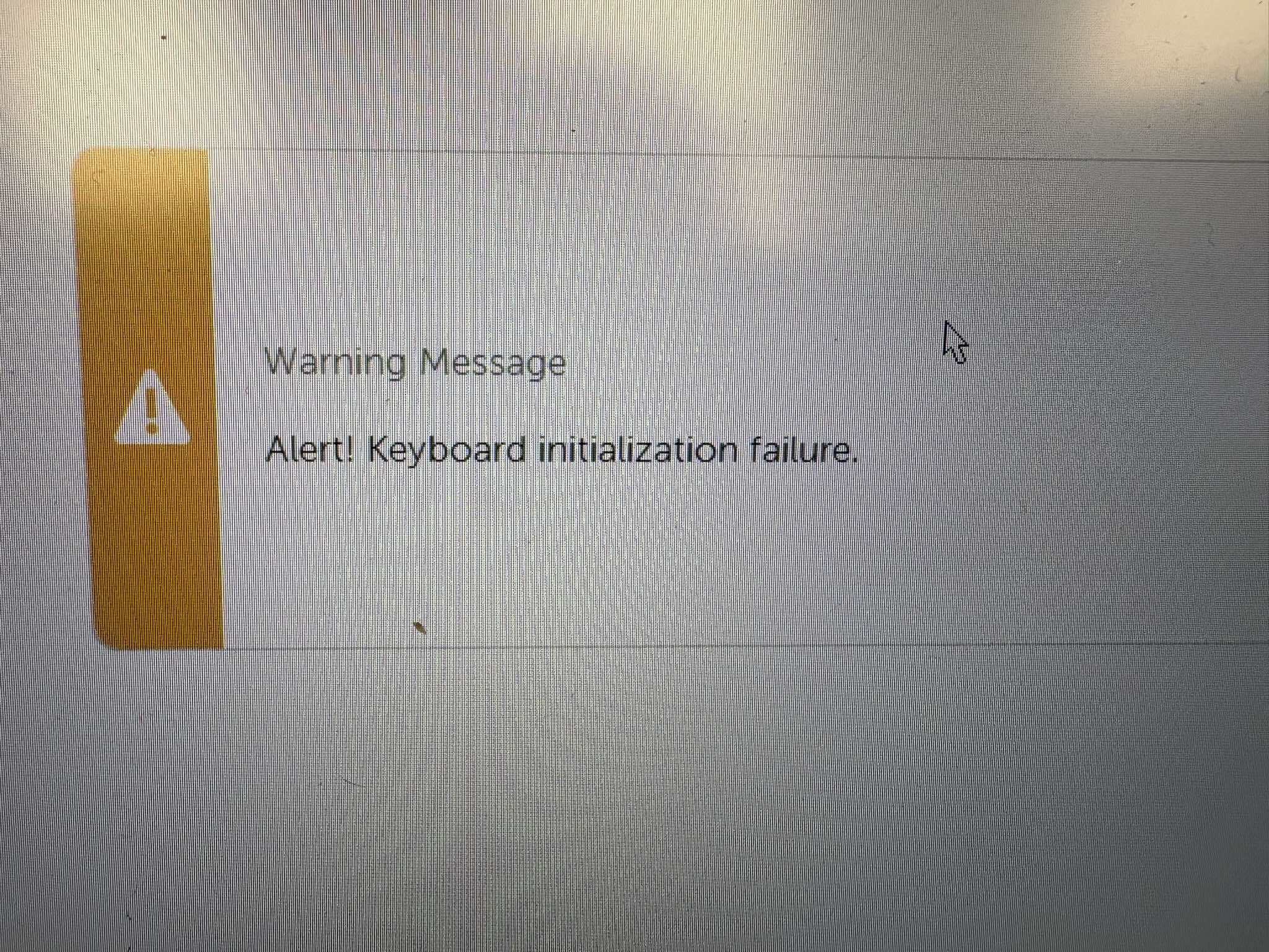

                      dell XPS 15 7590
                      motherboard EDP51 EDB51 LA-H331P REV 1.0
                      sn 2G51M63
                      black srean
                        Hello try ....
                          Originally posted by Markus1741 View Post
                          Hello try ....
                          This message related to the BIOS appears every time the system is started.
                          The keyboard and touchpad do not work in the BIOS, but they function correctly in the operating system. Click image for larger version
                            Hello try ....
                            Model - Dell XPS 7590
                            Service Tag - 9D6V8Y2
                            Bios chip - GD25B256DYIG
                            Auto Recovery triggered during boot and didnt properly flash, now top row of keyboard does not work from q to p . Have to fiddle a lot to make it turn on, charger disconnect and reconnect multiple times. Crashes automatically. I have made a new backup of bios. Attached below. Please help.

                                Hi, try and feedback
                                The laptop boots fine - specific keys still do not work - namely - qweruiop . It autoflashed and updated to 1.27 . i disabled uefi bios updates in bios and flashed your firmware again. Rebooted the laptop and Firmware Update started again and failed and windows turned on, restarted again and firmware update started again(updaing system bios with bios guard), bios updated again and windows loads up, keyboard was working fine before these bios issues, so its not hardware issue . I also tested the keyboard in the bios after i have just flashed the file you provided and the specified keys dont work.

                                  Hi just checking back if possible to fix the keyboard issue, for some reasons even with the somewhat working bios the keyboard keys qwer uiop arent working, even after doing recovery and update using ctrl + esc recovery..
