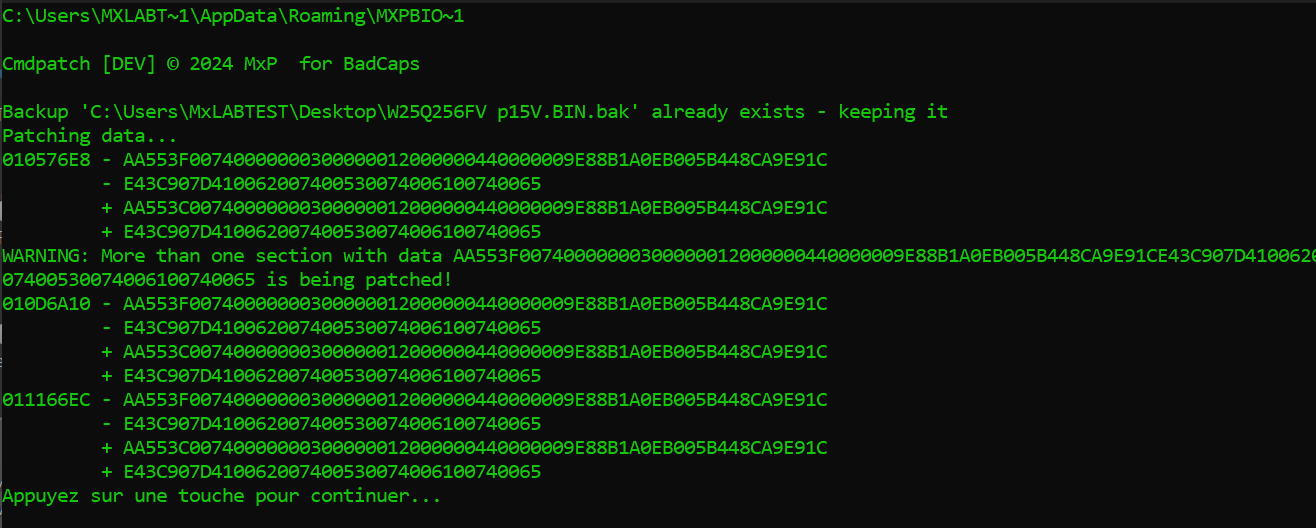

please can anyone remove the enrollment or mdm from this bios. thanks
lenovo p15v gen 3
sn : PF-43ZJX6
board :
JP6A0/JT6A0 NM-E221 Rev: 1.0
W25Q256FV p15V mdm.rar

computrace and autopilot remove
EDIT .take new file .

try only autopilot
Have you enabled computrace in the bios?
or you have a problem installing windows
W25Q256FV p15V mdm(1).rar

Maxpower3
Bad Veteran
Join Date:
Feb 2018
Posts:
1105
Country:
France
03-15-2025, 10:36 AM
a variable that forces you to connect to the internet is also present.
I have not deactivated it yet

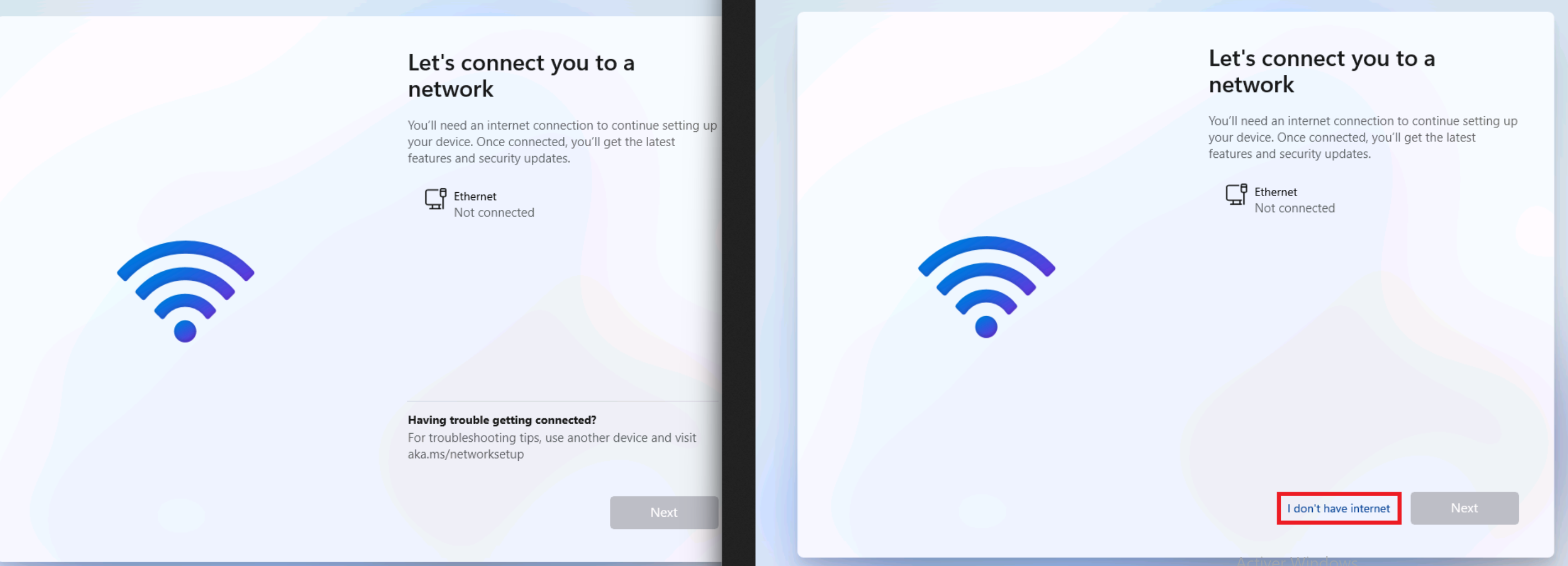

03-15-2025, 10:48 AM
try
Autopilot+FORCED_NETWORK_FLAG_Remove.rar
Post

Same result I can't bypass network when i setup windows

04-08-2025, 08:32 AM
Originally posted by
Maxpower3
View Post
try
after i fix the first lenovo . i reflash with this dump and its working perfect thank you so mush bro
