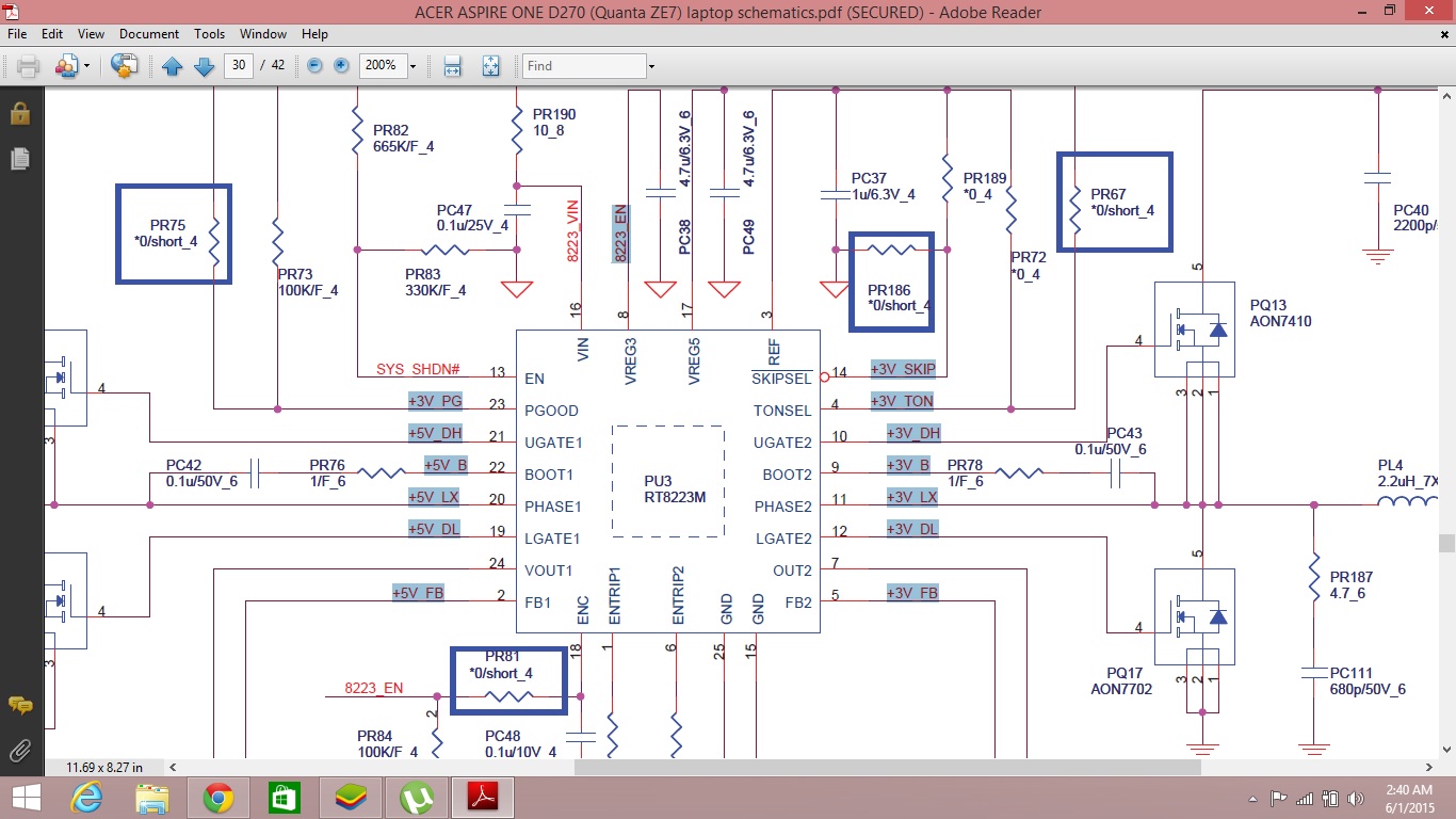

    no power indicator. no 3.3 v and 5v alws.
    no shorted coil
    i just want to try bios first.
    tnx.

      tnx but it does the same..
      i checked PU3 and here is my voltage reading.
      pin
      1. 1.0 v
      2. 0v
      3. 2v
      4. 0v
      5. 0v
      6. 0.4v
      7. 0v
      8. 3.3v
      9. 5v
      10. 0v
      11. 0v
      12. 5v
      13. 5.9v
      14. 0v
      15. 0v
      16. 19v
      17. 5v
      18. 3.3v
      19. 0v
      20. 0v
      21. 0v
      22. 4.7v
      23. 0v
      24. 0v.
      Is that faulty?

        Re: acer d270 bios needed.

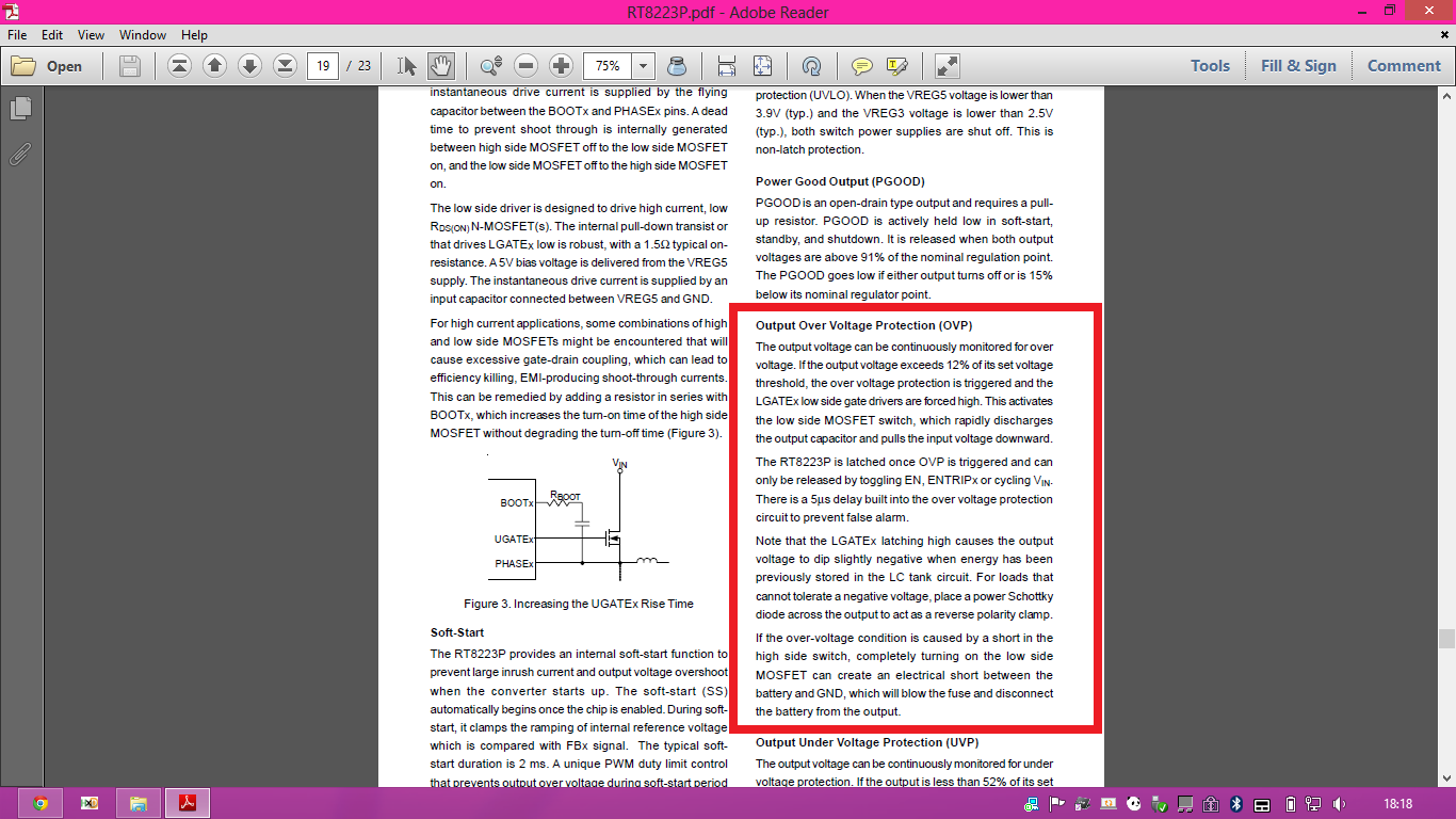

        change pc58, its OVP
        • rickybucalan
          • May 2013
          • 322
          • philippines
          what thats means?
          • meritosari
            • Oct 2010
            • 774
            • Indonesia
            over voltage protection
            try replace pc58 with tantalum, not solid caps
            look datasheet rt8223p

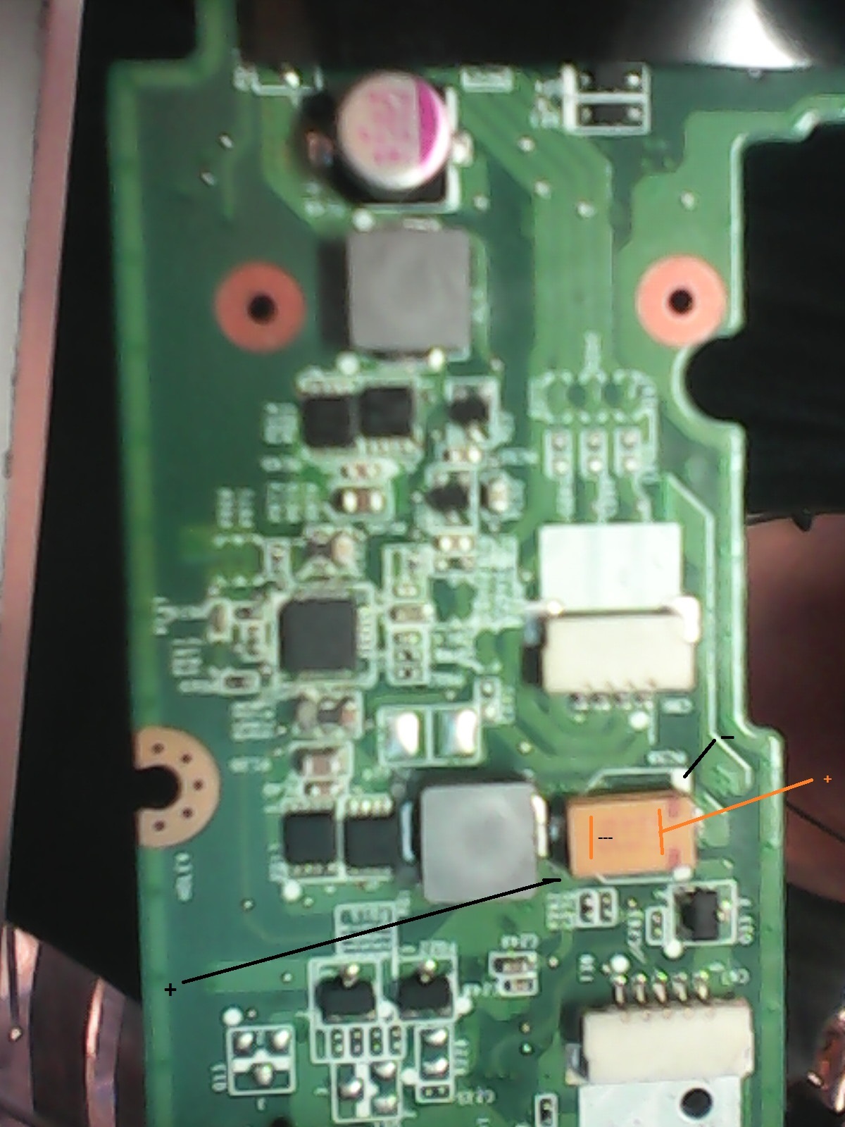

                            i already found one 227uf 6v but does the same now i lost 5v on pin 12.

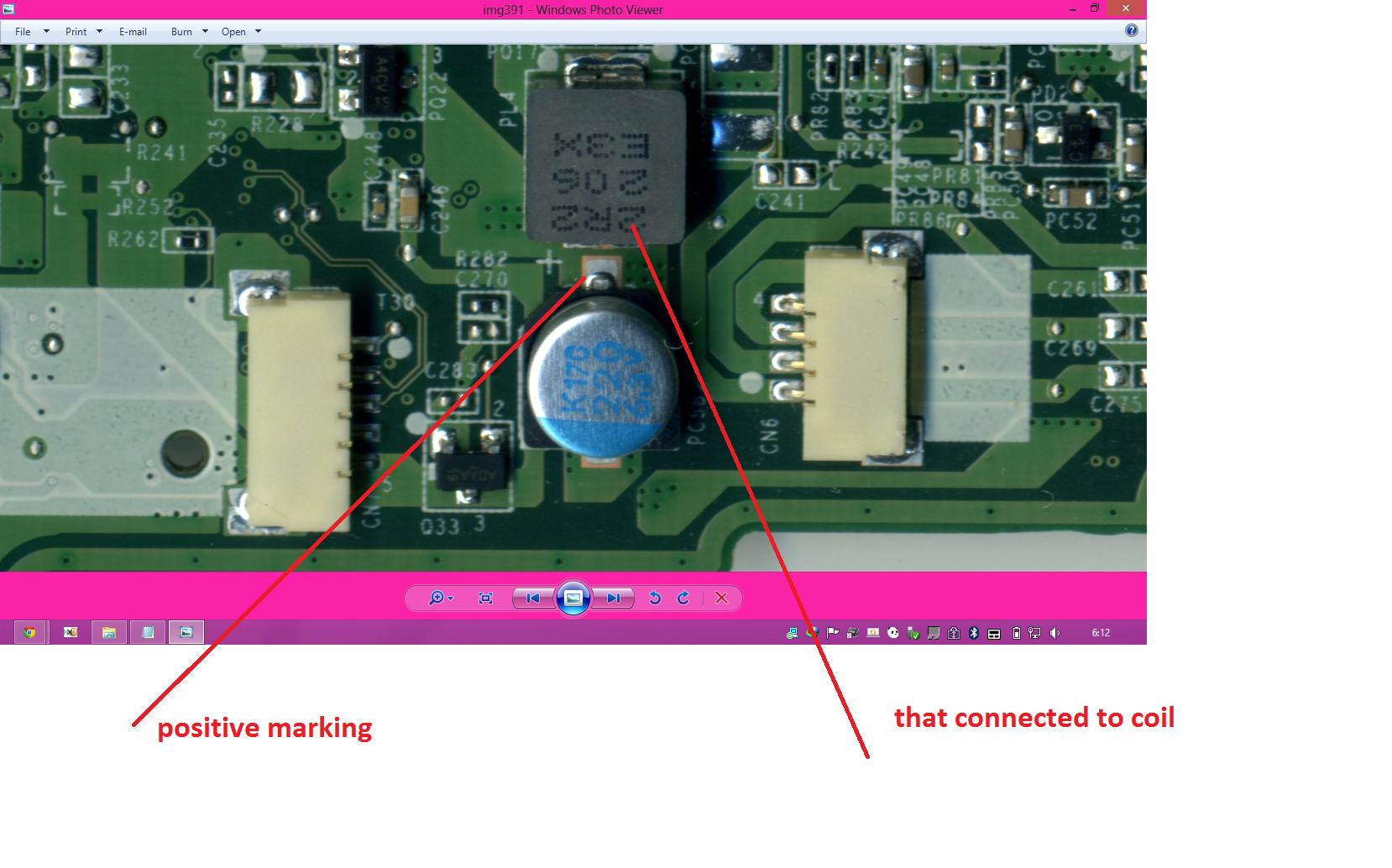

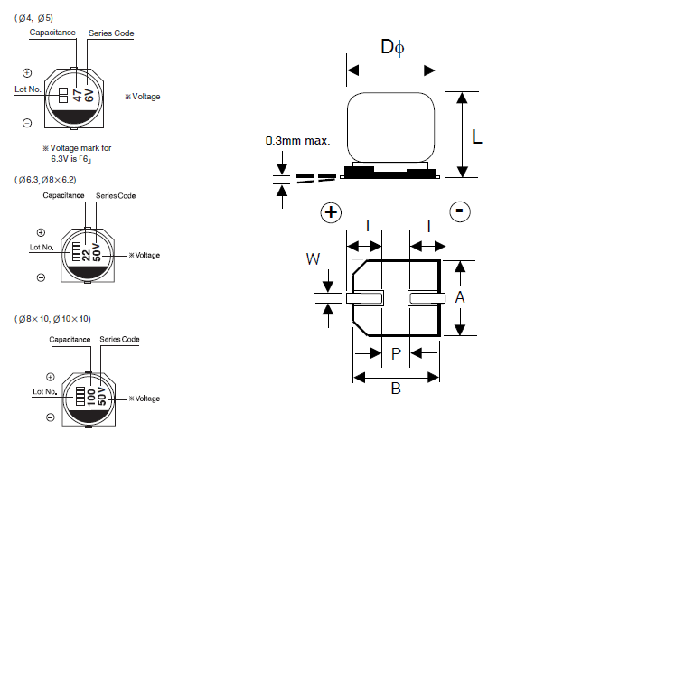

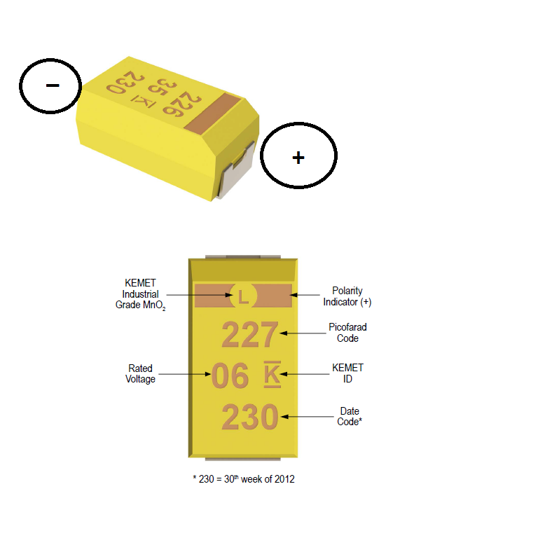

                              I look at the picture, you have to install the capacitors with the wrong polarity position. look more carefully, coil its positive rail.
                              maybe you have broken that tantalum again, i hope not more damaged the other components

                                info:
                                • rickybucalan
                                  • May 2013
                                  • 322
                                  • philippines
                                  info:
                                  oh man i'm so stupid.
                                  but thanks GOD it still working after i return to proper position.
                                  thanks to you meritosari.......
