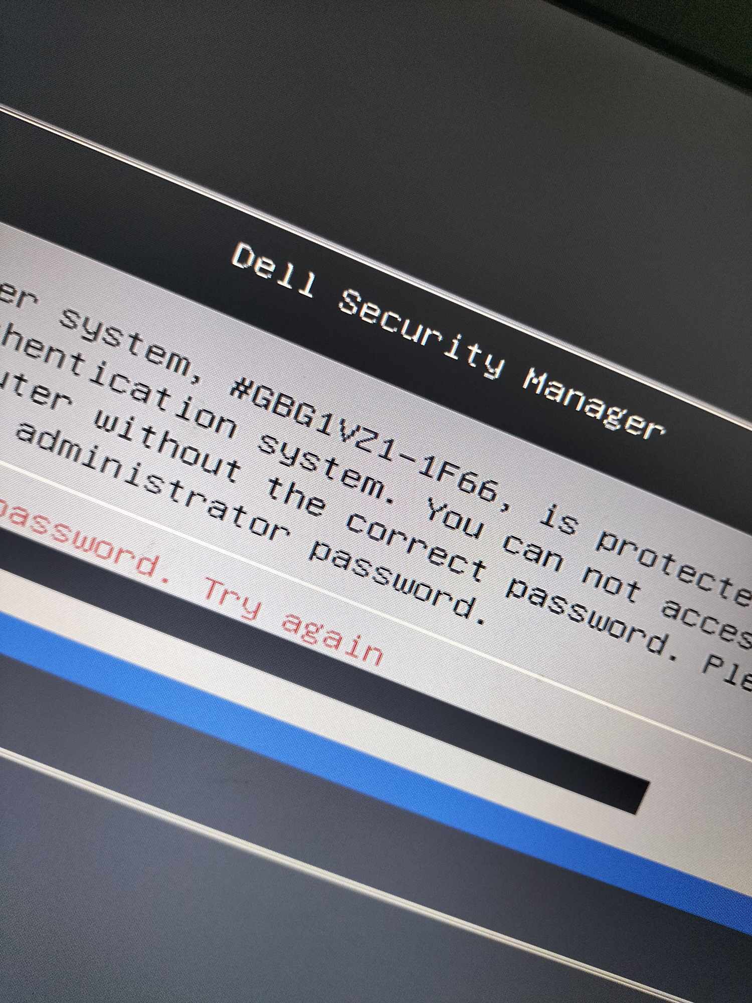

                  Re: Dell Bios Password For -1F66
                  Can you help me with the master password for this dell #GBG1VZ1-1F66
                    BIOS guides, methods, resources and tools
                    https://www.badcaps.net/forum/showthread.php?t=103526
                    https://web.archive.org/web/*/https://bios-pw.org/

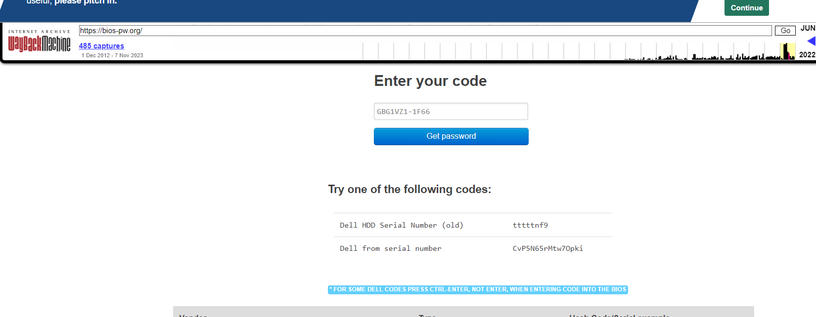

                        working ok https://web.archive.org/web/*/https://bios-pw.org/
                              I tried it but it doesn't give me any password
                              It does generate a code as my picture proves.Also alisaler generates the same code
                              https://www.badcaps.net/forum/showpo...2&postcount=12
                              And if they aren`t working read the notes:
                              3.4. Dell
                              Dell laptops store the password in EC. However, some generators exist depending on the code suffix.
                              See: https://beta.bios-pw.org/ .If the website is offline try: https://web.archive.org/web/*/https://bios-pw.org/
                              Note: All passwords must be entered with a US QWERTY Keyboard,you can use a USB one.
                              Note: The 6FF1 suffix has a bug,use your service tag with the 1F5A or BF97 suffix instead,Example: 1234ABC-BF97 .
                              Note: The list of examples does not include some other suffix codes that do work,such as E7A8 .
                              Note: If the BF97 suffix does not work try it with the E7A8 suffix instead.
                              Note: There is no publicly available 8FC8 generator available at the moment.
                              The CTRL-ENTER-ENTER keystroke after the password only applied to laptops with a suffix (xxxxxxx-8FC8 for example), until Dell also required it in some laptops using System Disable 16-Hex algorithm, on which only the Password+ENTER was needed at first and then in some models you needed the CTRL-ENTER-ENTER to properly delete the system passwords, otherwise the password would remain SET upon the automatic system reboot if just doing Password+ENTER until the proper CTRL-ENTER-ENTER keystroke was performed in certain models.
