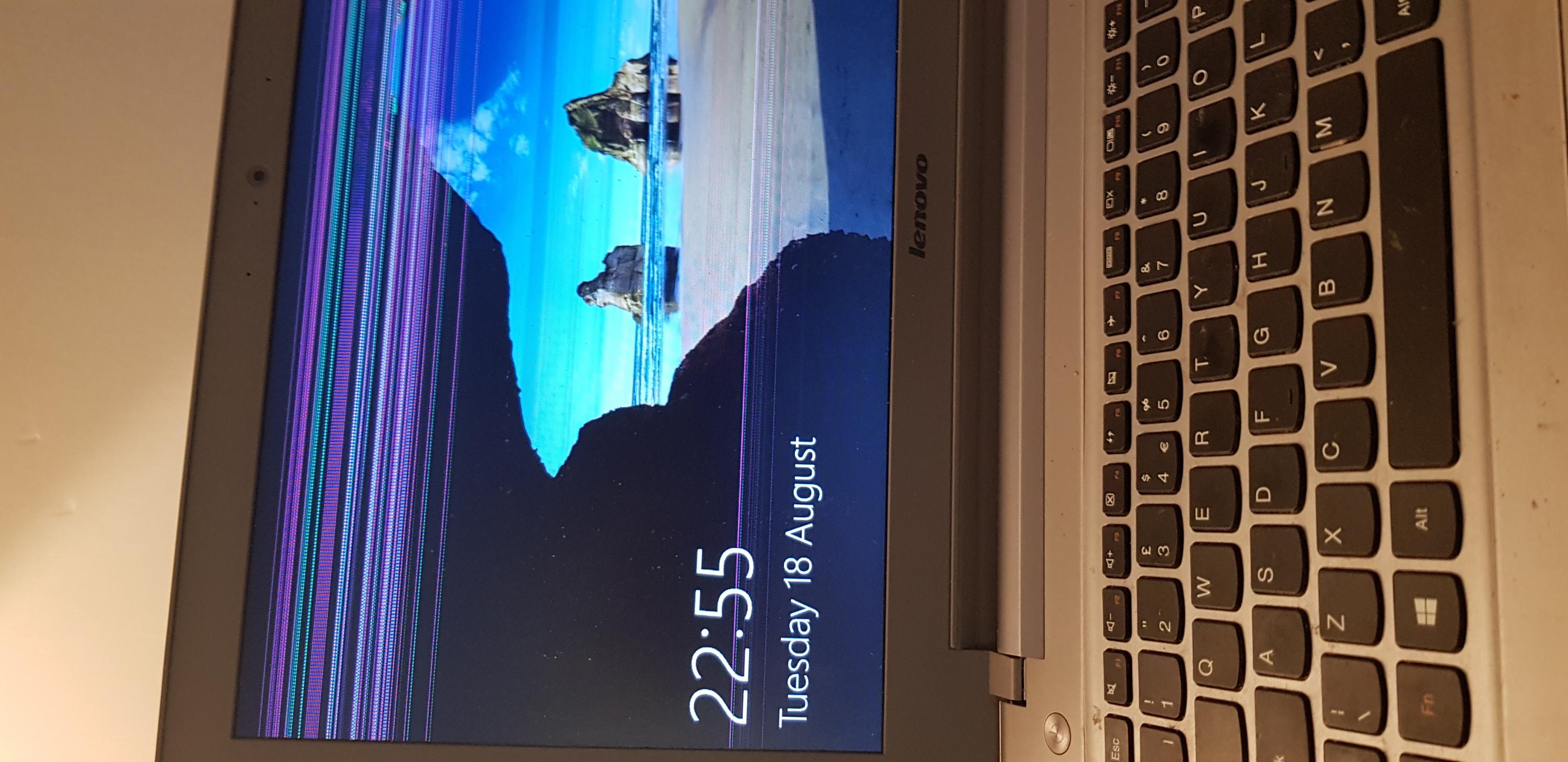

                        i have a z510 with screen issues how do i use these bin files
                        TIA

                            What do you mean by screen issue !!...if your lap work but no display at intern/extern than post here your old dump
                              Re: lenovo z510
                              screen issue stripley lines on boot up they stay for 30 mins or so then display clears also the external hdmi video is okay
                              how do i dump
                                Re: lenovo z510
                                how do i dump
                                post some pictures..let's see what it looks like ..

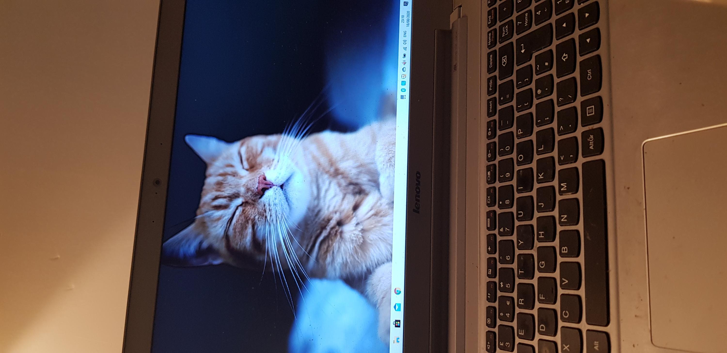

                                  Re: lenovo z510
                                  external
                                  laptop screen
                                  https://drive.google.com/file/d/1hQV...ew?usp=sharing
                                  10 mins or so later all good
                                  https://drive.google.com/file/d/1i-0...ew?usp=sharing
                                    Re: lenovo z510
                                    post the pictures here..down in the page ... go advanced, manage attachments, browse, upload, etc ..
                                      Re: lenovo z510
                                      laptop after a cold boot lines on screen then after a while they go away
                                      the amount of lines varies as dose there screen position
                                        Re: lenovo z510
                                        for a start try the test with another display.
