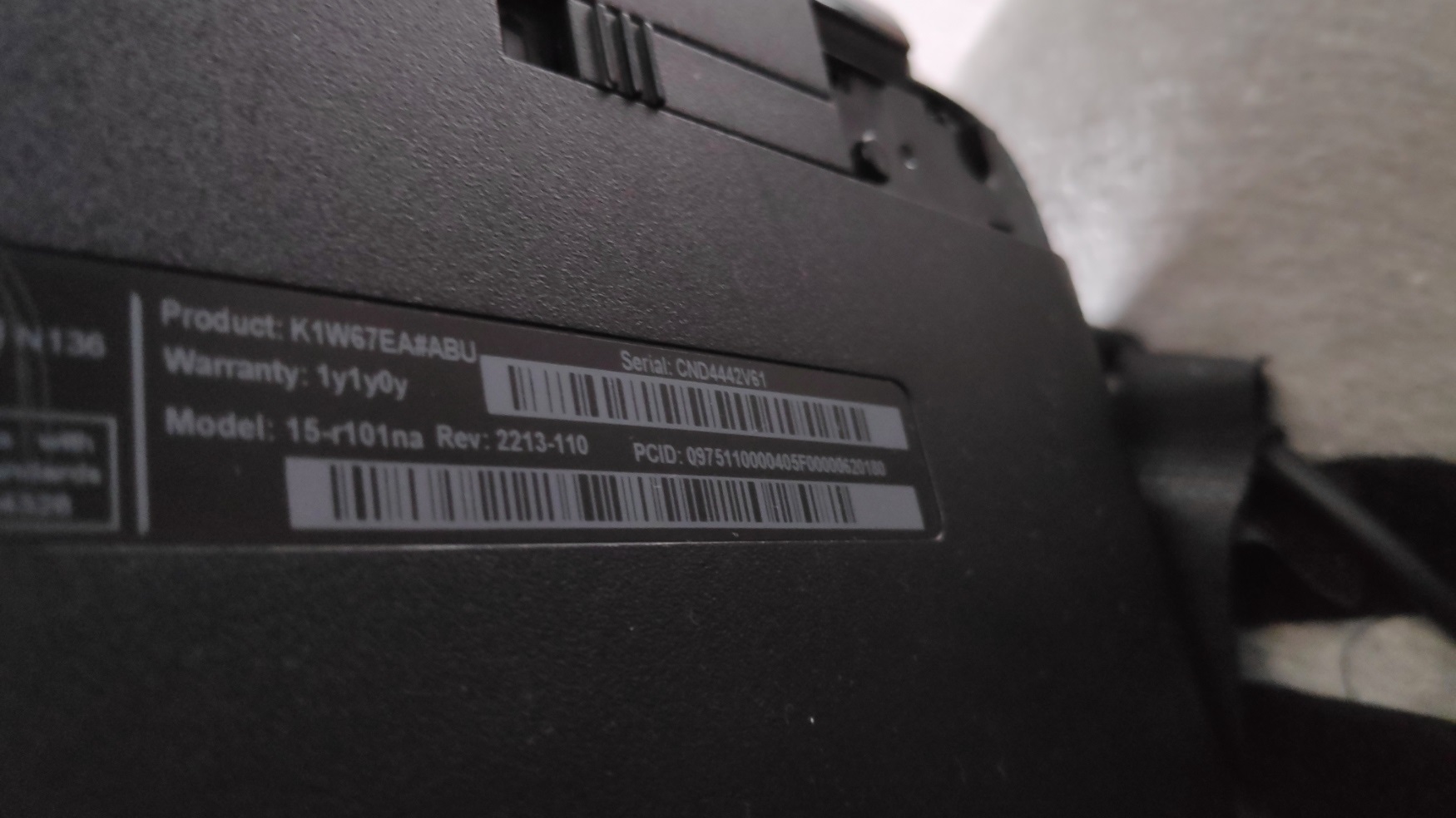

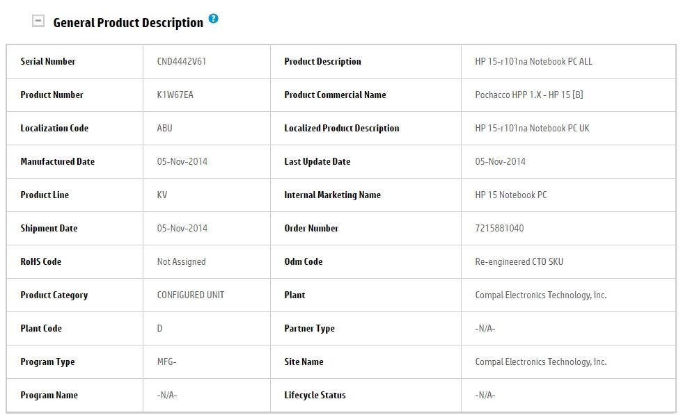

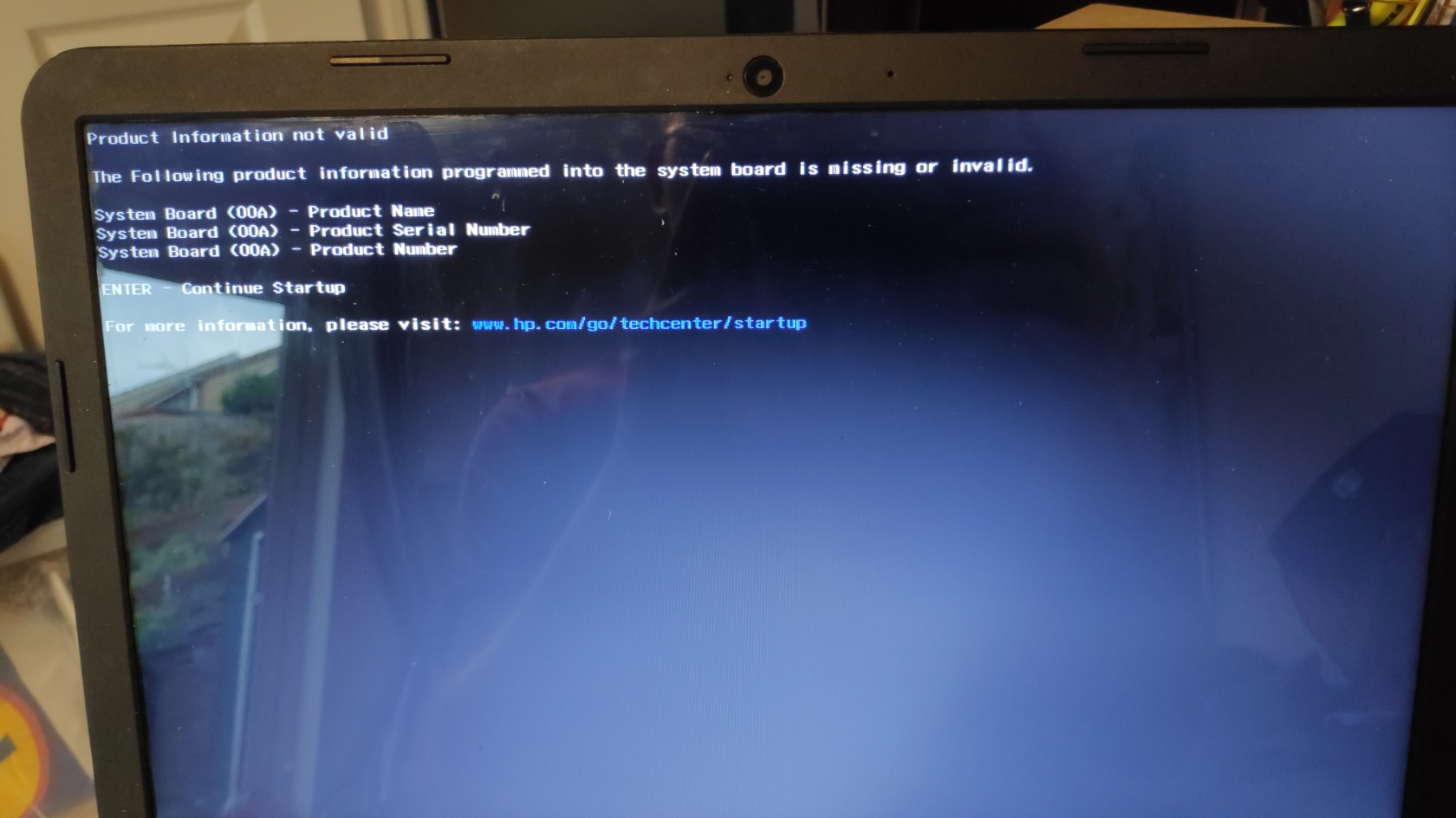

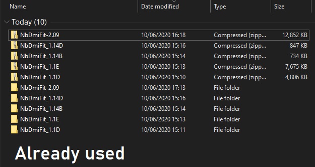

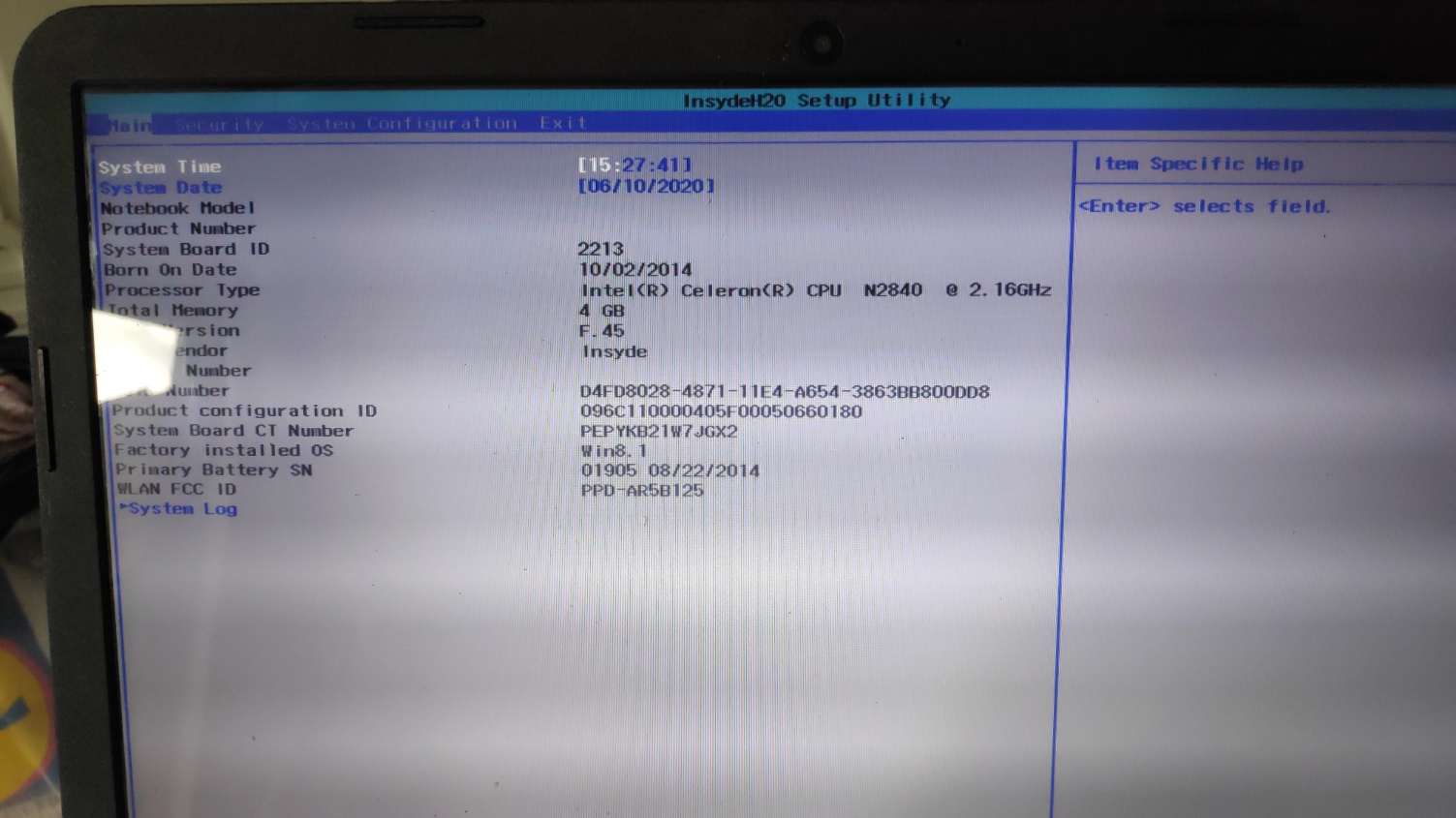

                                        Hello all.
                                        This is my first post as new user so hello all.
                                        Got similar problen with my laptop HP-15-r101na.
                                        After replacing motherboard receiving three error which I expected to easly fix.
                                        Well - not really.
                                        Can find proper tool to do so.
                                        1. System Board (00A) - Product Name
                                        2. System Board (00A) - Product Serial Number
                                        3. System Board (00A) - Product Number
                                        The only one think able to do was to update BIOS to version F.45
                                        Then I`ve tried to use different version of NbDmiFit with error platform not supported
                                        According to HP Serial Number Repository (Product Configuration Tracker) laptop was manufactured in 2014 so I`ve used tools supporting in theory this model - but platform not supported appear in DOS, Windows, WindowsPE
                                        Can you recommend proper tool or any idea what I am doing wrong, please.

                                          Use HP bios config utility BCU ,and/or wndmifit from windows or nbdmifit from UEFI flash drive . Use version 2.10 or above.
