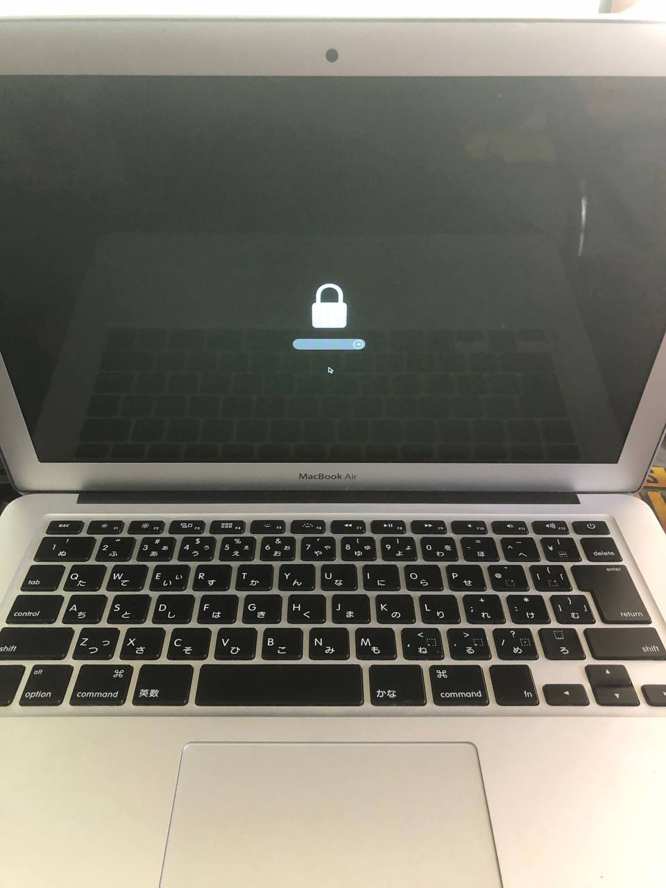

    Friends I want to thank you all for helping me solve the problem, I was able to reinstall the OS and now is working perfectly, I used the ONLINE RECOVERY because somehow the INTERNAL RECOVERY I was not able to access it, so when Recivery was installed from Internet I was able to access DISK UTILITY, then i erased the INTERNAL SSD, I selected REINSTALL OS, then it showed me option to download I downloaded but it Kept failing sometimes when at the end would fail,, I spent more than 30GB of data trying to download the EL CAPITAN OS, I left it to download overnight, and when I woke uo I found it downloaded and asking to Select region, Thanks and HUGS everyone, I will make a small donation to the forum

            Please clean my DUMP 820-00165-A
              Re: Mac air a1466-820-00165-a-lock
              the posted bios is corrupt and longer..check this before posting with the HxD program..copy the content once more and post again..

                  post the full name and model of the laptop, A, EMC, S/N, motherboard model..
                    A1466 EMC 3178 Serial FVFTX2A3J1WK
                    820-00165-A
                      820-00165-A
                      try..
                        It's working perfect! Thank you a lot
