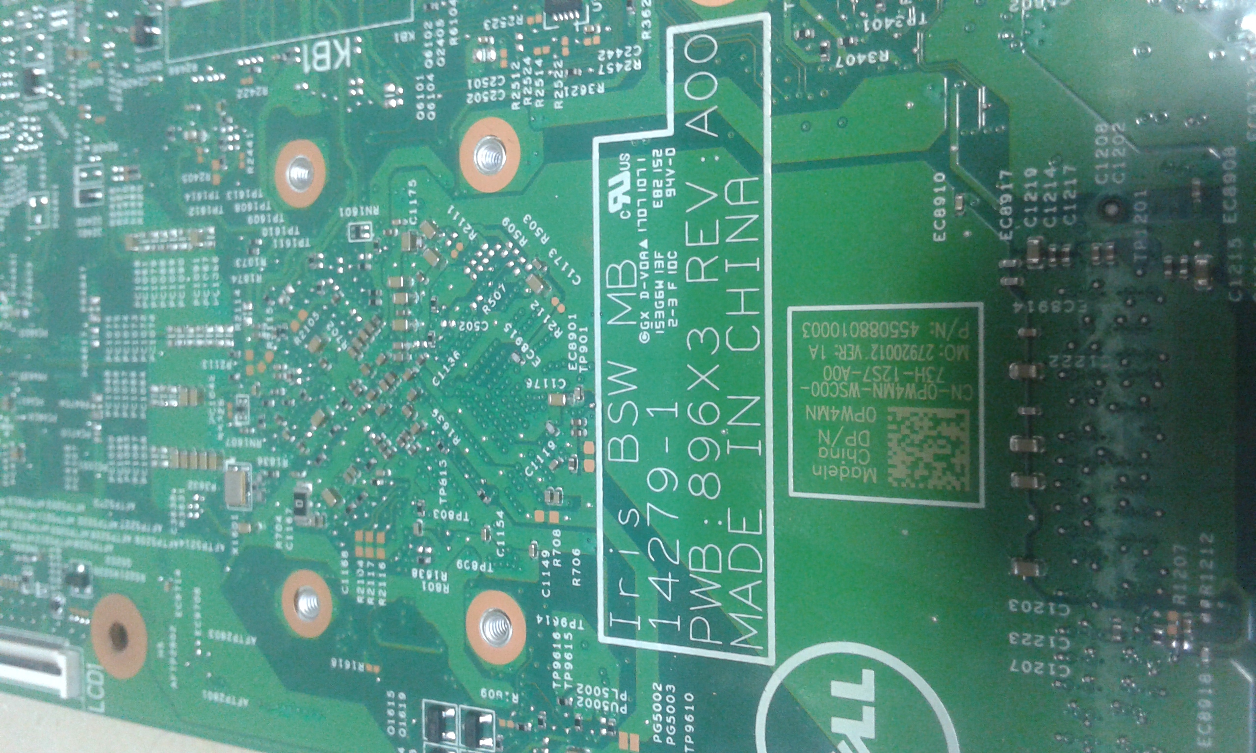

    bios dell 3551
    I need to bios for dell 3551 . I'm not sure from model but this photo for board number
    https://www.badcaps.net/forum/attach...1&d=1561715805

        Re: bios dell 3551
        Just a reminder before flashing-The bios chip on this mb is 1.8V.

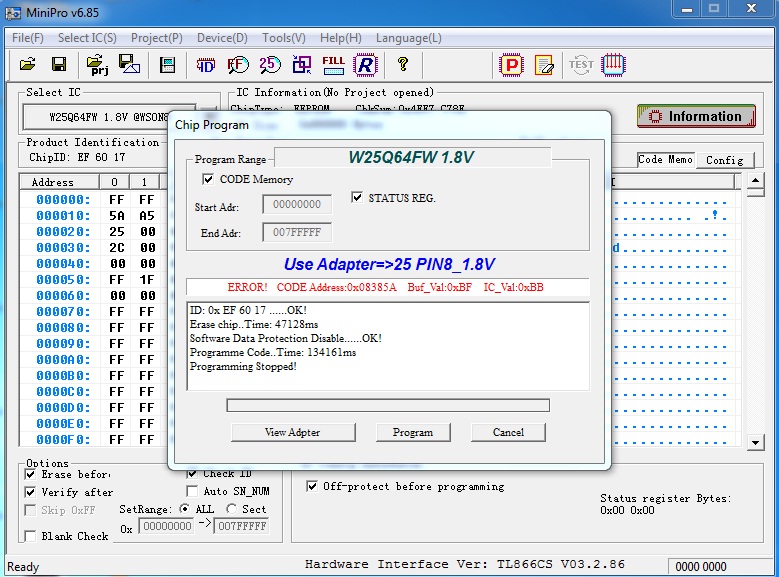

            Re: bios dell 3551
            During the programming show me this message
            https://www.badcaps.net/forum/attach...1&d=1561723154
            • aliiash
              • Jun 2019
              • 99
              • england
              Re: bios dell 3551
              I tried three different files but this message appears to me every time

                Re: bios dell 3551
                change the chip..
                • aliiash
                  • Jun 2019
                  • 99
                  • england
                  Re: bios dell 3551
                  Originally posted by peste
                  change the chip..
                  I changed the chip and programmed him successfully but laptop don't power . I tried more bios files

                        Re: bios dell 3551
                        put the old bios on the new chip ...maybe the laptop has other problems if it does not start, post the old bios ...
                        Note : I must use adapter 1.8 volt to program this chip , But I don't have this adapter . after program abort in first try I tried re program again in same step and same old chip after then the chip is programmed successfully.
                        Thanks to everyone who helped me
