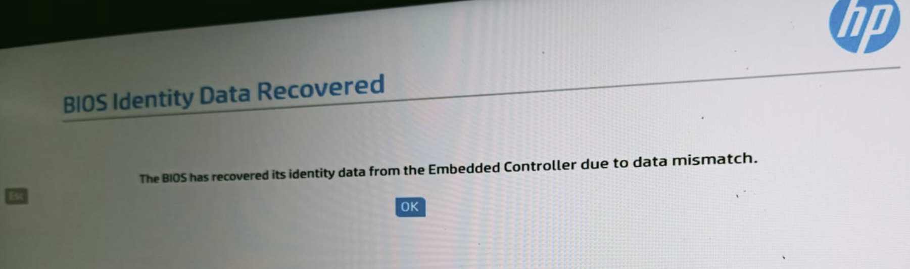

    thankyou so much display ok but show errors on startup
    Need other EC file.

                                      Re: hp 840 g6 6050A3022501-MB-A01
                                      Originally posted by satishkumar View Post
                                      Check and Reply
                                      thankyou so much dear bios working ok but show some errors on startup
                                      plz check attachment
                                        use nbdmifit to close MPM, search for youtube videos how to do it . Most of the red error messages can be dealt with by using nbdmifit/HP Bios Config Utility . You do not need to ask for or flash another bios for those type of messages
                                        https://www.badcaps.net/forum/showpo...43&postcount=5
