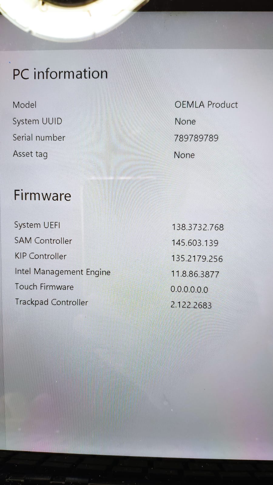

            #45
            Re: surface laptop model 1769
            I have trying a lot of time to dump my BIOS without open my Surface Laptop 2. Finally i opened it and de-solder the chip and read with CH341a mini-programmer.
            I got the file, and look how to remove BIOS/UEFI password. Can someone help me to guess whats the password or clean the file?
            Thanks in advance.

                #47
                Hi Peste,
                After resolder the BIOS and test, when i push power button screen shows microsoft logo and go black, three times, after it auto shut down.
                I´m not sure about it is not well soldered or any problem with the new BIN flashed.
                Any idea?

                  you probably read or wrote the bios with errors.. write back the bios chip with the original content and see what happens..

                    #49
                    After resold it works, but partially. Windows says that model of surface is "OEMLA SKU number i5" and serial number is "123123123".
                    When i download drivers, the setup says that is not for this model and abort the installation.
                    Therefore keyboard and other components does not work. I will try to extract the MSI packet.
                    It is possible to edit the BIOS to change the model? If you explain me i can try.
                    Of course, thanks for your work.

                      #50
                      Finally i could extract the .msi packet and get each folder with the drivers. Install .inf files in each folder, one by one, and ready, all works fine.
                      Really thank you for your help.
                      If its possible, could you explain what exactly modify in .bin file, in order to learn.
