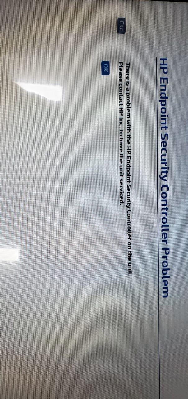

endpoint security message remove

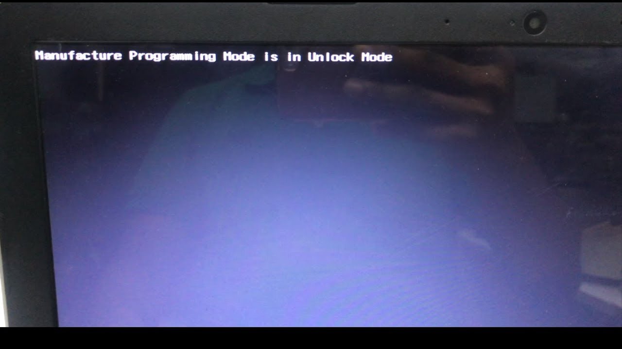

but
manufacturing program is in unlock mode
That's because your "DMI" has been erased, so you need to fill back your device information then lock the MPM using a tool called (BCU).
