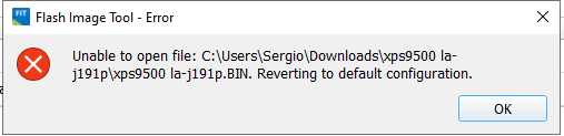

      Re: Need bios Dell XPS 9500 LA-j191p
      I get errors in ME Analyzer:Error: Detected CSE Extension 0x16 with wrong Partition Hash at PMCP > PMCP.man!
      Error: Unknown CSME 14.0 RSA Public Key!
      Error: Invalid CSME 14.0 RSA Signature!
      Error: $FPT partition MFS (0x4F3000 - 0x557000) overlaps with UTOK (0x556000 - 0x558000)
      Error: MFS System Page 1 > Chunk 201 CRC-16 0x15C2 is INVALID, expected 0x595D!
      and more errors similar to the last one. I tried opening the bin file with the corresponding FIT but it won't open it, see pic below. Maybe someone with better skills can help you.
        thank you my dear!
                Originally posted by techman1025
                Sorry here
                many many error with this file
                Error: Unknown RSA Public Key!
                Error: Invalid RSA Signature!
                Error: $FPT partition MFS (0x4F2FF0 - 0x556FF0) overlaps with UTOK (0x555FF0 - 0
                x557FF0)
                Error: MFS Scratch Page 0 Header CRC-8 is INVALID!
                Error: MFS Scratch Page 3348974725 Header CRC-8 is INVALID!
                Error: MFS Scratch Page 2111325258 Header CRC-8 is INVALID!
                Error: MFS Scratch Page 1958274671 Header CRC-8 is INVALID!
                Error: MFS Scratch Page 2854813442 Header CRC-8 is INVALID!
                Error: MFS Scratch Page 2244895950 Header CRC-8 is INVALID!
                Error: MFS Scratch Page 2426910736 Header CRC-8 is INVALID!
                Error: MFS Scratch Page 889204741 Header CRC-8 is INVALID!
                Error: MFS Scratch Page 1703936 Header CRC-8 is INVALID!
                Error: MFS Scratch Page 2613097629 Header CRC-8 is INVALID!
                Error: MFS Scratch Page 3392943676 Header CRC-8 is INVALID!
                Error: Detected CSE Extension 0x16 with wrong Partition Hash at FTPR > FTPR.man!
                Warning: The detected SKU Platform may be unreliable!
                Warning: Data in Engine region padding, possible data corruption!
                Note: This PMC CMP firmware was not found at the database, please report it!
                Note: This CSE ME firmware was not found at the database, please report it!
                  • 20487
                  In my opinion it can`t be fixed ,there`s too many problems with it.Its not imposiible,you`d need another dell bios with the same ME region,boot guard,OEM key and other settings to edit in from another bios dump (it doesn`t have to be the same model).I havn`t seen any xps 15 9500 dumps on free or paid sites.Until one becomes available or one of the members posts one you`re out of luck.
