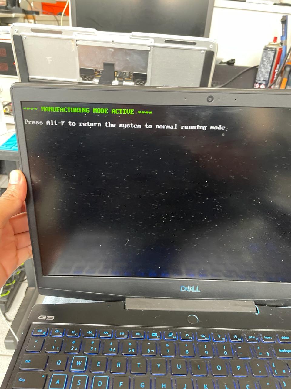

                              #154
                              Originally posted by wilsonjfj
                              Hello. Can you help me? I have the Dell G3 3500 P89F002 notebook. It only shows video the first few times after resetting the bios. But it turns on and the video appears the same as the attached image, the fans are at maximum and when you click to enter the setup it restarts without video and the orange and 7 white LEDs (LCD) blink twice. I switched to the 8mb and 16mb bios from the last post by member "kostukas1985" and it worked but it keeps giving the Service Tag message.
                              My Service Tag is 3JWR8G3
                              Thanks.
                              did you try to add service tag manually from bios setup ? if not than add your service tag in the bios setup problem should resolved
                              if yes and problome remain same than
                              Flash 8MB only from #131​ and use your 16mb old

                                Hello. I added the service tag yes. But the following is happening, when I restart or turn it off and on again, it doesn't show video. 2 orange and 7 white flashes (LCD display). But I already got a new screen and it's still the same thing. To show video again, just reset the bios or force it to turn on and off about 5 or 7 times until it shows video. But if you turn it off or restart it, it has no image and the LEDs blink like I said.
                                Can you tell me what it could be?
                                Thanks​

                                    Hello, help motherboard: selek g3 mlk n18p 19795-1 when connecting, only the keyboard backlight turns on and it restarts. That's all it does without an image, without fans, it just cycles through the reboot, turning only the keyboard backlight on and off.
                                    CPQK463 service tag​

                                      #158
                                      Hello try this new file ...
                                      • lalodbs
                                        • Oct 2017
                                        • 12
                                        • mexico
                                        #159
                                        thank you so much. but it didn't work for me, it has the same error
