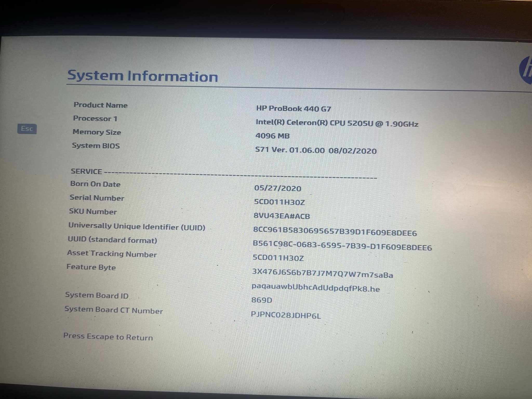

      Hello
      DA0X8MMB6D0 Quanta X8M-6L
      serial number 5CD011H30Z
      SKU NUMBER 8VU43EA#ACB
      HP Endpoint Security Controller Problem need clear
