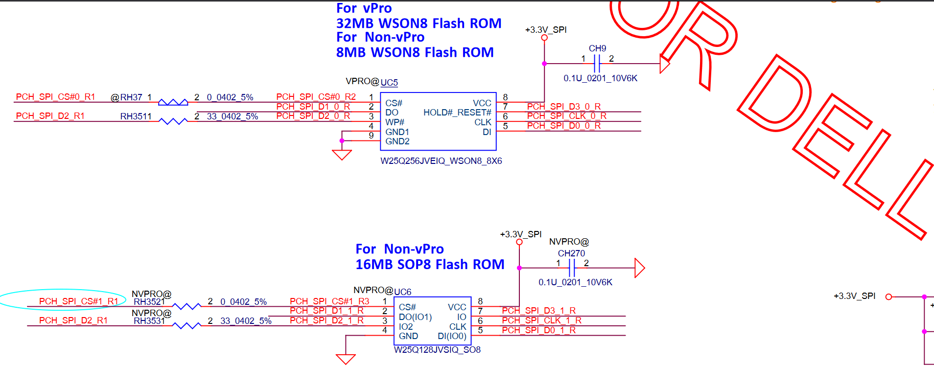

    Please help me clear the password on this BIOS. The Laptop is Dell Latitude 5401, I used CH341a to extract images from UT6 and UT2 which were the BIOS chips that I identified on the boards using the schematics.
    I needed to use this method since I was unable to boot any device with the computer. The BIOS dumps and part numbers are included in the attached rar file. The other BIOS files that I see on this page are typically much larger, perhaps I need to extract it in a different manner, but each 8Mbit device is 1MByte, so the math checks out.
    • Vesko356
      VIP Moderator
      • Aug 2018
      • 4386
      • Bulgaria 🇧🇬
      Re: Dell latitude 5401 bios password
      "Do not touch the 25Q80xxxx chip"
      Dump the chip labeled UC5 (32MB or 8MB).
      Look again at the schematic:

        Please unlock the bios thanks for the pointers.

          Here you are:

                            The password is on the 8MB chip, not the 16MB chip.
