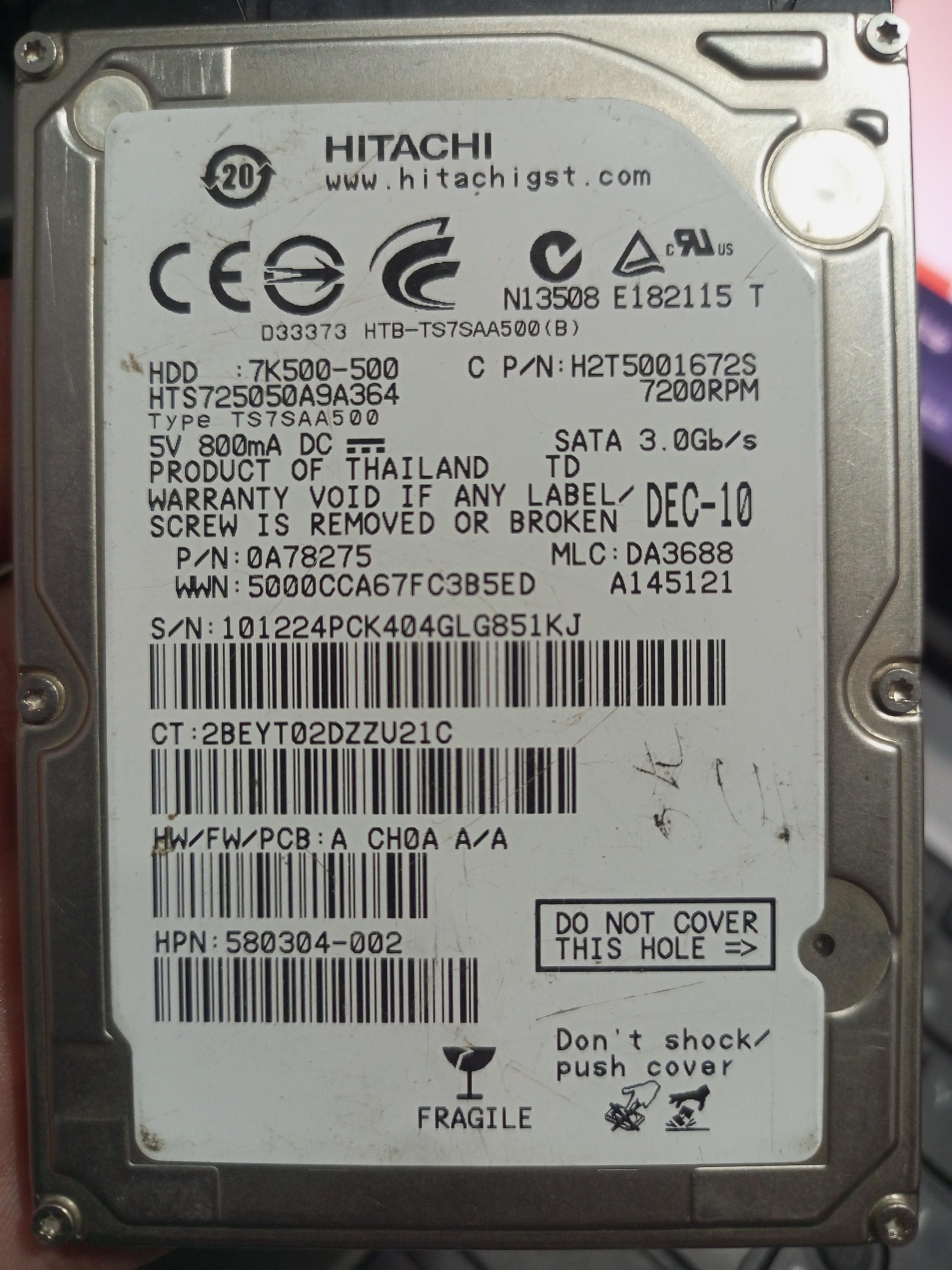

thats great sir........ i have read and copy a bin file from hitachi hdd efrom...this hdd have a password...can you findout its password by reading the bin file?
@smali
The older the hard drive, the better possibility you have to recover/clear its password.
Look for HDD specialized forums like hddguru, hddoracle, other.
Many questions:
- How old is the hard drive?
- Was this hard drive installed in a laptop that uses a master password recovery algorithm?
- Look for hard drive label, it will give an idea if it was installed/locked in a Dell, HP, Lenovo or other manufacturer laptop.
Unless you have something very important you want to recover from this hdd it will be worth, otherwise look for a replacement.
Passwords are stored in the HDD platter.
By taking a look at the file you uploaded seems to be from around 2008, HTS7250xxA9A300 model.
There's a ZU (Zung Unlocker) utility, give it a try, by the age of the HDD you may get lucky with it.

Tried zu unlocker... Couldn't succeed. I am sending picture of the label of hdd... Please do something with the bin file.
