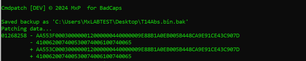

        Hello, Can somebody help me remove Absolute Persistence from this bios.
        Lenovo Thinkpad T14 Gen1 i7
        Serial Number: PF-22ABKR
        Type Number: 20S0-002VUS
        Motherboard Number: GT4A0/GT5A1/GP4A0/GT4A2 NM-C931 REV: 1
        Thanks in advance!​
        • Carrie Takamiya
          • Nov 2024
          • 2
          #205
          Hello, Found how to remove abtstate on the laptop by checking on the p53 post that was shared. Here is what i changed to remove that.
          Thanks for the helpful posts!
            Thanks in advance!
            Click image for larger version  Name:	image.png Views:	0 Size:	8.9 KB ID:	3579326
            not sure that the PC will restart with this generation.
            you have to try
            edit : I didn't see that you responded to the post yourself​
                  It also worked on T14 gen 1 AMD NM-C801.
                  Thanks!
