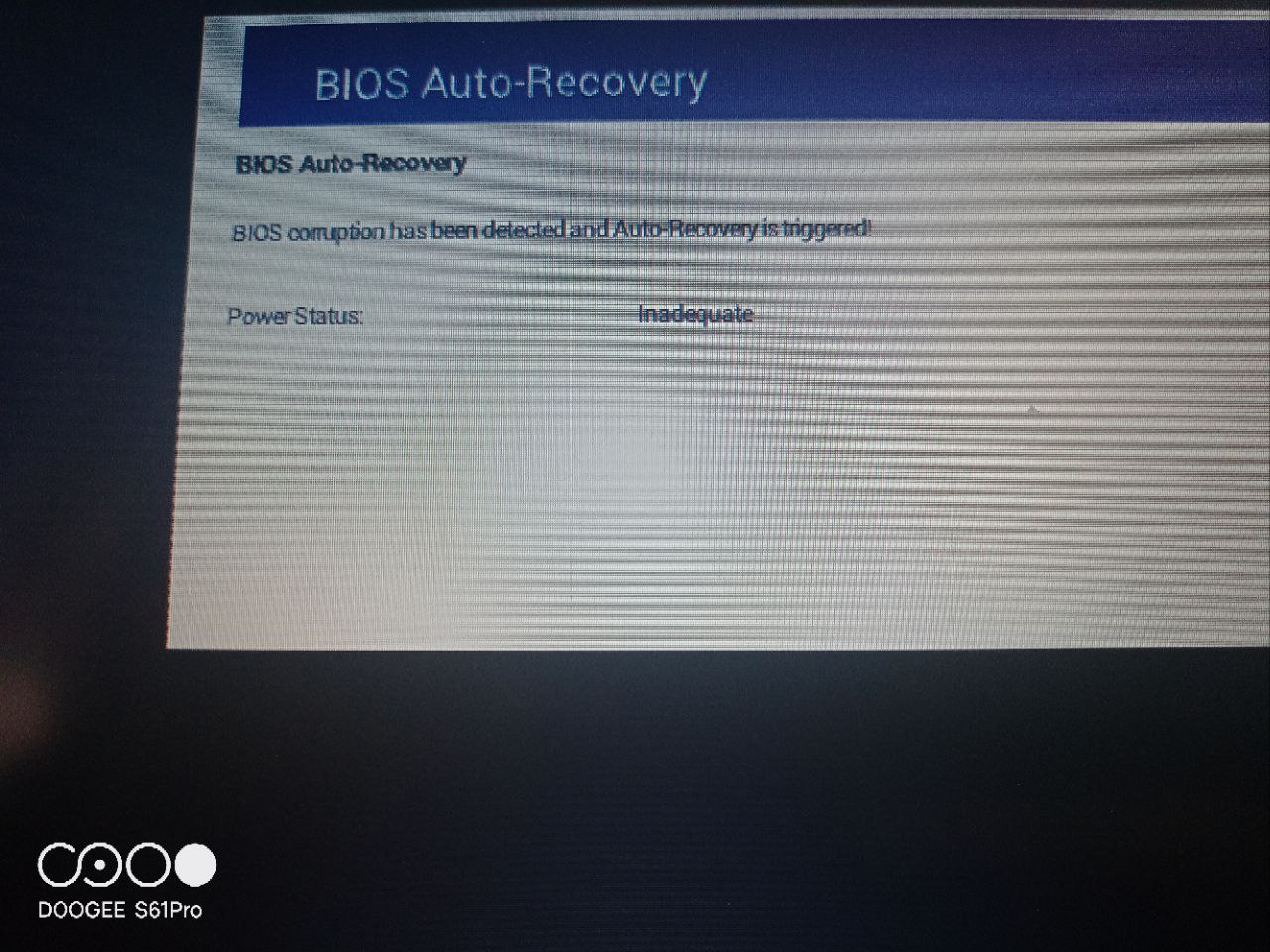

                        Re: Need bios dell latitude 3410 plz
                        not worked rnter in bios auto recovery
                          now with download or original bios
