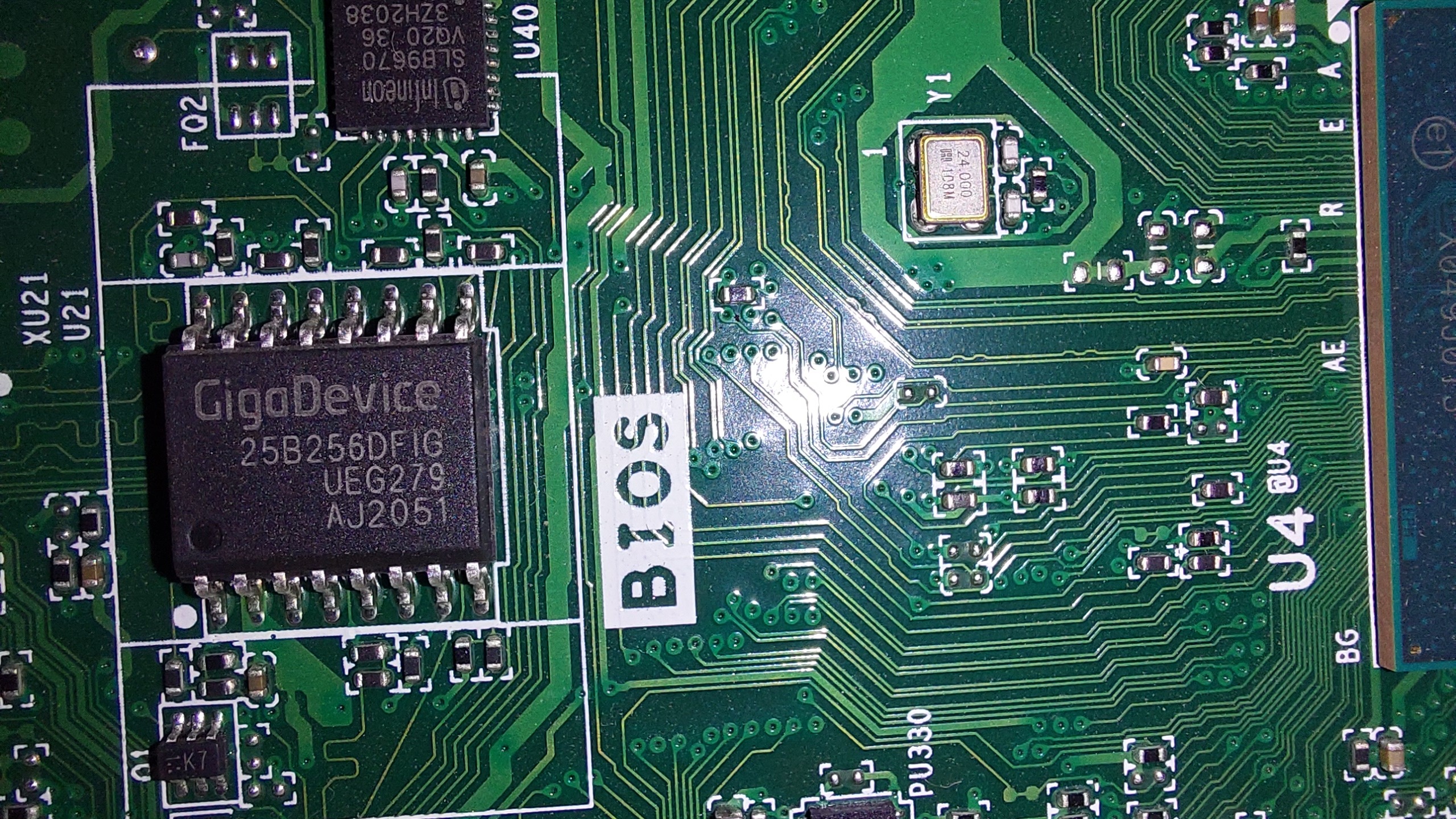

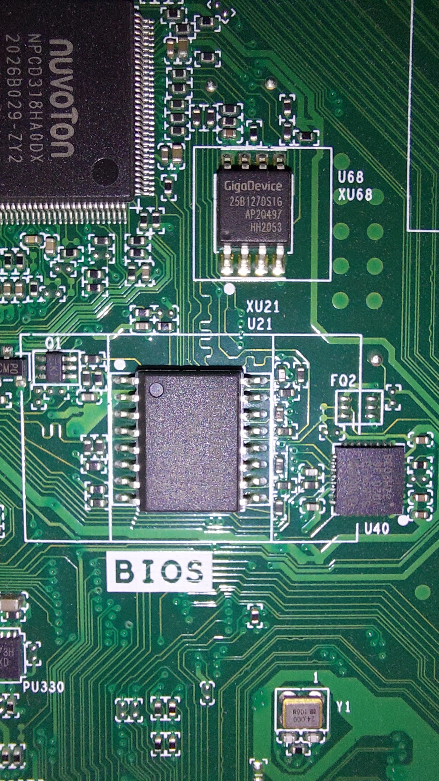

    I have 3 Elitedesk 800 G6 SFF PC with password locked BIOS.
    Product Number (same for all 3): 8YM57AV
    Serial Numbers: CZC1239T57
    CZC1239T5L
    CZC1239T3X
    The boards are all the same revision (Cersei Rev A)
    There are two chips near the BIOS markings (Images Attached):
    8 pin Giga Device 25B127DSIG
    16 pin 25B256DFIG
    I have a programmer on order, it only has 8 pin test leads.
    Can you confirm the 8 pin 25B127DSIG is the chip of interest to RCUnlocker and that the tool works with this model of computer?
    Thank you.

                #1187
                16 pin 25B256DFIG
                My CH341A arrived. After modding it to 3.3v I have successfully removed the bios password for my first system with RCUnlocker and NEO Programmer. I can confirm the 8 Pin 25B127DSIG is the correct chip to flash.
                Here are some notes if anyone else is a novice like me:
                1: For this model RCUnlocker just displayed "Unlock Success"
                2: I used the GD25Q127C profile in NEO Programmer as there isn't one for the chip.
                3: In NEO-Programmer I had to select all 5 options for write IC - Off-protect, Erase, Blank Check, Write, Verify. Without this selected it would not write.

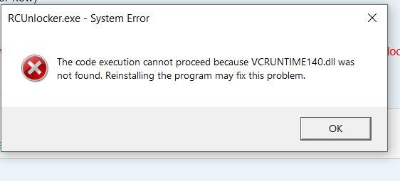

                                #1195
                                I tryed to unlock my HP Zbook 15 G3 and i received this error. I Download the vcruntime140 dll and put on the app folder, but wan't want to start. could you please help me what I need tot do to can start the app?
                                • azanwaqas771

                                    • 21841
                                    #1197
                                    Get dll files from the official microsoft installers. https://www.badcaps.net/forum/troubl...88#post1655388 ,install the 32 and 64 bit versions

                                    • Stanciu Mihai
                                      • Jan 2025
                                      • 3
                                      • Romania
                                      #1198
                                      It worked after I installed both versions.
