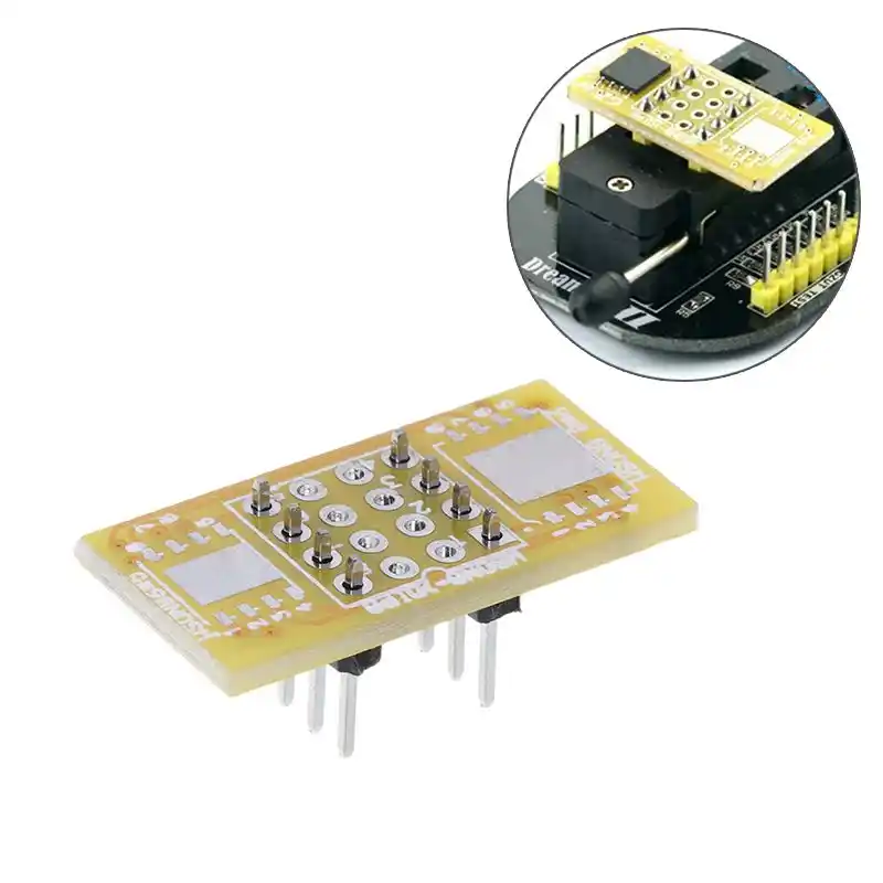

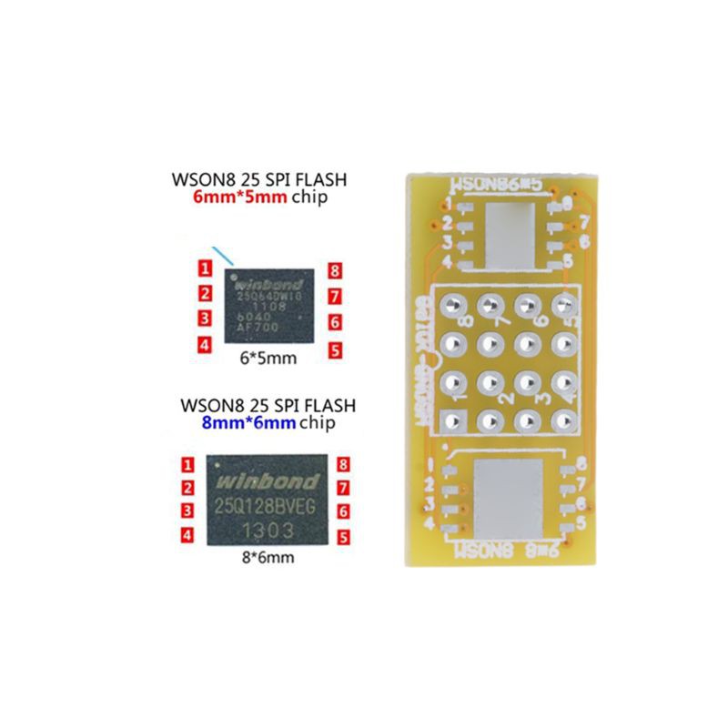

          It is a WSON8 chip (without legs) . The gold pads surrounding it are for a sop8 chip (with legs). The pads are offset and not in a straight line.You can solder wires to the gold pads if you can`t desolder it, as mentioned already,or you could buy a WSON8 pogo pin test probe
          https://www.aliexpress.com/item/1005001830846980.html .There`s 2 different sizes for each of the WSON8 chip sizes, 6X5 and 8X6

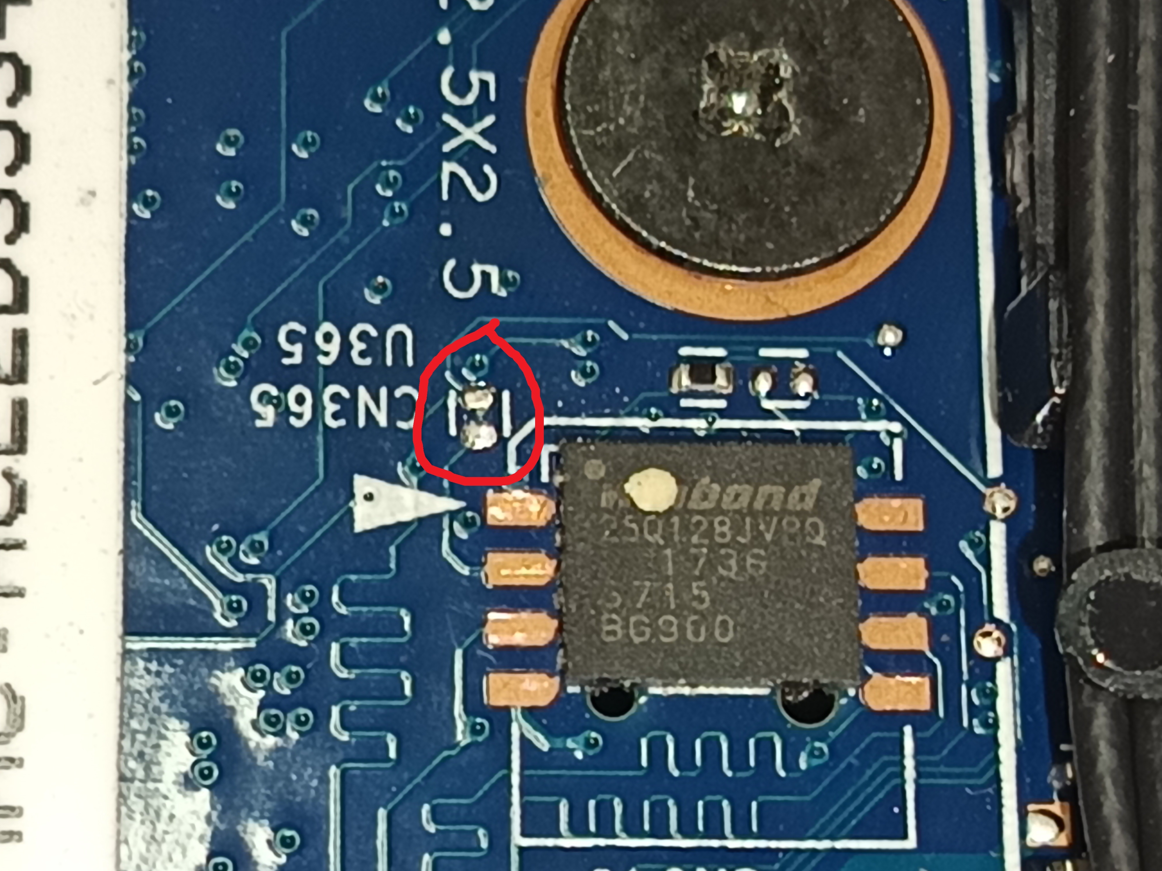

                          Hello everyone. I was also trying to flash the BIOS with the clip connected directly to the motherboard, but as expected, NeoProgrammer did not detect it.
                          At a certain point the clip slipped, and it seemed to me that something might have popped off the motherboard.
                          When I tried to power on the laptop, it no longer turned on. Only the lights blink intermittently between yellow and white.
                          After checking, it looks like there should be a capacitor near the BIOS chip (see photo). Could it really be a missing capacitor? If so, which capacitor is it?
                          I also forgot to disconnect the CMOS battery—could that have caused an issue?

                            I think it's a resistor...try between 35 ohms -50 ohms..

                              Thanks, peste. Do you think it’s dangerous to put a wire and make a bridge instead of the resistor (which I don’t have) just to see if the laptop powers on?

                                Do you have it from an old board? Don't you have a friend who can help you with a resistor? Go to a workshop and ask for an old board of any model you can find there.

                                  Hi peste, I connected it with a higher resistance and managed to turn on the laptop. Now I need to see if I can find a resistor that can be adapted.
