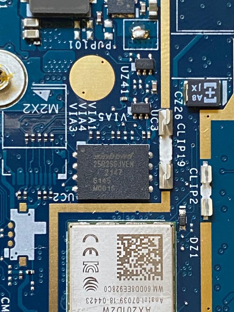

                    Now laptop has no video , no fan , only the power key lit, and blinking slow from time to time .Have i done something wrong? the bios version before i read the ic was shown as 1.6.0
                      Re: Pass 7420
                      can you send a high quality picture of the bios soldered on the board to see if all the components are there.

                          Ok, the components look good, you just blew a can of fastening, if you have not damaged anything serious, it should turn on with the original bin, did you reprogram your bios with the original firmware? soldering is ok?
                            Re: Pass 7420
                            Reprogramed with original bios , no power only power led in the keyboard îs on but nothing else . Reprogramed with a Random bios from this thread and the laptop turns on with maxim fan speed, and after couple of restarts begins a LCD test color and a power led in the side of the laptop blinking 3 Orange 6 white , indicating a corrupted
                            Bios error code . My programmer is a ch341 and the bin s read after write are always identical. Can you help me understand this probleme that i have ?

                                Re: Pass 7420
                                OMG, OMG it worked . thank you man . Can i ask what was wrong? I think i flashed over 20 dump files !!!
                                Thank you very much hoaca388!!!!
