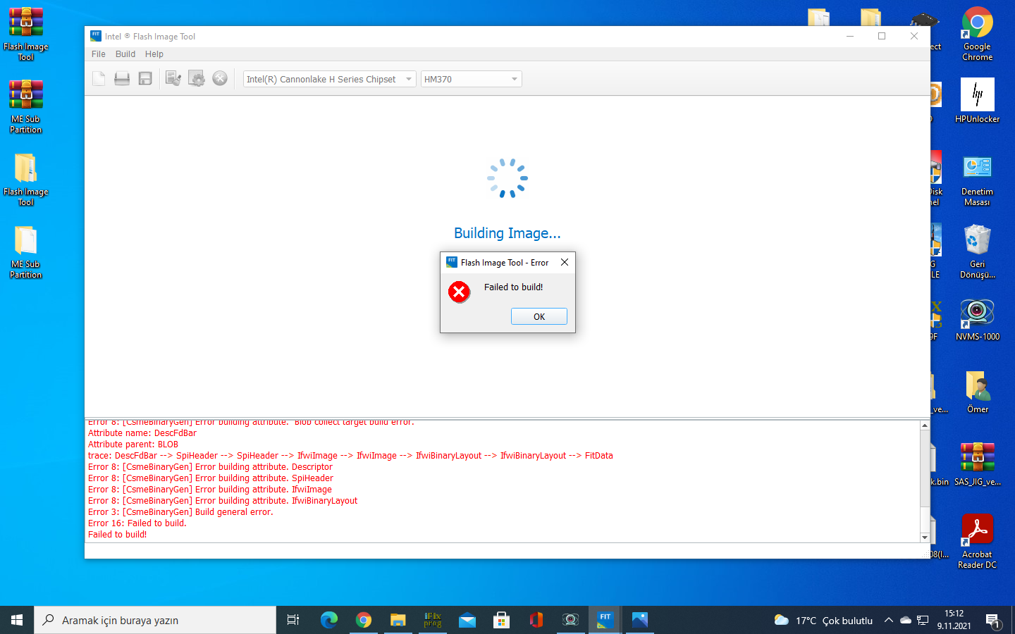

          why this error?
            Re: Need monster tulpar T5 V17.1 Bios
            Originally posted by bilen View Post
            why this error?
            You`ve done something wrong. Watch this video,starting from 2 minutes - https://www.badcaps.net/forum/attach...8&d=1599664171 .The method is exactly the same,except the firmware in the video is named ME Region.bin ,and yours is named ME Sub Partition.bin

                After you have made a mistake with FIT its best to delete the Flash Image Tool folder and use another untouched Flash Image tool, or go into the FIT folder and delete the fit.log,outimage.map and any xml files ,leaving only fit.exe and vsccommn.bin ,then start over again.

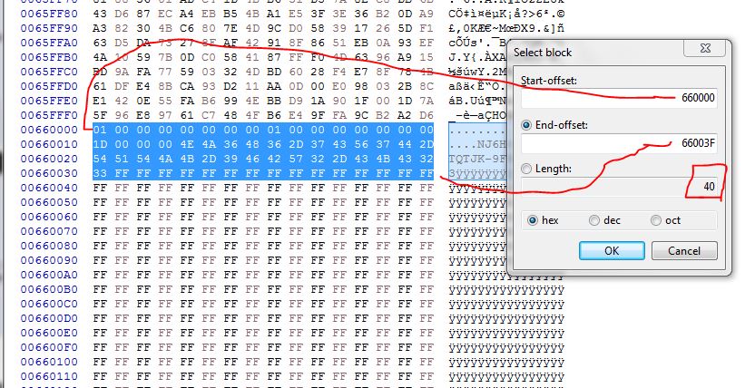

                        The bios at posts 8 and 9 both have clean ME firmware,you can use either of them. If you want to use the original win key you can copy it from your backup to the new one using a hex editor with the off-sets in the picture. HxD has a tukish language version
                        https://mh-nexus.de/en/downloads.php?product=HxD20
