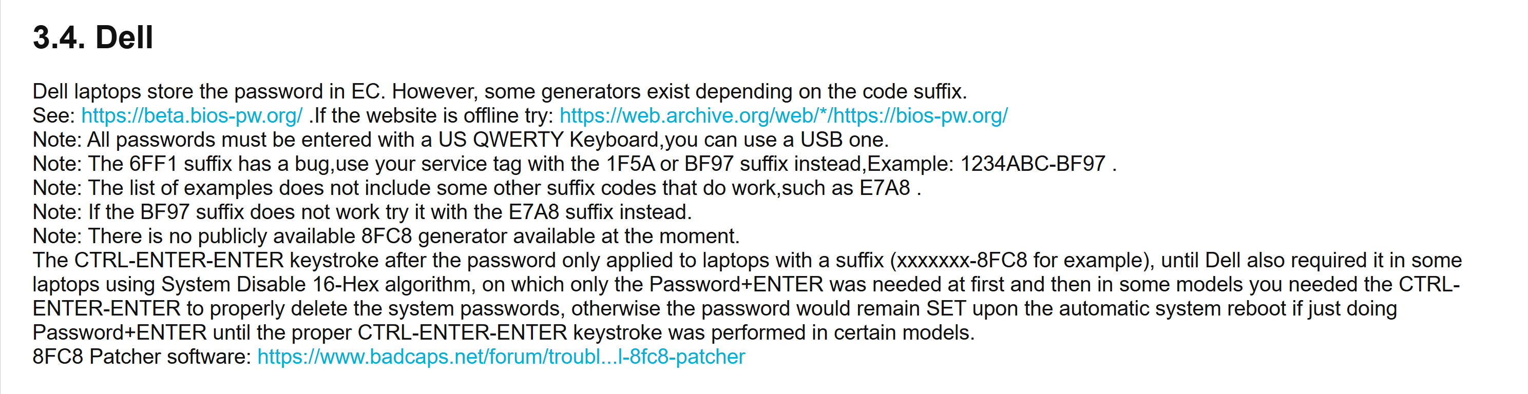

      Try these Passwords one by one.
      First Password: D9zJ12Q22FRNI33X
      Second Password: DQN1BsRxJL4rXRpz
      Use an external US Keyboard (QWERTY), use Shift Key for Uppercase Letters, hold CTRL Key then Press ENTER Key twice.​

        You are the best!!!!!!!!!!!!!! I really do appreciate. You surely don't know how happy I am.
        It worked. I didn't even need to try it twice. . what can I do afterwards?. The main reason I even bumped on it was because I was trying to install windows 11 which keeps giving me an error code.
        Is it okay if I restore my BIOS
        I know it's too much to ask🙏🙏🥺🥺. But I sincerely need help

            https://bios-pw.org/
