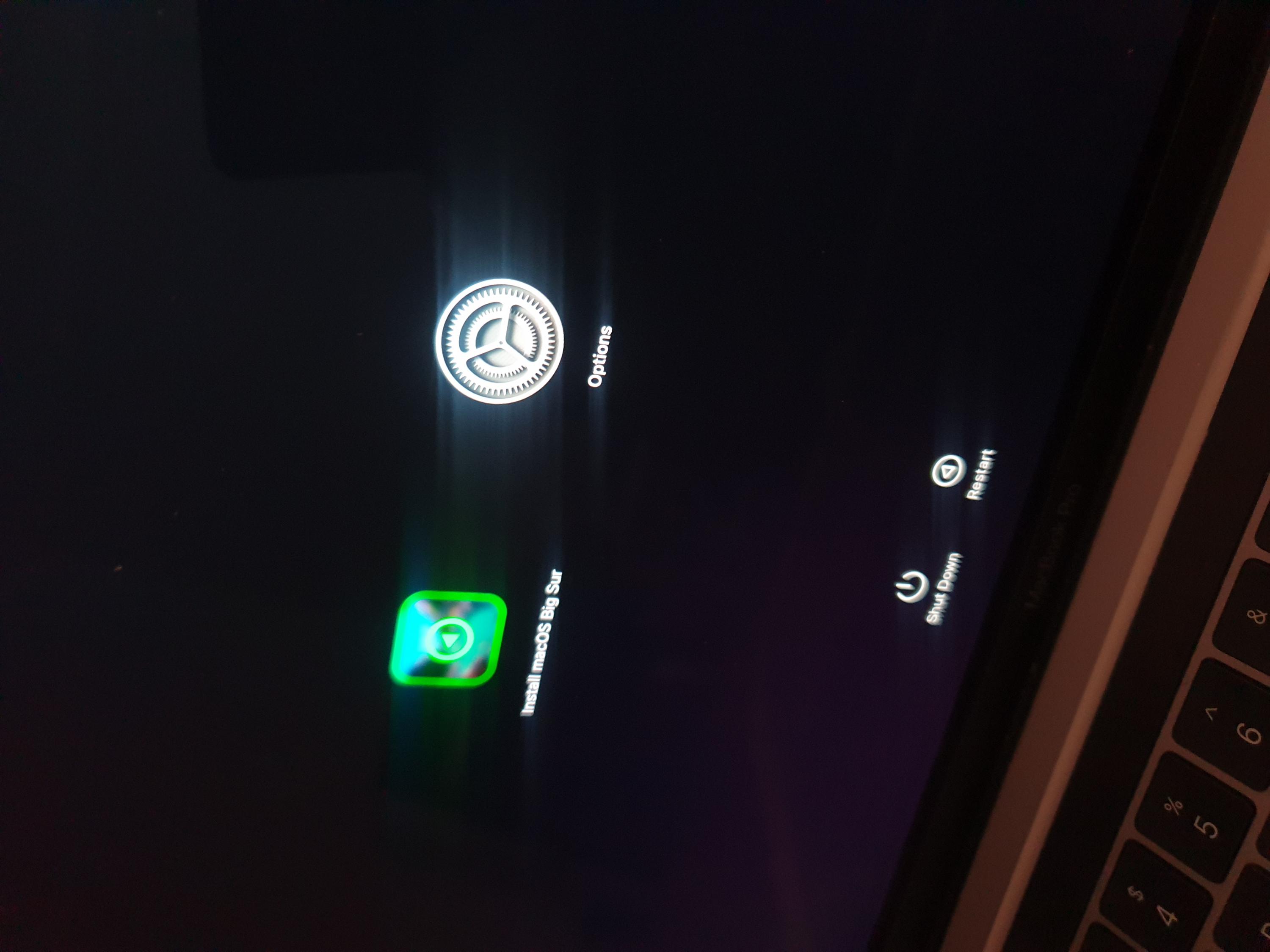

I have tried M1.bin and M2.bin, MBP did not start, it entered dfu mode and did restore with appleconfigurator2, which updated iBoot-7429.81.3. Now it starts but nothing has changed (SN/Activation Lock is still the same - can check SN in diagnostics mode). If I put old dump which was working before with iBoot-6723.50.2 will power on then restart, cycle all over again.
Data we need might be in ssd NAND, but I think secureboot bits are set in SOC bios rom. We need an easier way to access NAND sysconfig area.
