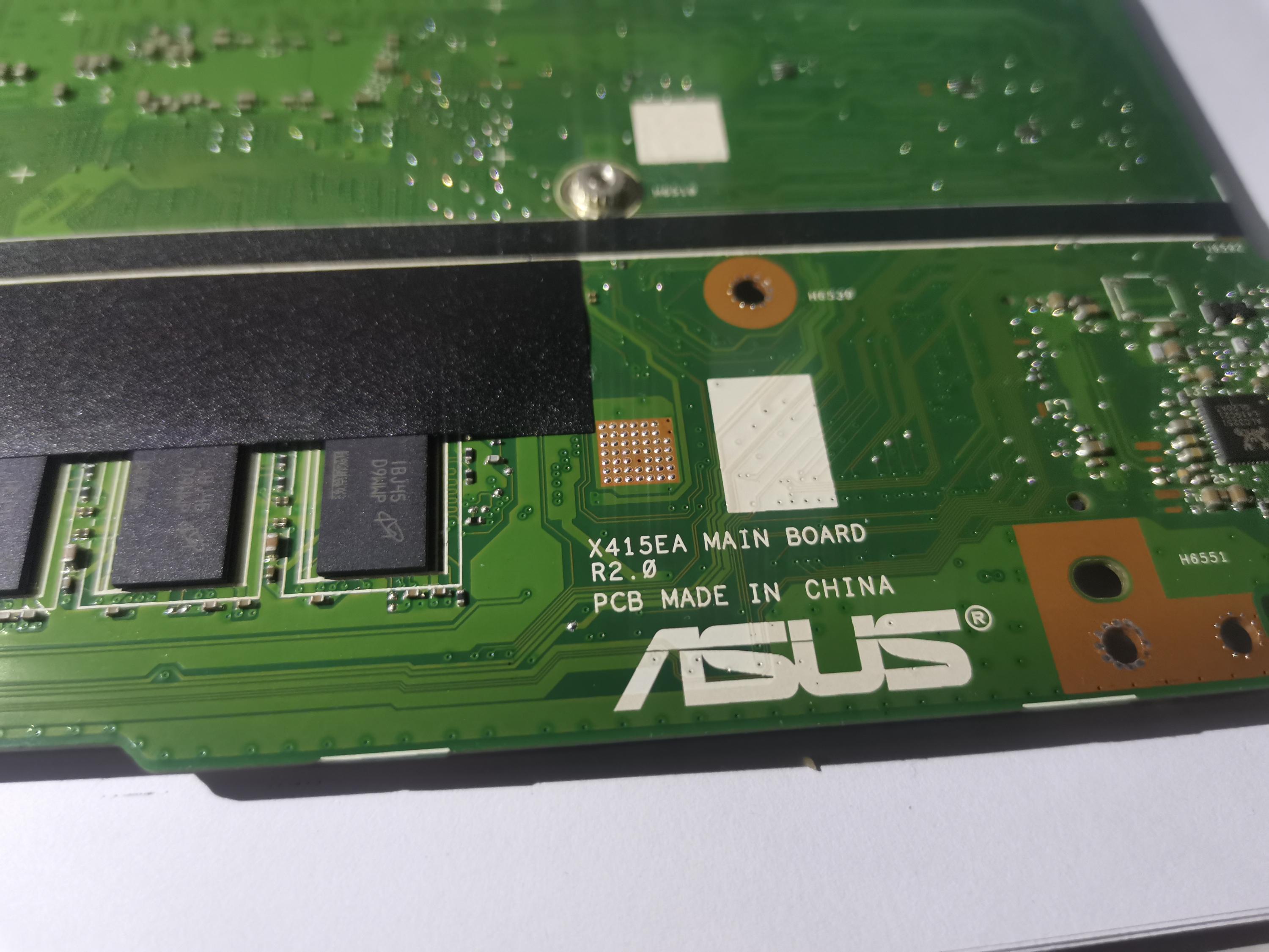

    Hi everyone. I've got a laptop that was brought to me with water damage. Board is beyond repair coz of the burnt marks that penetrated the pcb.
    The owner bought a replacement motherboard online but he did not notice that there is no bios chip on it. I try to salvage bios chip from the damaged board but two of my programmers were unable to read and extract data from it.
    I ordered chip and will arrive tomorrow. Does anyone have a bios dump on this one? Motherboard code is X415EA R2.0, laptop model is Asus X415 core i3 version. chip model is gd25b127d. Hope someone has. Thanks

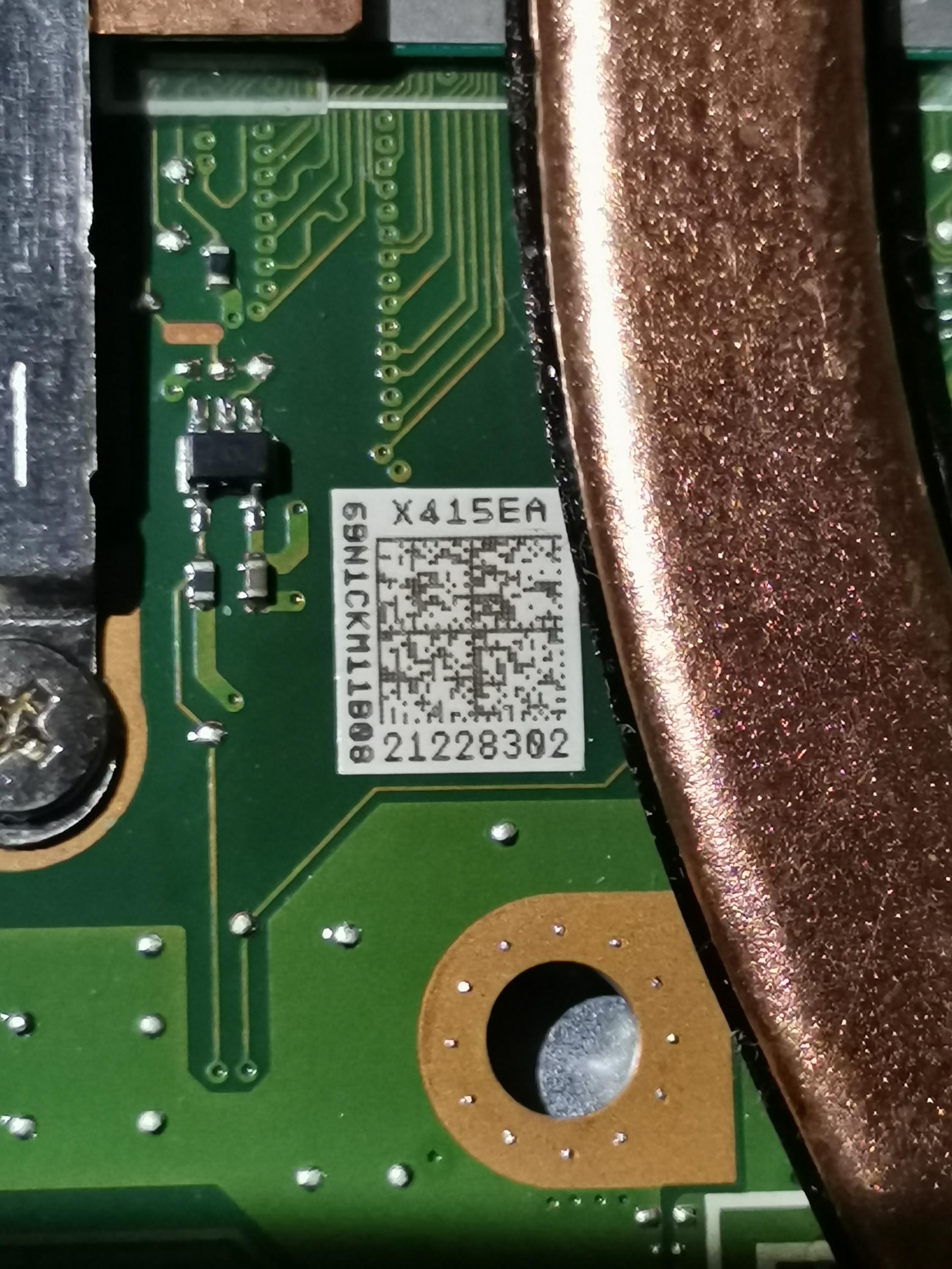

    What model is your programmer.Are both boards exactly the same.Are there any barcode stickers near the ram slots,or square white QR codes on the motherboard
      Re: Asus X415 bios file needed
      I got TL866II Plus and RT809F. And yes they are identical.
        There is no QR code i can find. I attached motherboard image

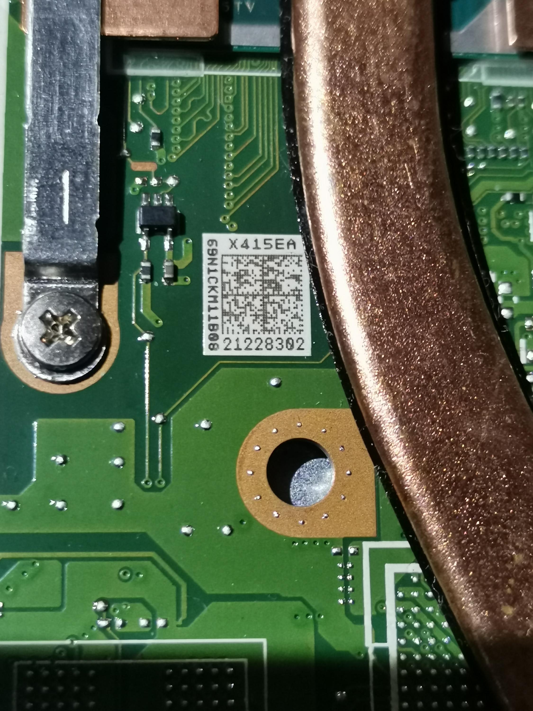

                      Can you check for a QR code under the wifi card
                        Hi, there is no qr code under the wifi card. As for the whole board, this is the only one i found though it doesnt point me to any website. There are qr codes on other components such as speaker, battery pack and the casing itself.

                            The QR code,and barcode on other boards identify which bios the board has https://www.badcaps.net/forum/showthread.php?t=96604 . So,now you found the QR we know you need a X415EA working bios
