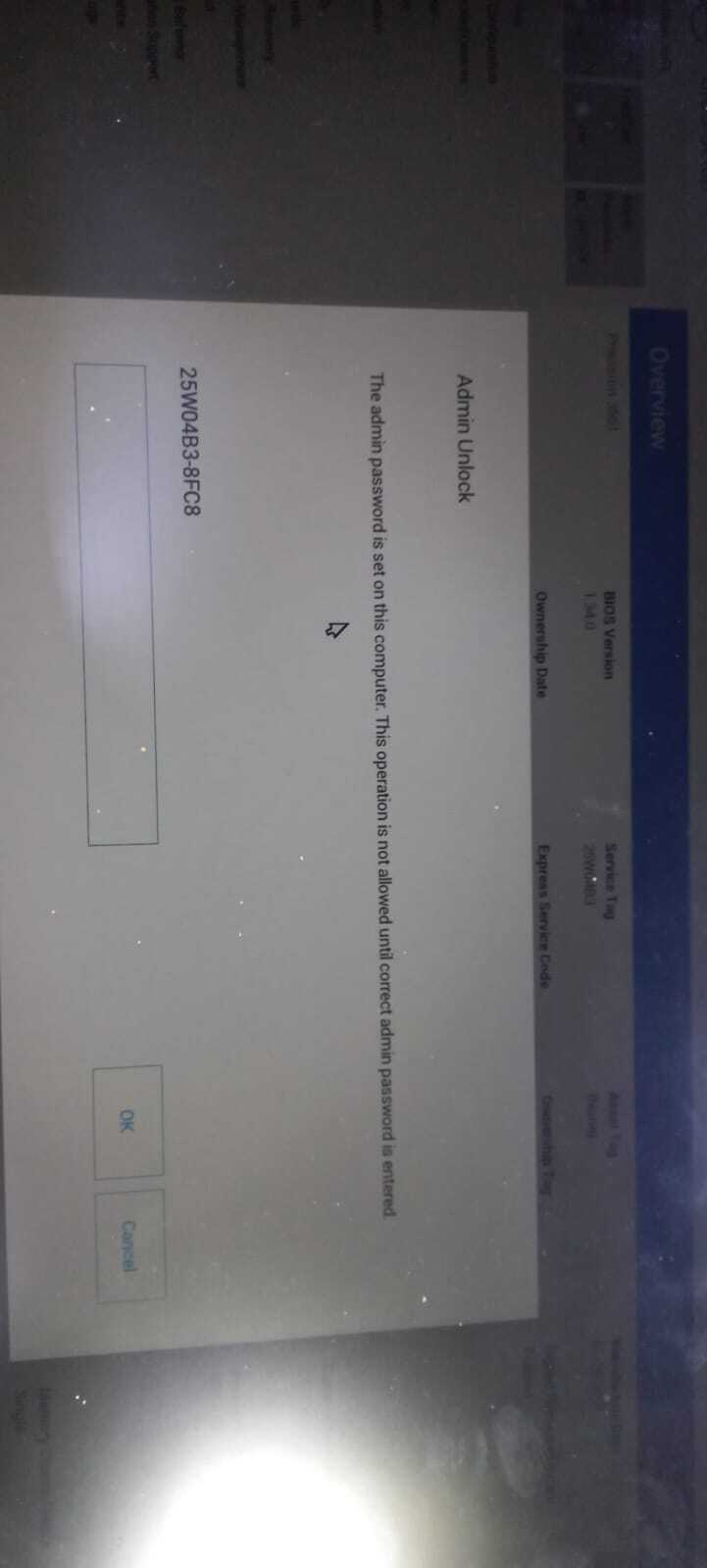

                            i have problem on bios i cant modified
                            Model-Precision 3561
                            ST/25W04B3
                            MODEL MOTHERBOARD-BROADMOOR 15 TGL-H 12L 203061-1
                              PASSWORD
                                ST/25W04B3
                                try and feedback
                                  thank you so much LBTT121 its working prefect
