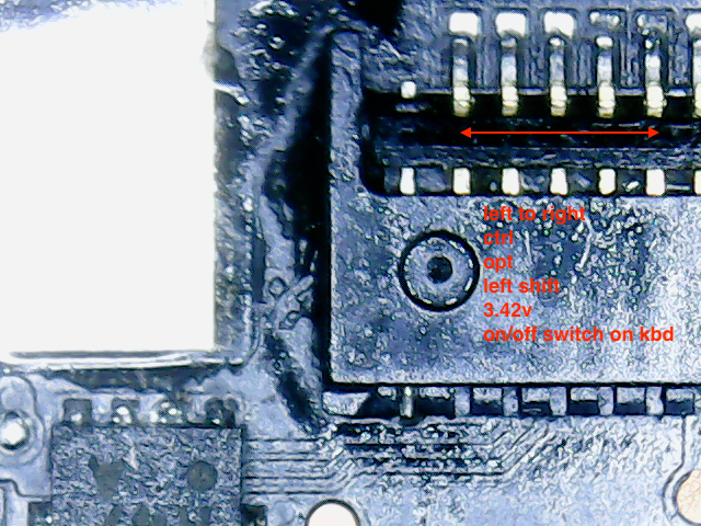

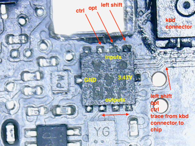

          liquid spilled 2013 A1466 with a left shift key stuck pressed. Used audiomodder's inspiration and found a key probe point on the trackpad to determine if fault was trackpad board or kbd. Turns out it was kbd.
          Easiest test would have been a known good trackpad (easy to replace+test). But not available in my case (initially, eventually got hold of one to confirm diagnostic result) and probably not available for most people who don't have a shop or multiple of the same models around.
          As audiomodder showed, left shfit, opt, and ctrl keys are special. They trigger SMC reset at boot. Therefore have dedicated lines rather than a column/row matrix like most keys. On the 2013 A1466, the SMC manual reset isolation logic is integrated into a single 11 pin chip on the trackpad module. This 11 pin integrated chip seems common for this era. A1502 has the chip on logic board. Thus boardview and schematics provide clear diagnostic trace points.
          Attached is a part of the 13 A1466 trackpad. I've labeled this 11pin (1 pin in center hidden from view) chip according to A1502 schematic counterpart. Pin 1 (left shift) is the probe point to see the left shift key voltage both pressed (3.42v) and unpressed (0v pulled down presumably by chip internal resistor) In my case, unpressed shows a range between 1.2 to 2.8v indicating a short to the 3.42v supply in the keyboard. When known good 2nd trackpad became available, this result was confirmed. A couple of pics are attached for reference.
          BTW, googling showed a lot of stuck pressed left shift key problems on Macbooks. Perhaps the reason is it is right next to the 3.42v line on the keyboard flex/connector layout. Corrosion from moisture would cause current to flow from 3.42v line to left shift line signaling its being pressed. Any liquid spill on the keyboard likely trap moisture inside above the black protective plastic. Trackpad also sits above the flat battery offering another source of sitting moisture for corrosion.
          Anyway, thanks to audiomodder (and originally Louis Rossman of course) for the inspiration.
