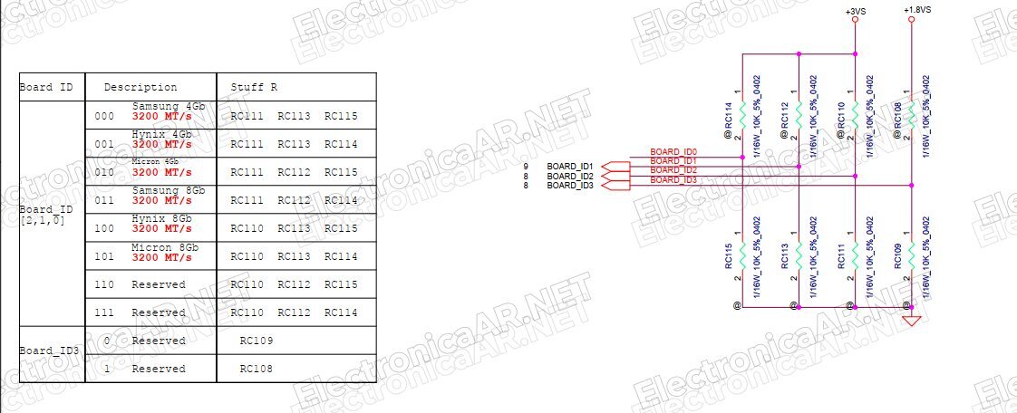

    Hi all. i have One of these Lenovo thinkpad E14 laptops that come with a ryzen cpu, but memtest gives thousands of errors. Because of this it's imposible to install Windows as install fails.
    Sadly Lenovo built it with ram soldered to motherboard + 1 empty sodimm slot for ram expansion.
    So I'm curious of what can be done with it, perhaps with boardview there are tips on how to disable onboard ram, wich would be great , i could install a sodimm ram and bypass the soldered ram.
    Another thing that could be done is to patch bios, but i have no idea on that.

Name:	Memory straps NM-C771.jpg
            Successfully disabled built-in memory, Set first 3 Board_ID to 111

              Hello, i have an E15 Lenovo with bad onboard memory and the boards look like almost the same.
              Can you please explain what you mean by change board id to 111 ?
              I have already removed soldered ram and try to figure out the next step.
              Also resistors on the board they are not labeled so if you could show me some photos or explain what i have to change i would appreciate it.
              Check boardviewer file, to set ID 111, move resistor RC111 to RC110, RC113 to RC112, RC115 to RC114. If isn't already, in my case RC110 was already there.
