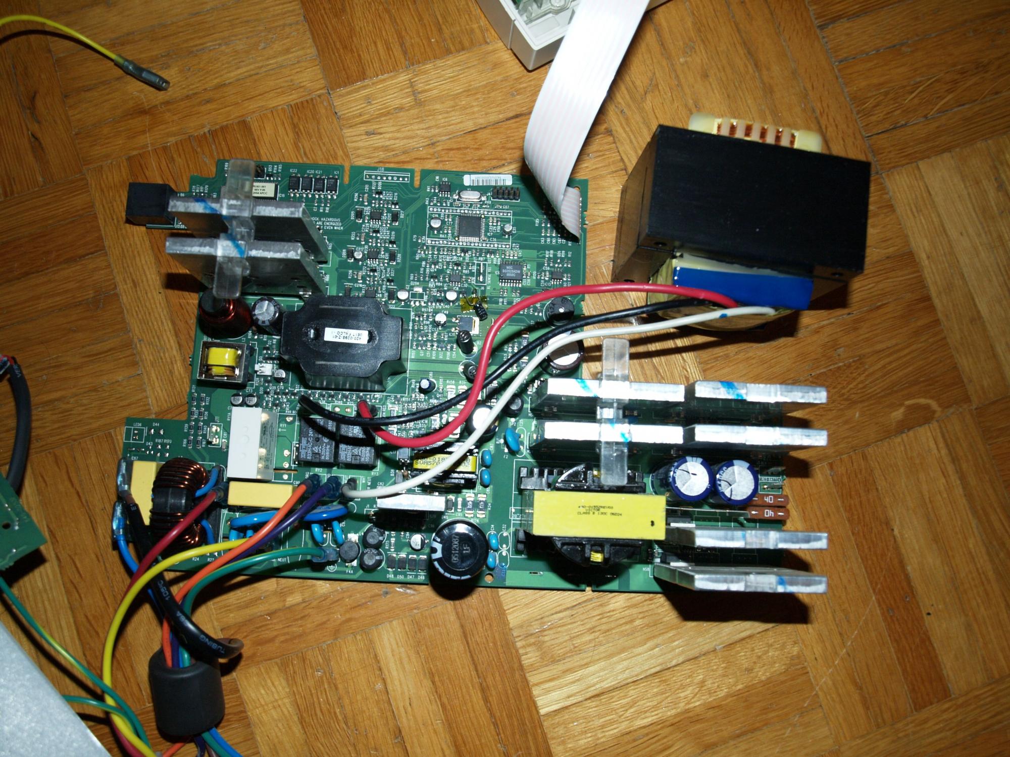

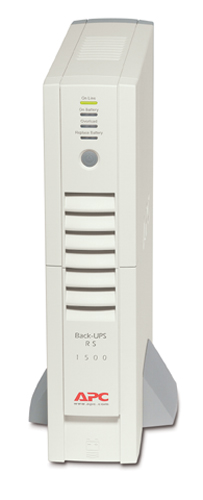

    Hello to all! I just got the ups shown in the title, with dead batteries. To test it, i put a volt meter and saw that it can charge batteries with no problem (gives 27v), so i bought two identical CSB batteries and waited. The batteries have gone up to 28.8V (normal value), however the ups is completly dead. Caps do not show any sign of damage nor the rest board. Without the battery it won't even buzz as it mentions in its manual.
    Any suggestions on where to begin? Ty!

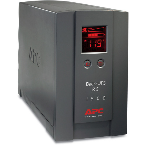

      Which one? APC shows 2 -completely- different RS 1500's. One tall & thin with LED's as indicators. The other has a screen and digital display showing voltage, load, and battery charge.
      Display is dead yet it's charging?? Sounds like the power supply to the brain or a fuse. Not familiar with these units. Can we see some pictures of the board(s) and wiring?

        Re: APC Back-ups RS 1500 Dead

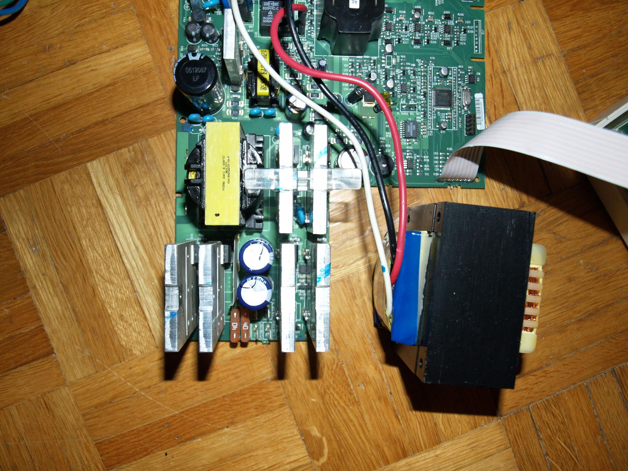

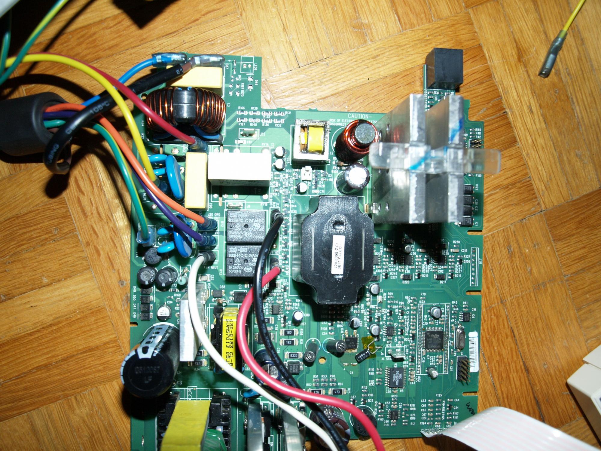

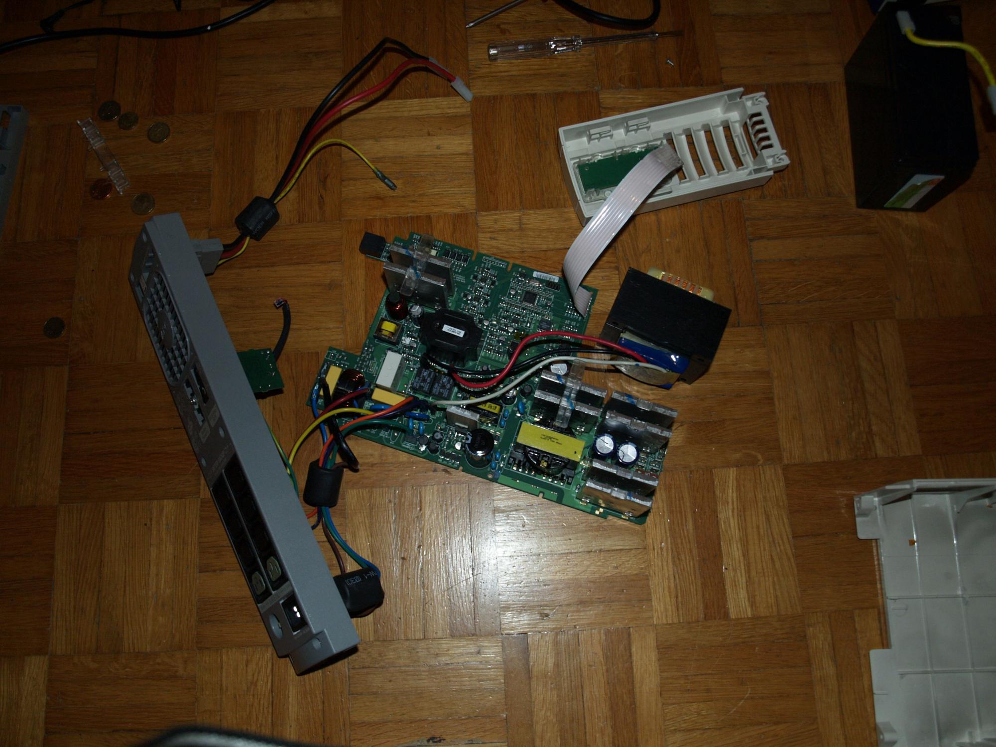

        It is the tall and thin one! Here are the photos

          Please check continuity across both 40A (car) fuses.

            Completely dead - no indicators at all, correct?
            Also, make sure the batteries are wired together correctly.

              Oh i am sorry i must mixed the links. Thanks a lot for re uploading them! I have already checked the fuses, and also the diodes arrount the charging circuit seems to be fine.

                Check that ribbon cable from the main board to the front panel. Sometimes they can get pinched or flexed too much and break a wire. Disconnect the batteries and AC and check their continuity with an ohmmeter.

                  Hello again! I read the manual and did everything as mentioned. The ups still does nothing. It won't get into programming mode. I have tried it many times but nothing happens. The circuit breaker is ok so is the ribbon cable. As for the charging circuit, it's working ok too.

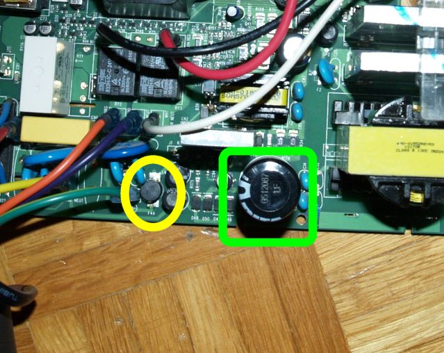

                    Check the black cylindrical device I have circled in the picture for continuity. It appears to be a fuse marked F4A. If it's open, we'll need to find out why.
                    If fuse is good, it's time for some Live voltage measurements - Reconnect everything. Remember that there is mains potential on the board and not to touch anything on the board while the unit is plugged in -AND ALSO- if the batteries are connected.
                    Flip the board over and measure the voltage across the capacitor circled in green. Take note to set your meter to DC and the voltage scale to one that includes the voltage marked on the cap -or higher-. Negative (black) lead goes to the post marked with the stripe on the body of the cap.
                    Report what you find please.

                          The fuse is fine and the capacitor measures ~300v

                            That is good. You'll have to continue working through the circuit to find where there is a loss of power. Without the board to hand, it is very difficult for me to walk through the circuit. You'll have to identify components to see what they do. Also, some of the IC's are proprietary to APC so there will be little to no information on them.
                            All of the little silver can caps are opportunities to measure voltage as they are surface mounted. Be careful not to short against the metal can with your probes while measuring. All the other sleeved caps will need to be done from the underside. If there is a missing voltage, these are the best way to get into the general area. Refinement can come later.

                              Do you have this ups? Can i give you some pictures to ask you to measure the current there?
                              The white Rely (at the A/C part next to the 2 black ones) is the component i can't understand whether it is good or not. Here is its datasheet http://pdf1.alldatasheet.com/datashe...68-24-2CE.html
                              This one is the 8 contact version.
                              From the downside it looks like ths
                              1 2 3 4
                              5 6 7 8
                              (there is a huge space between 3 - 4 and 7 - 8 but it won't show in the forum)
                              The 4 and 8 pins are the 700Ohm DC coil, which meters ok.
                              The 1 and 5 pins are the A/C input pins.
                              The 2-6 and 3-7 from what i understand output 230v when there is 25v on the 4-8 pins.
                              4-8 pins point ~25v when connected to ground individually (4 & gnd / 8 & gnd).
                              1 and 5 when tested together point 230v, which is ok.
                              2-6 and 3-7 are dead. BUT! When they are individually tested with Phase or Neutural, they produce about 110v.
                              So either i need to refresh my psu testing skills or this relay seems bad to me.

                                Relay is DPDT type. Readings are fine.
                                Voltages checked on can caps?
