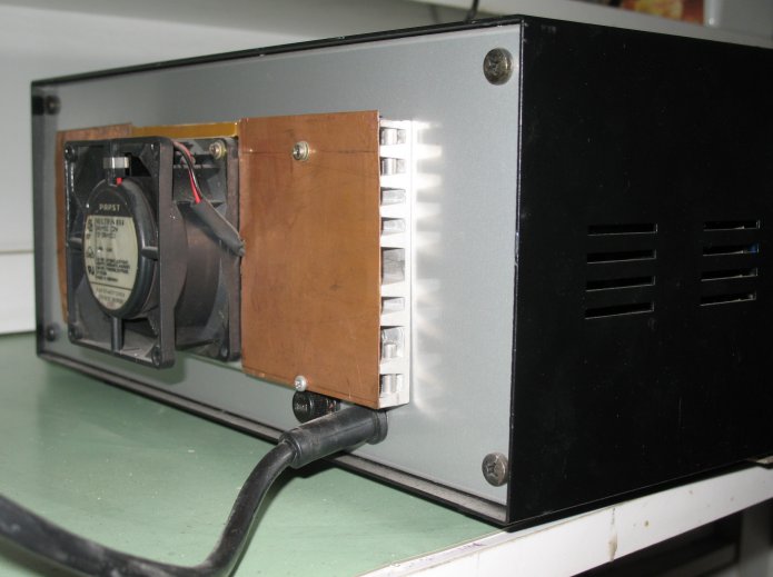

This evening I was in my garage while I was modifying my father's DVB-T receiver so I had the camera with me and I took 2 picture of a special PS I built it in '96, it has 2 outputs: 25V 2.5A and 13V 2A.
The most expensive parts were the 2 digital meters.
The voltage and current regulation/measurements are obtained by LM324.
The output power is regulated by PowerMosfet.
The voltage regulation has 2 potentiometer, one is for fine voltage tuning.
For the current I added the switch "IR": this switch shut down the output when the current limitation triggers and re-enable the output trough a soft-start after 20second. I used this function when I did some works at home just to avoid to burn components or tracks.
On the rear I had placed and HS and a FAN that start only when the temperature on PowerMos reach 70°C. If the temperature exceed 90°C the PS shut down till the temperature fall to 70°C ( IIRC).
Somewhere I have the electrical diagram, it is on paper because I had never time to draw it with Orcad.
I bet that if it breaks I'm not able to repair it because inside there's a chaos of wires and componets
Maybe someday I will open it and I show you how insane I was 12 years ago

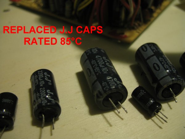

I recapped a SMPS on a PC that had non problem with hardware, a person just asked me to reinstall everything because he had some virus running on it.
I have not seen badcaps on the MOBO, but since I have found this lovely forum, I have learned to lokk inside SMPS so I opened it and I saw a bulged cap on 5V STBY.
All other caps were looking normal but they were all J.J caps rated at 85°C.
So I replaced them with Panasonic FM as precautionary measure.
What surprise me is that there were two flying inductance: they cannot fit into the place on PCB so the manufacturer has glued them on the transformer and on output cap.
I don't understand why they draw a 10mm inductance on the PCB and than they use a 30mm toroidal inductance...
Anyway after recap the SMPS and reinstalling Win everything was OK.

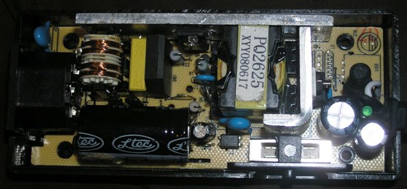

Universal notebook computer adaptor, model YTT-100W.
All caps 105C.
LTEC TY Series 100uF 450V primary.
Samwha RG Series 47uF 50V PWM controller filter.
Samxon GS Series 1000uF 35V before output inductor.
Nichicon VZ Series 470uF 35V after output inductor.
Soldering is a little sloppy, but not too bad.

What's that selector switch for variable voltage output for different brand notebooks?

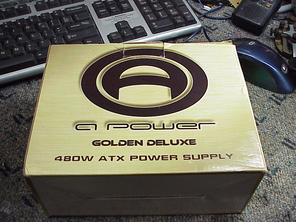

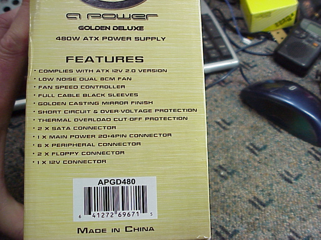

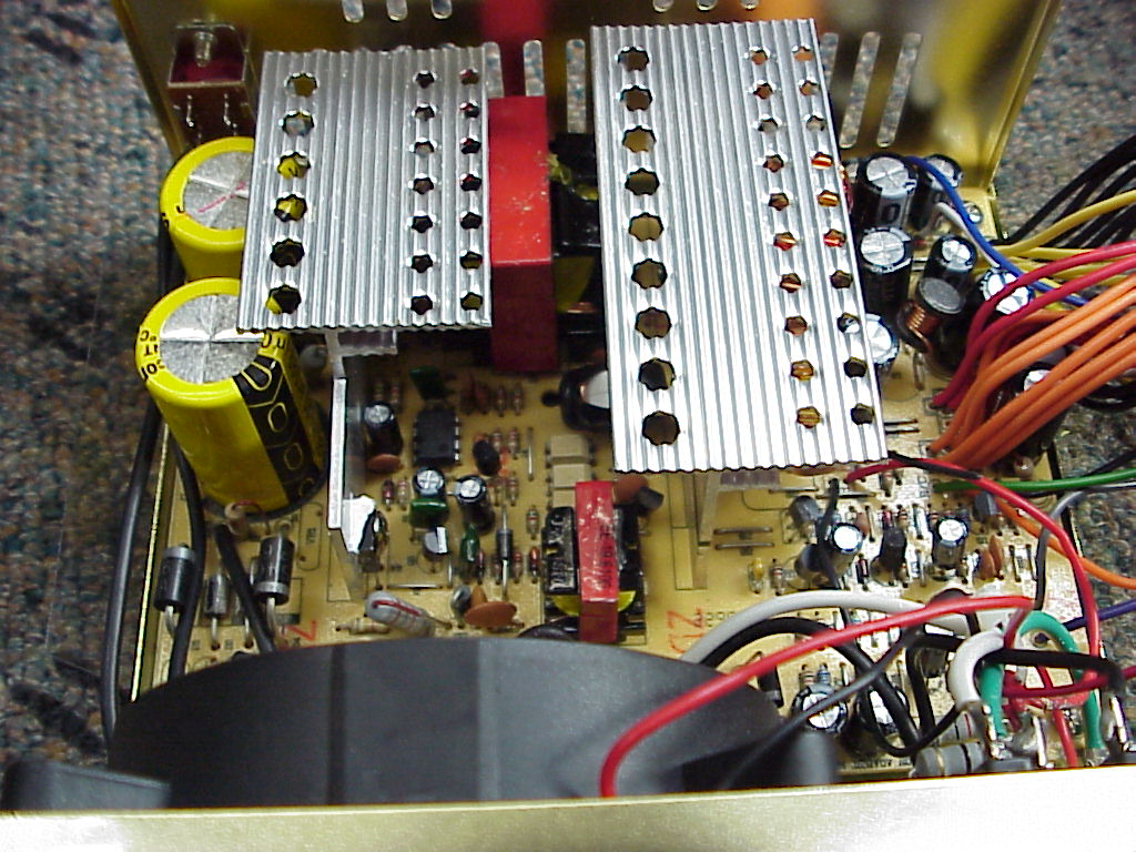

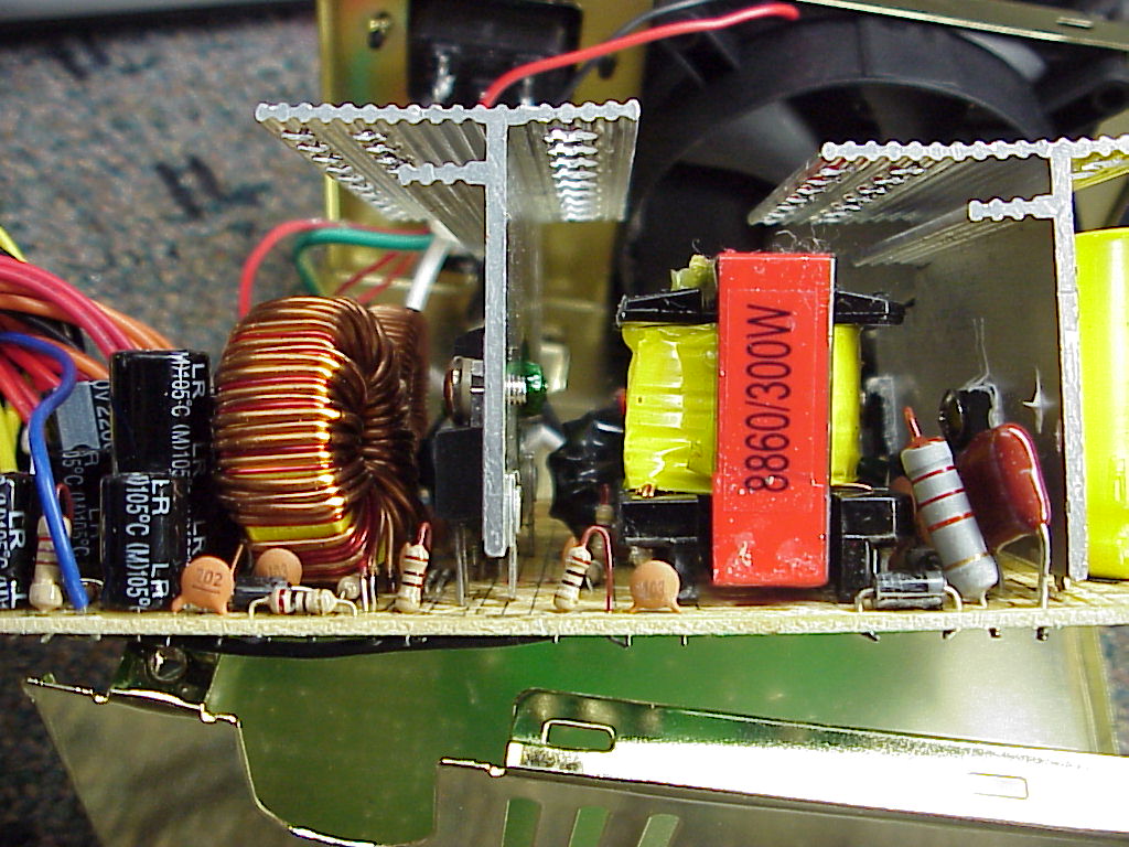

a power golden deluxe "480w"pile of shit.
logo was changed recently to fool the unwary.
but its the same junk in a pretty case.
note the 300w rating on the transformer.thats even a stretch.
it went straight into the trash after i took the pics!
Yesterday I was browsing the hardware stuff in Value Village (sometimes you score good stuff), I saw a generic brand golden PSU, two 80mm fans one on top and one at rear. Ew, why one want a GOLD looking PSU? :P
@ kc8adu: It looks like a Powmax/Leadman. First thing that gives it away is the bridge rectifier - powmax/leadman always mix diodes. In your case, it seems like a mix of 3 amp and 1 amp diodes. I have a Powmax LP6100D with a mix of 6amp/3amp diodes (since it's supposed to be "500" watts). The controller/pwm layout also seems very similar to my Powmax. Lastly, you have the voltage switch mouted on the front of the PSU. I bet the fan is Yate Loon too.
Overall these units aren't that bad, at least not for old PII/3 systems. Mine worked for 5 years, 2 of which were with bad caps and it didn't explode. It still works, but it needs a recap. Yours, though, has tiny heatsinks, tiny transformer, and is missing all of its input filtering. Probably not safe to use.
And why would anyone use dual-fan design? Personally, I think it's ineffcient for cooling the PSU.
