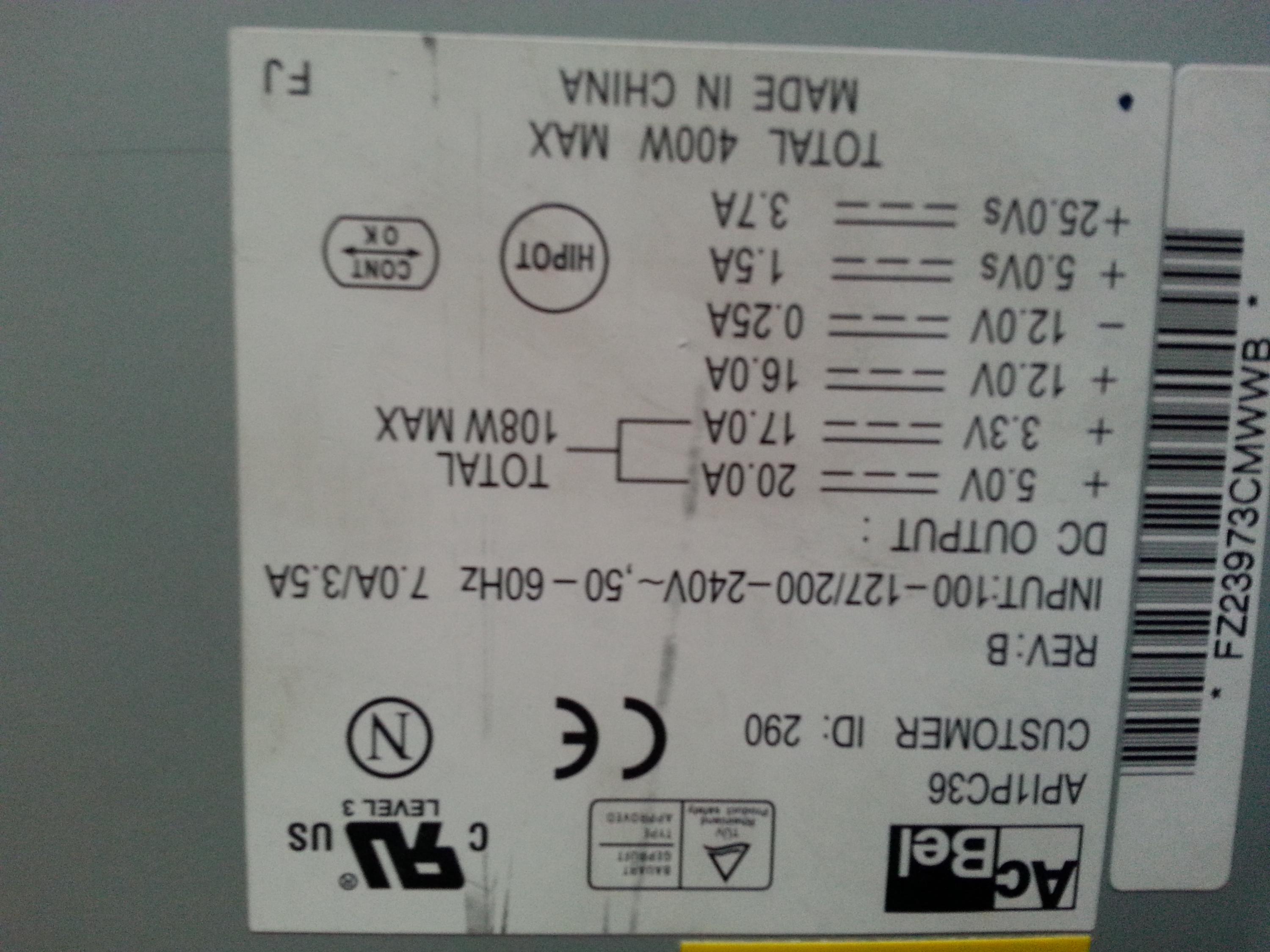

        I have the same PSU, same symptoms, but the white 25V lead is shorted. Any ideas what I should check?

                Looks like the 25v was me and some bad soldering. That part is fixed now. I get 5v trickle and 25 volts, but no trickle 12 v like I should per the link below. I have one 2200uf that looks fine, that I haven't replaced yet, should I go ahead and change it out too? The PSU fans spin and turn off when I push the power button.

                  Best read that pinout again.

                    Looked it over again. They made it sound like the 12v was a trickle. Since the PSU fans spin up and quickly turn off when pushing the power button (motherboard lights up too) and I have 25v and 5v trickles, which caps would you recommend replacing next?

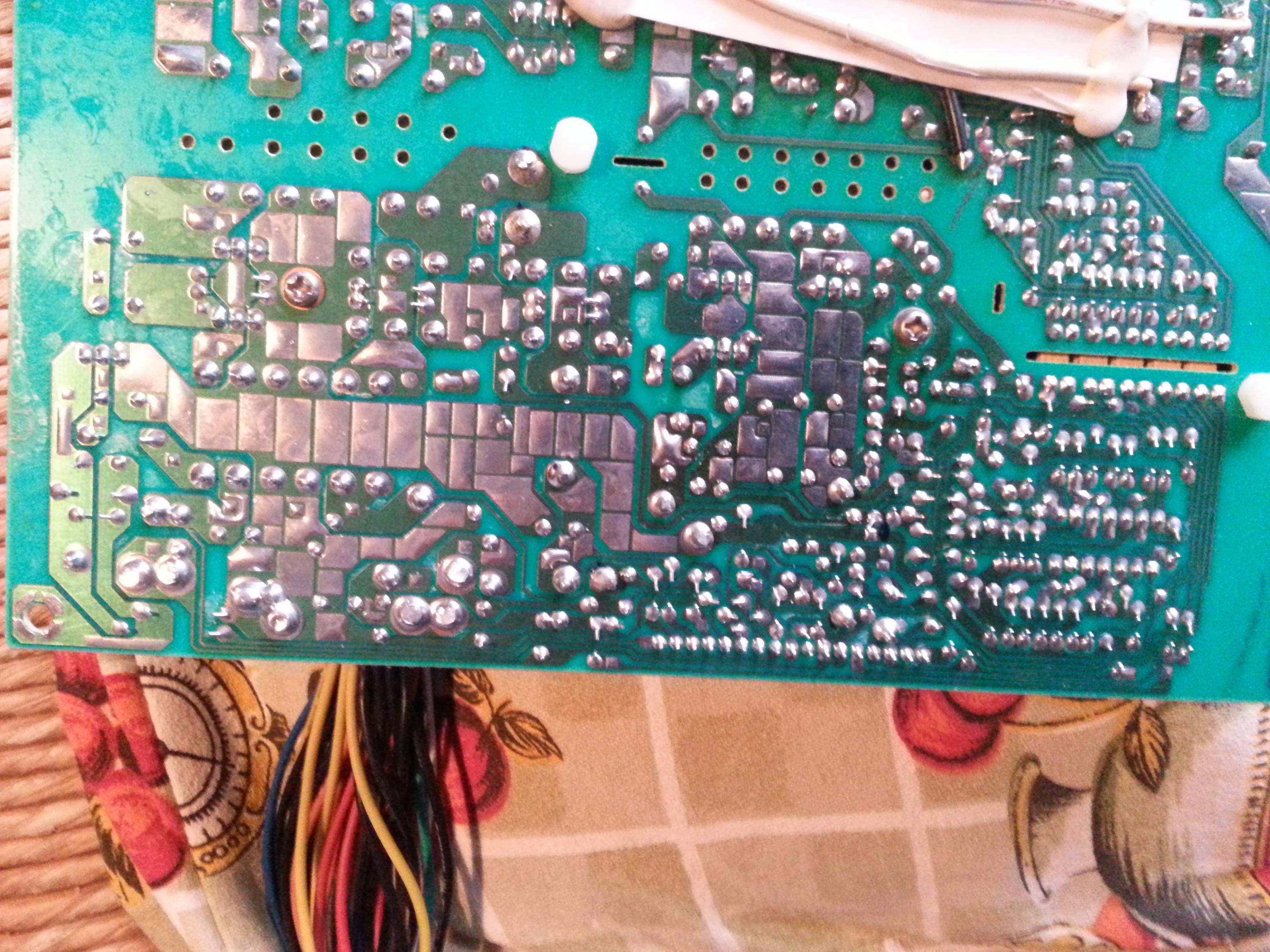

                                  Hi, my G4 MDD (dual 1,25) did not turn on, nor the power button on the monitor ADC. So I recapped on the PSU C43 (100uF/25) and C60 (1000uF/10). Now the light on power button of ADC monitor turn on, but no chime and no life signs on the computer. Besides this it is very difficult to know where the critical caps are located. I bought all the caps in the list "MDD PS Replacement Caps as Used 20th Oct-2.pdf", but until now only 2 substituted. Could you suggest me where to find the critical on the list, if you have just done this work? I attached label type of PSU and the side where I think there are the "critical" caps. Many thanks for the help...

                                    Re: Suspect Bad PS Apple AcBel API 1PC36
                                    Here is my drawing from several years ago. Hope it helps!
                                        Many thanks for the drawings. It made me the work shorter! Now all works again!! I checked with ESR/Capacity meter and only 2 caps gave me bad measures, the small ones (0,47uF and 47 uF. The other seemed still good. In any case now PSU is renewed!!

                                          #140
                                          Finally, the correct thread... Thanks again Toasty! Much higher resolution file is available if you'd like. Just email me. I'll most likely be in touch again, once I crack open a Samsung PSU for clarifications on a similar line-art project. Cheers!
