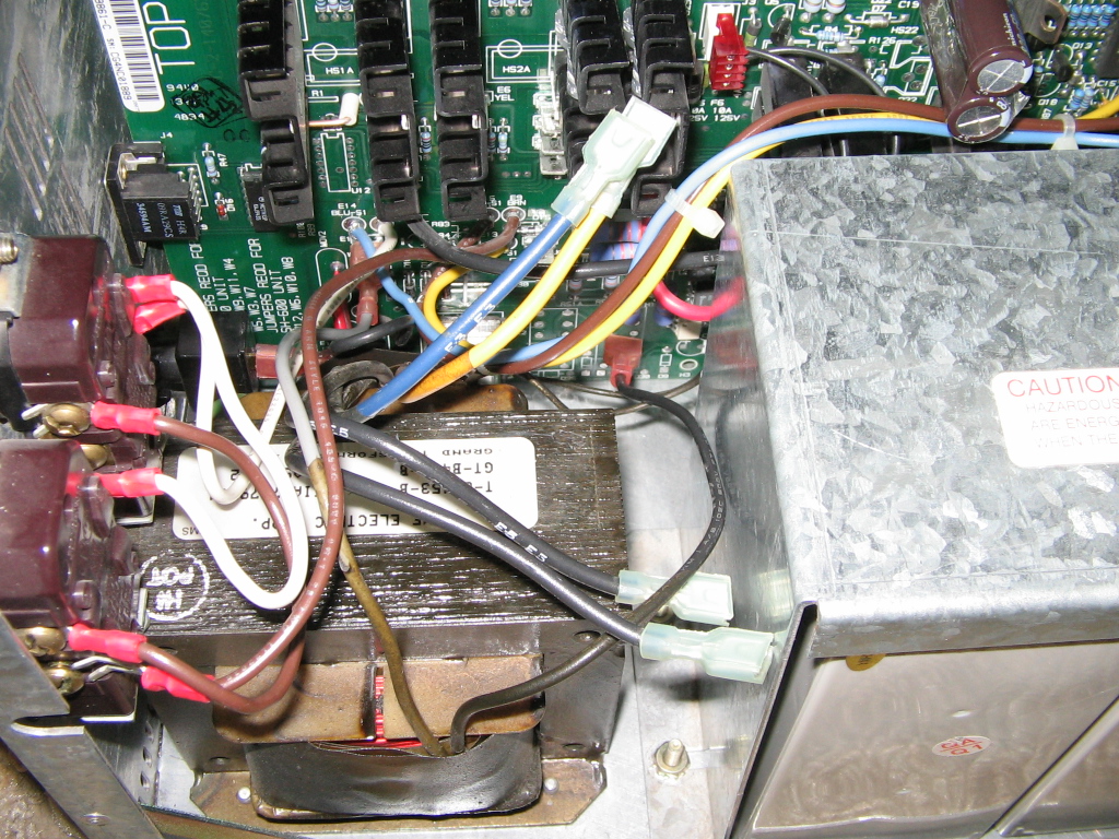

    UPS shorts out
    My dad got two free UPS from work, one works fine the other doesn't. It trips its internal breaker as soon as I plug it in. I see nothing wrong with the board, can't find anything wrong. My dad plugged it in with the board disconnected, and it didn't trip. when he plugged the transformer into the board it blows. Not sure if its a problem with the transformer or something on the board. Any help would be great.
    Btw the caps are nichicon
  • kc8adu
    • Nov 2003
    • 8832
    • U.S.A!
    Re: UPS shorts out
    looks like a best power.
    look to a welded relay or bad mov's.
    those units work well with an external deep cycle battery too.

            Re: UPS shorts out
            pull the mov's and try again.
            that relay looks odd in the pic.

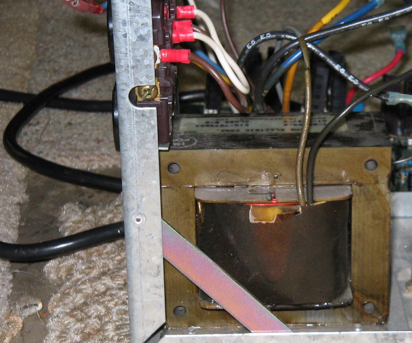

              Re: UPS shorts out
              Dust cap on relay can be popped off for closer look.
              Board itself looks like it may have been wet?

                Re: UPS shorts out
                I don't think it has ever been wet, and the relay still moves.
                Put a piece of paper between the contacts, pugged it in and it didn't blow, so its definitely something on the board and most likly an mov

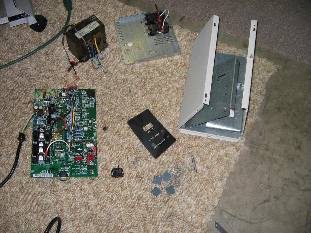

                  Re: UPS fixed, not really
                  I fixed it!!! : : :
                  wasn't worth fixin' because both batteries are bad

                        Re: UPS shorts out
                        My Dad checked the batteries, he tried a car battery charger and they still wouldn't come up past 7 volts each. It is still good for parts and stuff
                        It was refurbished in 03 but the case was made in 94. RIP 06
