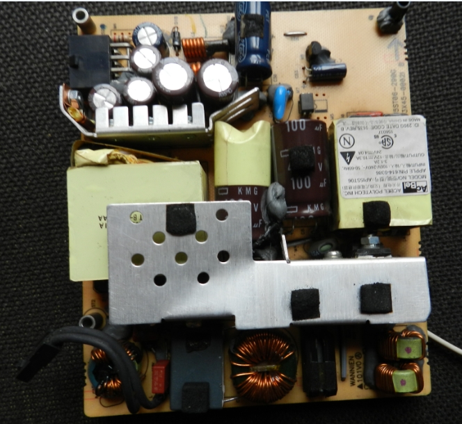

    I checked D9, it looks like the following(four lines on top) of A6
    A6
    It measures (in circuit) .555 v one direction and OL the other using the diode test with my dmm. Doesn't that mean it should be functioning correctly?
    The grey goop guy is:
    TL431AC: datasheet included.
    The others are as follows:
    M6: fc762
    m9: fc762
    m10: Lm393
    I have included couple of the datasheets. not sure on the fc762? Please advise of any further tests or ideas you might have.

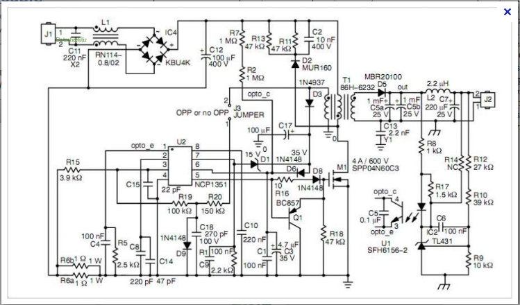

      Here you have a NCP1381 schematic application, but it differs in many aspects from the circuit I'm looking for.
      Is there someone who knows de value of r83?
      Thanks in advance.

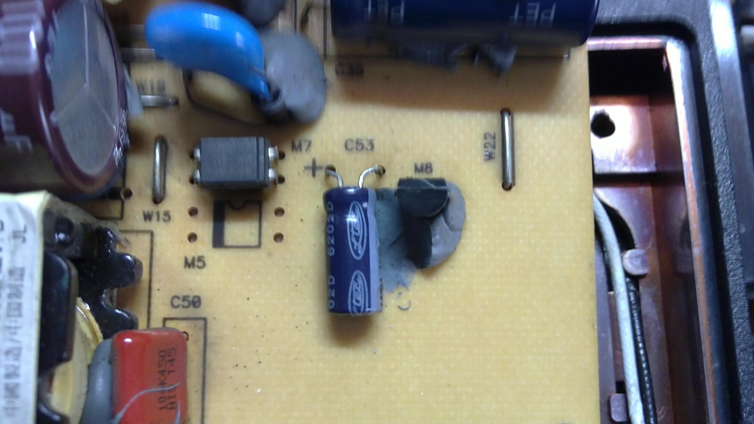

        @ bottleneck - D9 readings look fine. It is C53 that keeps blowing out, correct?

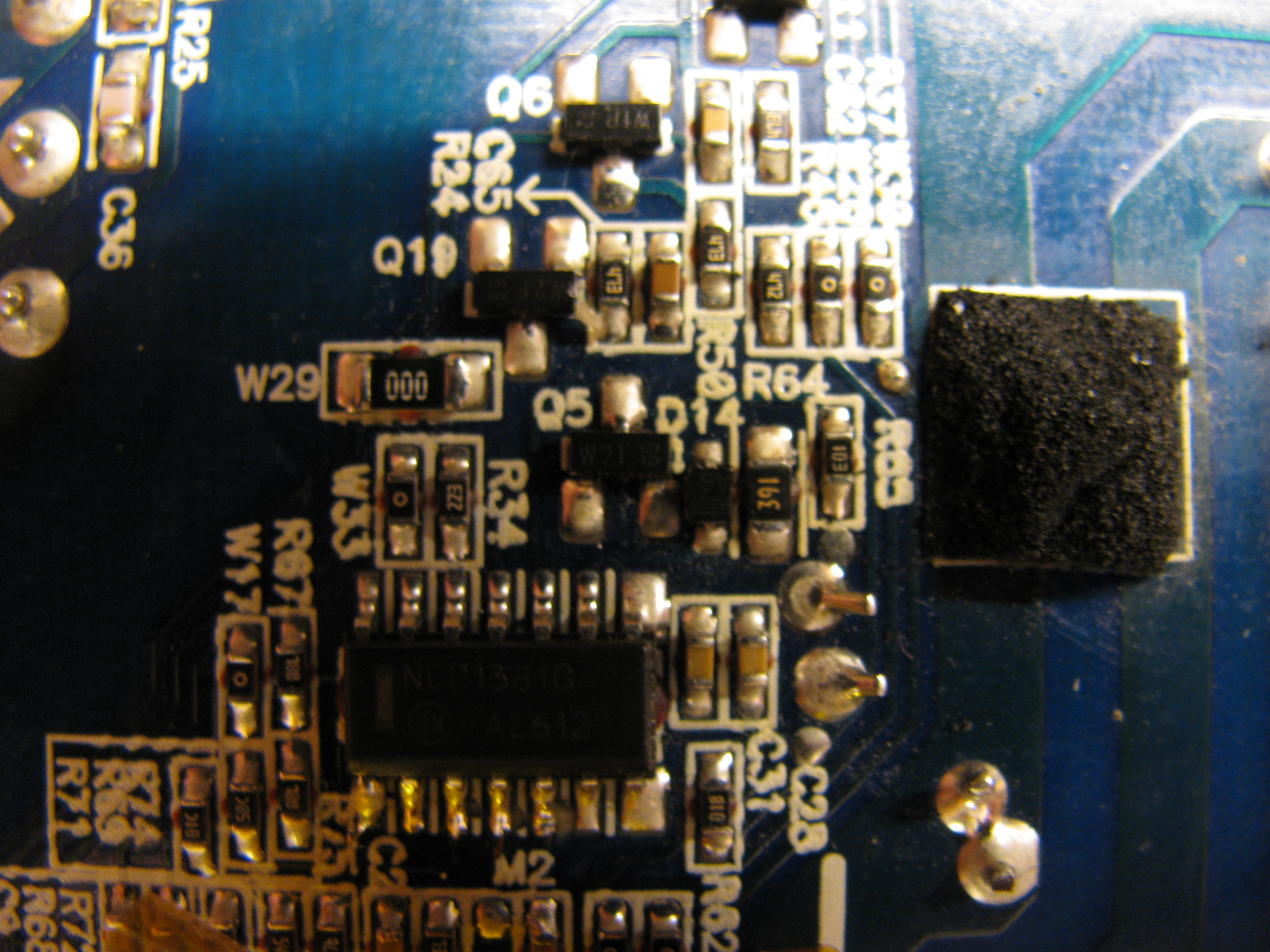

          Hi Toasty, I can`t understand your questión, the NCP1381 is in the pcb of the psu I have.
          Could be posible that we are talking about different psu`s?
          I will take some photograps and uploads it.

            Toasty... ncp1381 is located under what I'm guessing is supposed to be a heatsink. The Copper thing in the center of the board. I could retake a picture with it lifted up if it will help.

            Yes C53 is the correct cap in question. I noticed there is something under some silicone as well VR1. would this be a regulator? It doesn't look like anything I have seen before, its completely metal. Rather than march ahead, I was hoping that you might have an idea?

              @ bottleneck - Thank you. That's what I wanted to know. Since there are no pictures of the NCP1381. Can someone please take some? Also, I believe the copper is a shield, rather than a heatsink.
              re: C53 - okay, just want to be sure we weren't chasing the wrong cap. Again, no one has given a cap layout of this PSU.
              VR1 is the adjustment for the TL431AC device. Do not try to move it. It is preset and the silicone locks it from moving.
              I really need to find one of these for CHEAP.
              Check the cap attached to one end of R83 to ground for short. If, as Franciso.s says, R83 is attached to pin 3 (DMG), it's feed is directly off the transformer. Depending on which schematic you follow, there are a few scenarios where R83 could get damaged.
              Looking at the schematics and coming from Pin 3 (DMG), which position is R83 in? :
              Is it R12 or R13 in Francisco.s' schematic?
              -or-
              In the datasheet, the resistor above the NCP1381 or the one next to the transformer?

                Hi Toasty, I have taken some photos to clarify the position of some componentes, I hope so.
                . I can read the value of that capacitor, and is an electrolitic one, value: 22uF 50v.
                there is no short in that capacitor (c54) in my psu, and it has other resistance (r67) conected to r74 and this one, to pin3 of NCP1381. There are other components in this series of resistances, going to PFC circuit.
                  R83 would be R12 in NCP1381ADAPEVB_SCHEMATIC, I can`t find the equivalent of R13, but as I said before, there are other resistances going to PFC circuit.
                  Finally, I`ve found D9, it is a smd diode that feeds c53, and if this capacitor is damaged, probably the optocoupler (m7), the ic TL431, or an open resistance in that circuit can be the bad part. Also in the primary side of the transformer, there are one diode (D11) and some electrolitic capacitors that can do a bad job.
                  I would like to take some captures with the oscilloscope, that will help to find the problems, but I can´t get my PSU work continuously, and it is because the driver circuit, of the power mosfet has damaged componets that I can't identify. (I get some pulses in the mosfet drain, but then, nothing)
                  There is a smd transistor (Q5)that amplifies current to drive the mosfet, and it is imposible to read the name. (it puts 35 and something more)
                  I'm doing some research to identify that transistor, and repair this PSU that is a big headache.

                    Using R12 as R83 - DMG (3) monitors the voltage from the trafo. If R83 failed, then either the cap to ground shorted, or the IC failed / shorted.
                    Failing to find R13, then by the NCP1381 datasheet schematic (pg. 2), it would be the resistor above the chip. Again, the same failure scenario.

                      Could you take a photo of the ncp1381 near the smd transistor q5?

                        Hi Toasty, here is the Bill of Materials for the NCP1381 Evaluation Board. Surprisingly the value of R12 is 100 kΩ. (but again, as we don´t know the values of the IMAC PSU, then....)

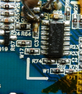

                            I apologize for the delay on the picture, i havent had time to get back here. I have included it now. Let me know if you need more.

                              Thanks for the photo, now I can see more clear the name of Q5. I will try to find a replacemet, and see if the psu starts to work. As we said, it's very likely, your problem is the value of r83.
                              I will confirm you that, as soon as possible.
