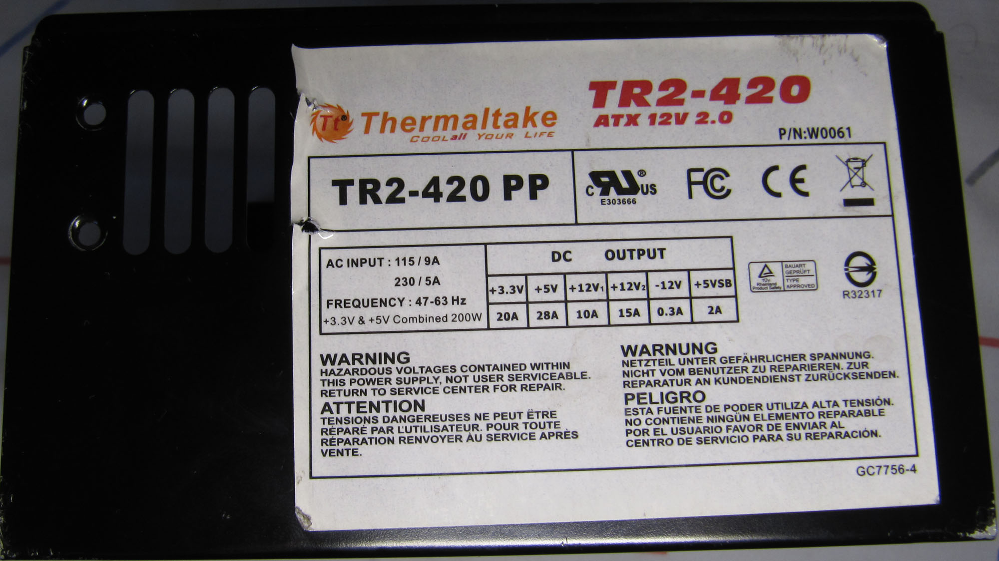

    This power supply was on 24/7 in a store for several years until it started to show symptoms of failure. I opened it to find that nearly every cap inside has failed, including the small 1uF 50V ones!
    You can easily conclude that this psu was never going to do 420watt. Just notice the PBL405 bridge rectifier, good for 4A, at the same time the psu has setting for 115V, this is just unacceptable for a brand like Thermaltake.
    Moreover, I found another version of the psu label on the web that states "Total Output Power: 350W"

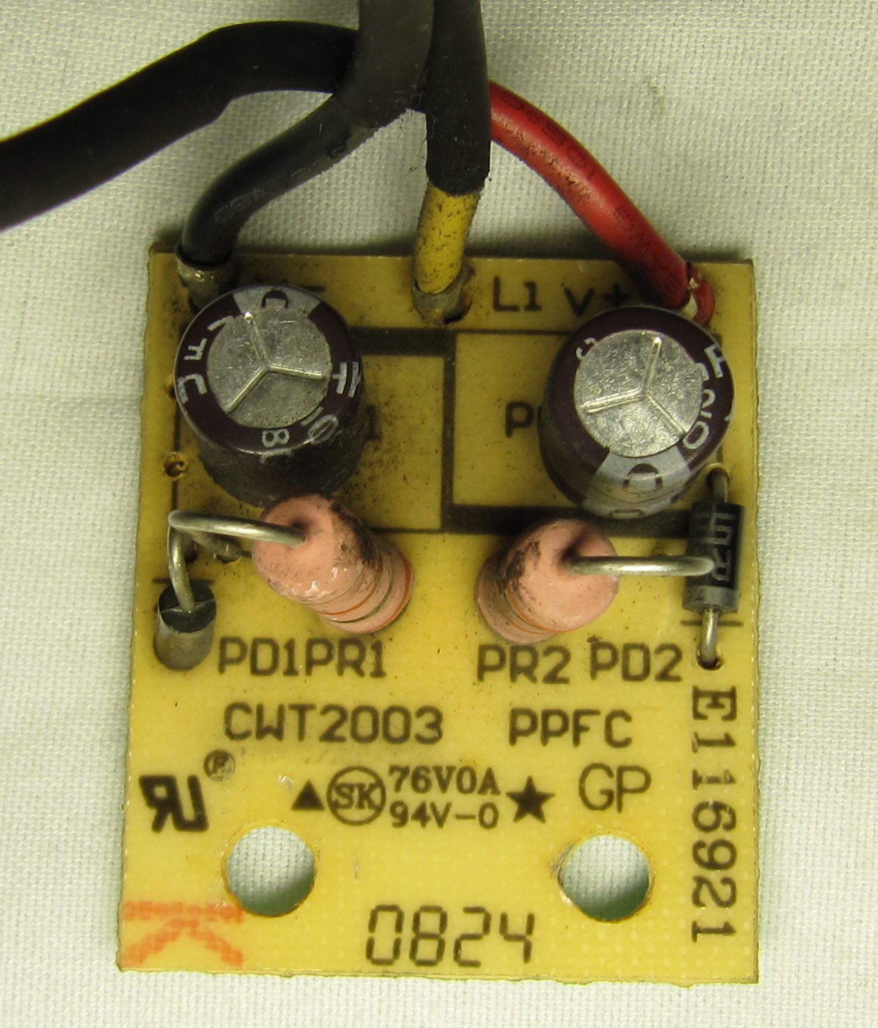

    Next thing that caught my eye was that stupid valley fill PFC voltage booster add on board that does nothing but generate extra unwanted heat and cook the 2 unlucky small 400V 2.2uF caps.
    https://www.badcaps.net/forum/attach...1&d=1389575653
    I immediately remove/disable that circuit every time I see it.

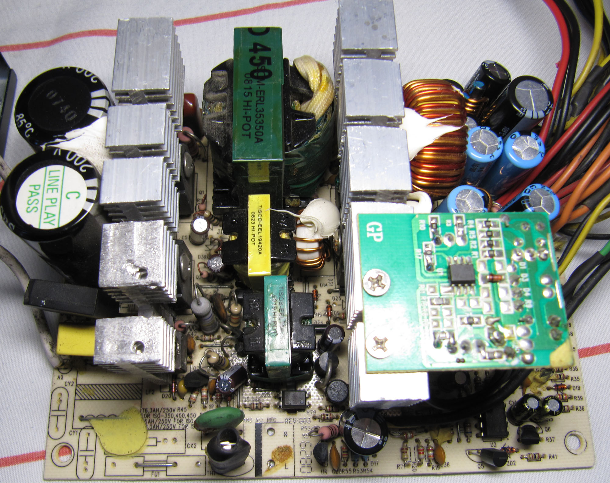

    The psu uses old half bridge topology featuring UTC TL494L PWM controller and TPS3510P supervisor IC.

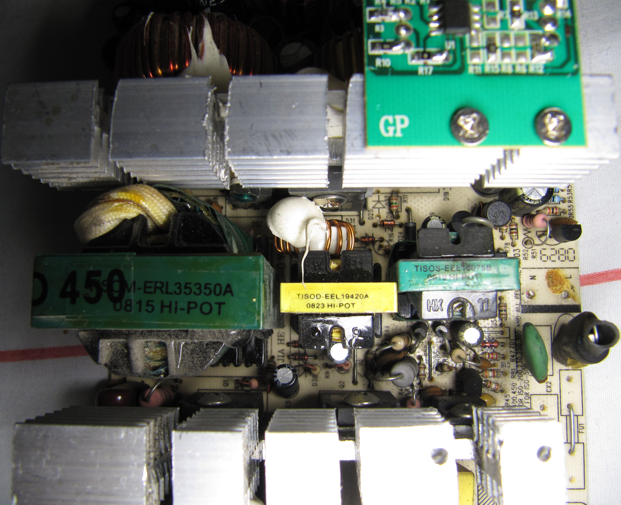

    The main switching transistors are E13009 made by Fairchild semiconductor and they come in TO-3P package. This is good enough for 350W continuous, but whether they are going to do 420W without blowing, depends on the design and main transformer size and primary capacitors real capacity. The main transformer is ERL-35 and the primary caps are OST 820uF 200V but their real capacity was 633uF and 655uF, clearly outside the 20% tolerance.
    I have to confess I don't have any objections about the secondary of this power supply. All the voltage lines have pi coils installed, the toroid coils are big enough for 350W, and the caps are reasonably sized:
    3.3V: 2x2200uF 6.3V JunFu HK
    5V: 2x2200uF 10V JunFu HK
    12V: 1x330uF (no, it's not a typo, it's 330uF!) 16V JunFu & 1x3300uF 16V OST RLP
    5vsb: 1x470uF 10V OST RLP & 1x 1000uF 10V OST RLS
    -12V: 1x220uF 16V JunFu HK
    The secondary silicon is impressive too:
    STPS3045CW, 30A @ 3.3V
    2x STPS2045CT, 40A @ 5V
    STTH3002C, 30A @ 12V
    The caps are a mix of OST and JunFu. There are 2 failure modes. Either the caps were found completely dried, or had too high esr and low capacity. There are no survivors, except some small caps next to the 2 ICs.

                Why didn't you discard the PPFC coil while you were at it?
                  Re: Thermaltake TR2-420 (350W)
                  Why discard it? It doesn't hurt in any way, except maybe by blocking the airflow a bit.
                  Active pfc, on the contrary, sometimes does more bad than good, for example, when it boosts primary caps voltage too much (~400V) resulting in premature failure. Another occasion is when it generates a fair amount of heat and lowers total psu efficiency.

                        The only thing the input filter lacks is a second common coil, but unfortunately there is no space cause of the ppfc...

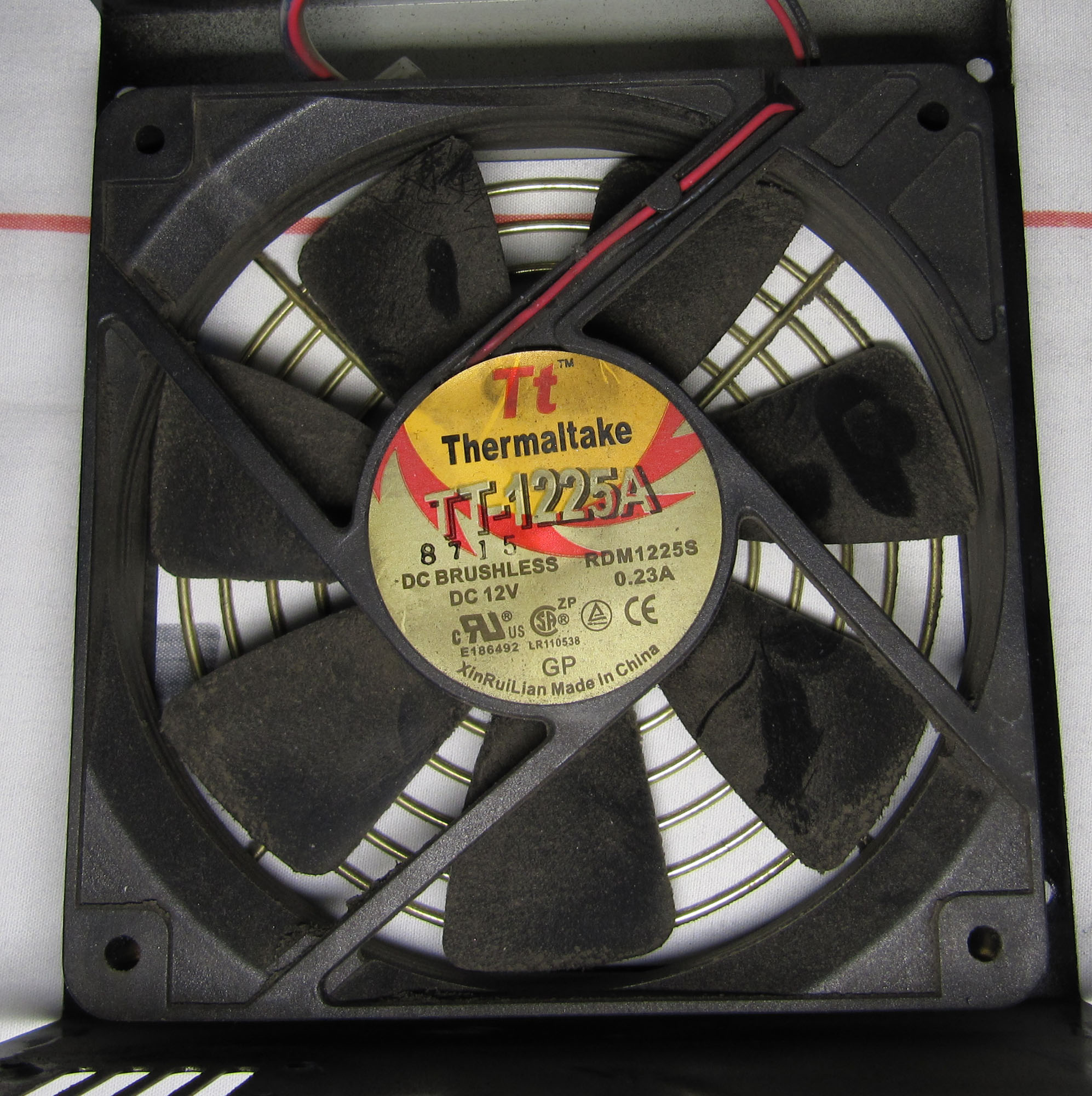

                          I had some spare Panasonic 200V 800uF capacitors and thought it would be a good idea to replace the FAKE 820uF(real c: 630uF) OST primary caps. While working at it, I put 2 drops of Singer sewing oil in the fan, but something went wrong.
                          In low rpm the fan retainer ring didn't rotate along with the fan, as a result the fan's speed reduced dramatically and there was sound coming from the friction of the ring with the shaft. In high rpm the fan worked without problem.
                          The retainer ring was plastic. I tried to remove it but it broke.. Now I have reassembled the fan without that ring. It seems to work. The magnet keeps successfully the fan from dropping, but is there anything else I should know?

                            Should be fine.
                            I've had this happen on several fans where they seized and overheated. This made the plastic ring very fragile due to heat, so I broke it when trying to take apart. The oldest fan that I have that still works fine without it is an old generic CBE 80mm fan out of a Deer PSU. Probably ran it for a good few years like that before retiring the PC it was in.
                              It should be OK as long as the fan doesn't run too fast. I think there is a good chance that the impeller would fly off if I ran one of my jet engine delta fans with no retention washer.
