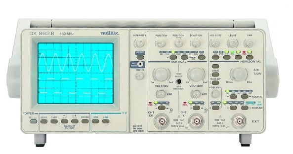

                            I had a quick prod around inside the 'scope this afternoon looking for anything that was obviously an RS232 port, and in the process discovered something which might actually be more useful than the serial port.
                            The OX 803B differs from the higher spec OX 863B in a number of important respects. One of which is that the 863B substitutes on screen cursors and a couple of TV line mode buttons for the "Component Tester" of the 803B
                            The difference looks to be exactly that, the 803B has a couple of wires going to the connector on the main PCB for the component checker (which looks to be a 1v 1kHz signal generator, but I haven't actually played with it yet). The 863B has in its stead, 7 buttons on a PCB.
                            Compare..
                            http://www.ghvtrading.cz/data/imgs/1066b-ox863b.jpg
                            .. and ..
                            http://sigma.octopart.com/24577920/i...cs-OX-803B.jpg
                            .. to see what I mean.
                            On the front panel PCB of my 806B (below) there is an unpopulated header (highlighted) that looks like exactly the right kind of thing to attach a row of 7 buttons on a ribbon cable to.
                            I think I *have* to prod that connector with a 10K resistor and see what happens. If I am right, then I should be able to add the features of the 863B
                            There are three other "missing" buttons beside the "Horizontal" rotary control on the front panel that might also be simply needing to be populated to add those additional features.
                            Who knows, the jump from 40 to 100MHz may be simply the addition or removal of a jumper/solder bridge. This little toy is turning out to be a lot of fun.
