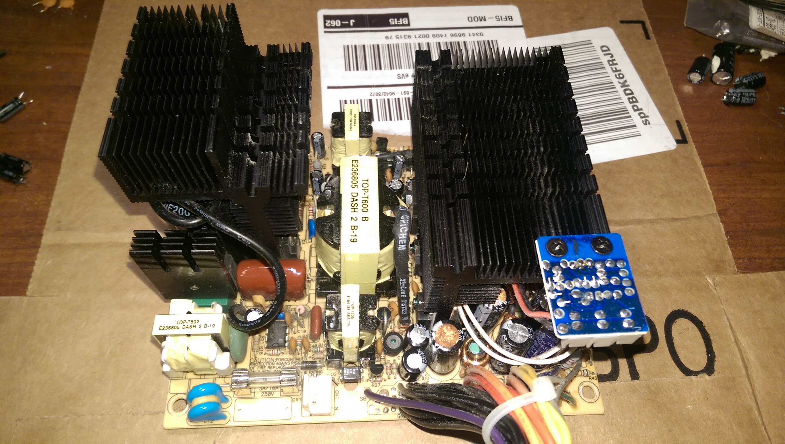

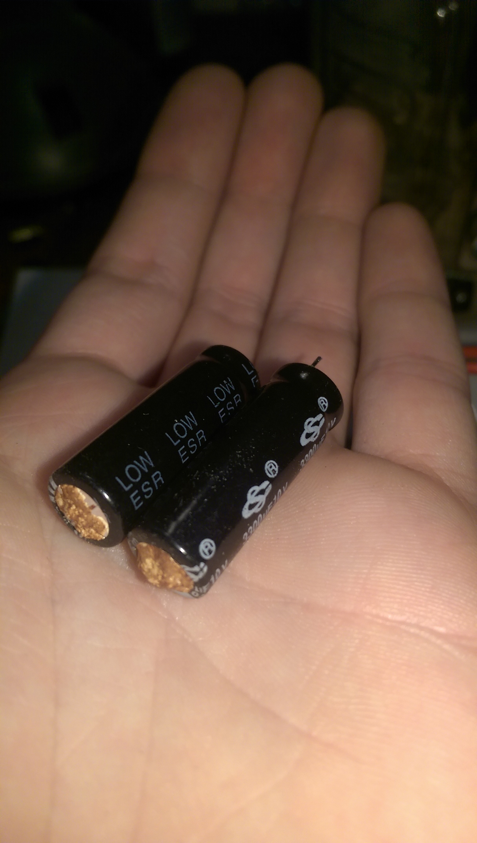

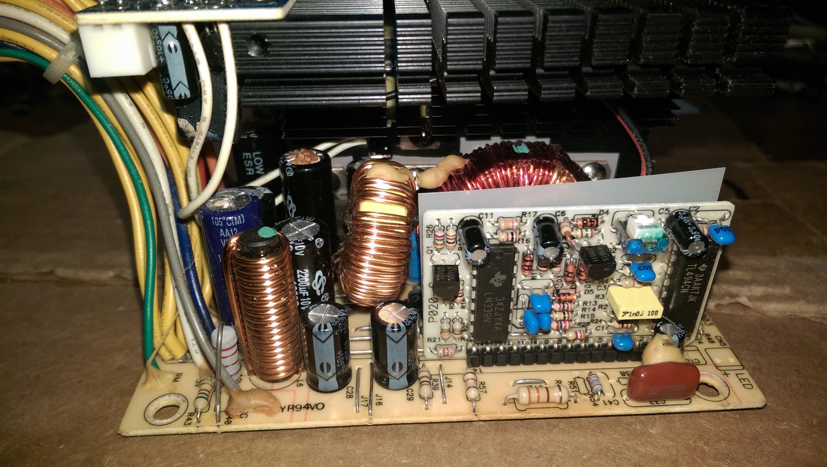

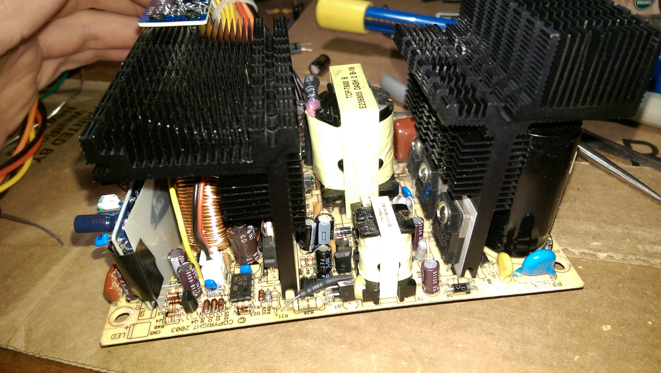

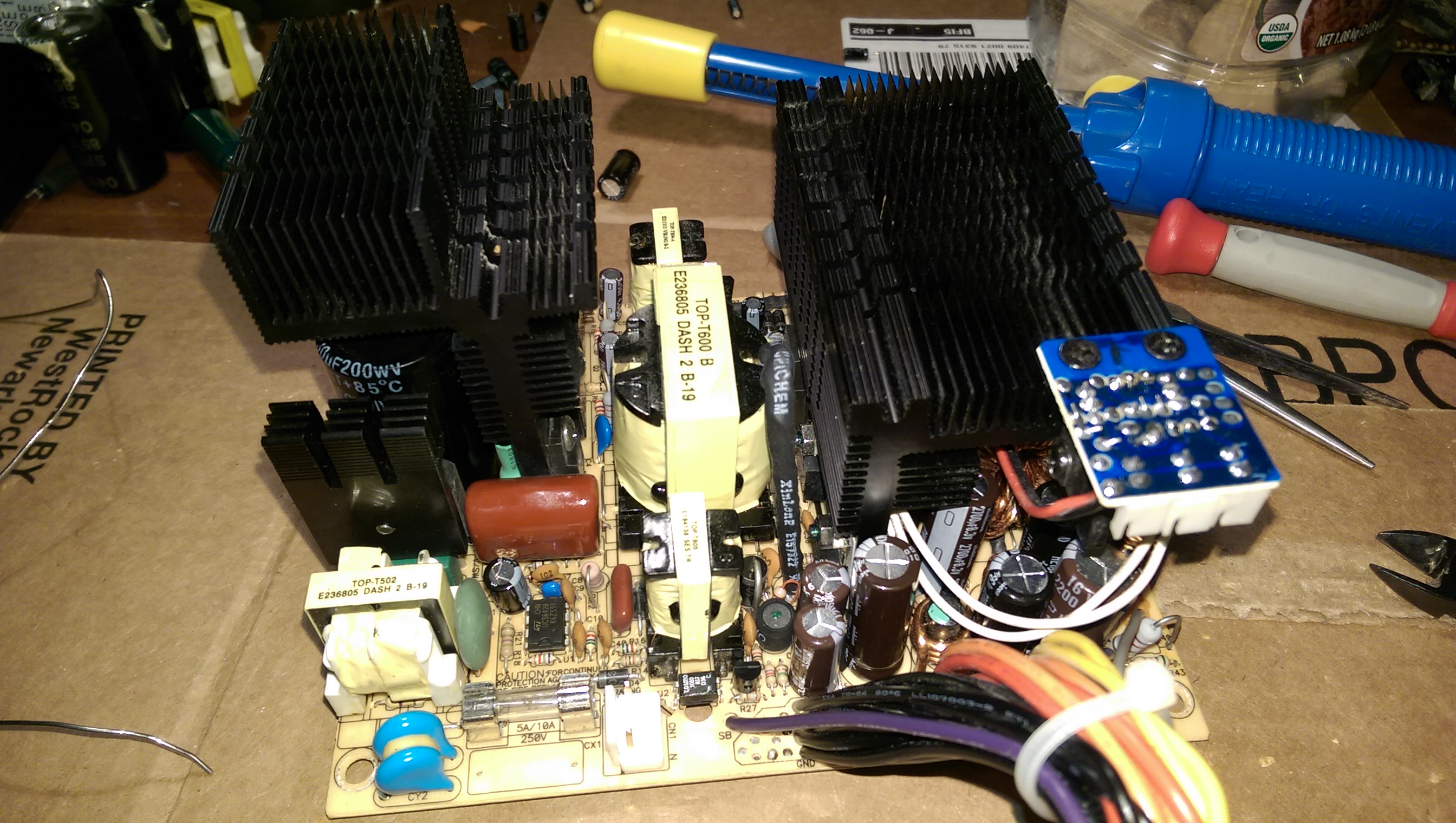

    These things are awesome...one of my favorite designs for old units. It really bugs me that Topower always used garbage caps. It pains me to think that the only reason these well designed units will be chucked in the trash is because the caps fail, so it makes my day to save one. As you can see, the caps in this unit were not in good shape! It was made some time in mid 2004.

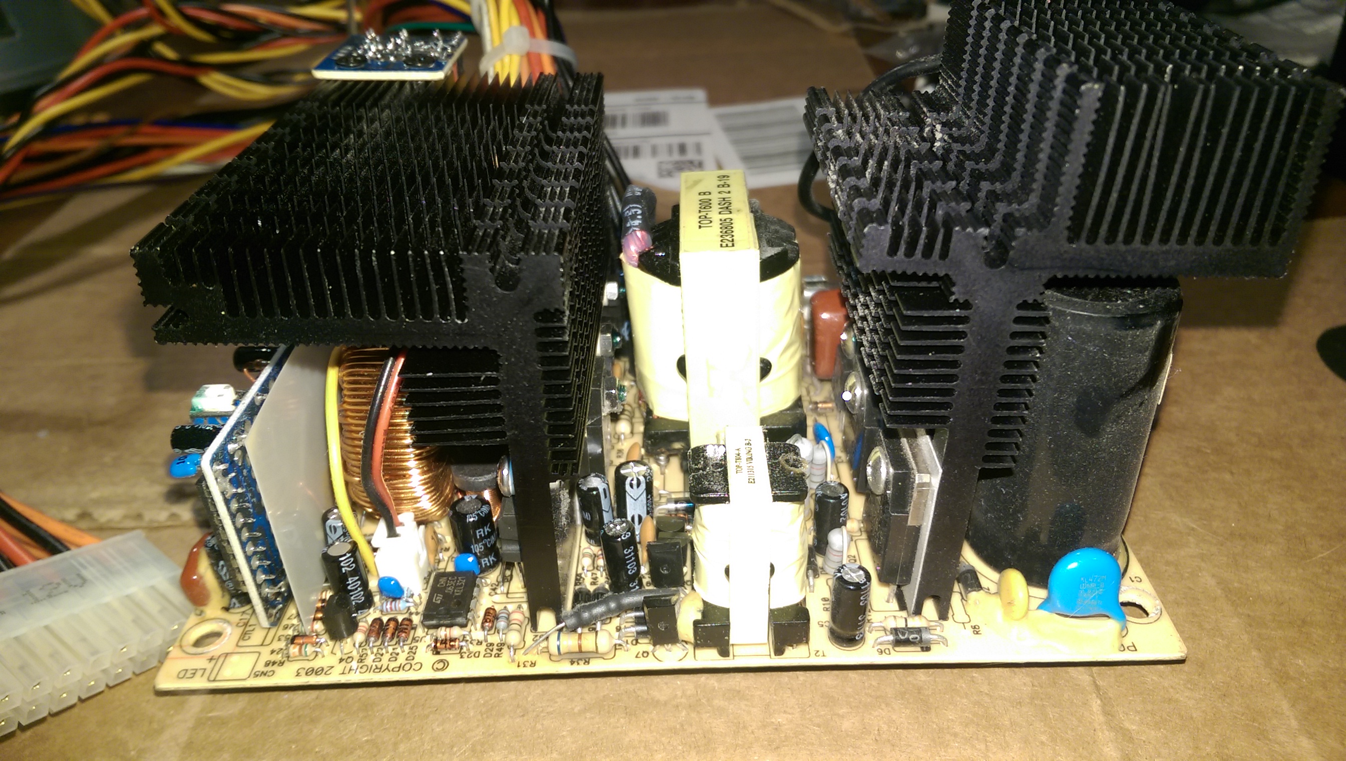

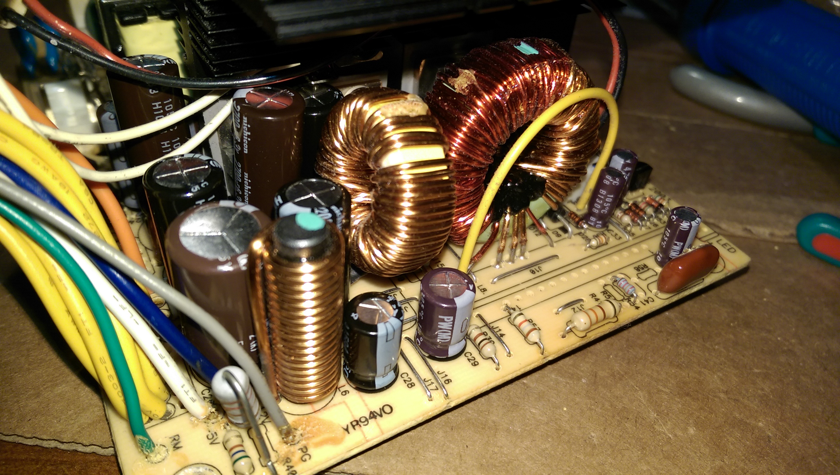

    To make a long story short, every cap in the unit tested bad except the bulk caps, BJT drive caps, daughterboard caps, and -12V rail caps. The CS caps that spewed their guts were both on the 5V rail. The CS 1000uF 10V 5VSB filtering cap that didn't bulge read: 468uF, 1.5Ω.

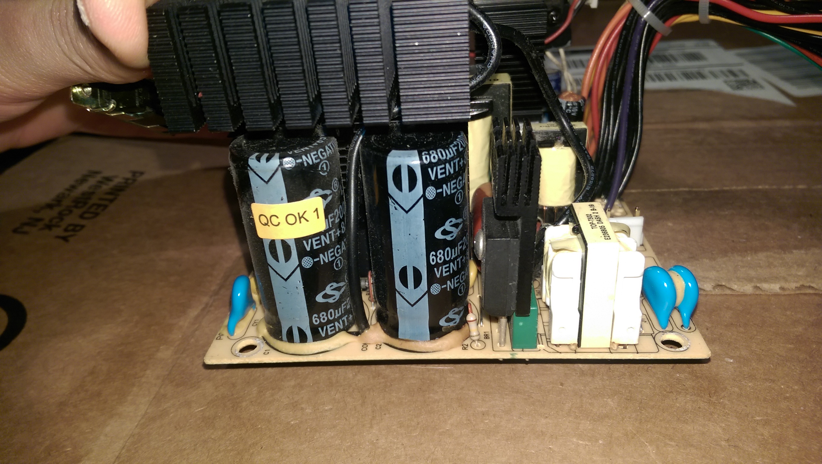

    This thing got a full recap except for the bulk caps. The bulk caps read: 668uF 0.14Ω, and 652uF 0.14Ω. Amazing how those things can hold up so well from bad brands.
    The only other thing I changed was the 100Ω resistor on the 5V rail to 200Ω, and heatshrinked it

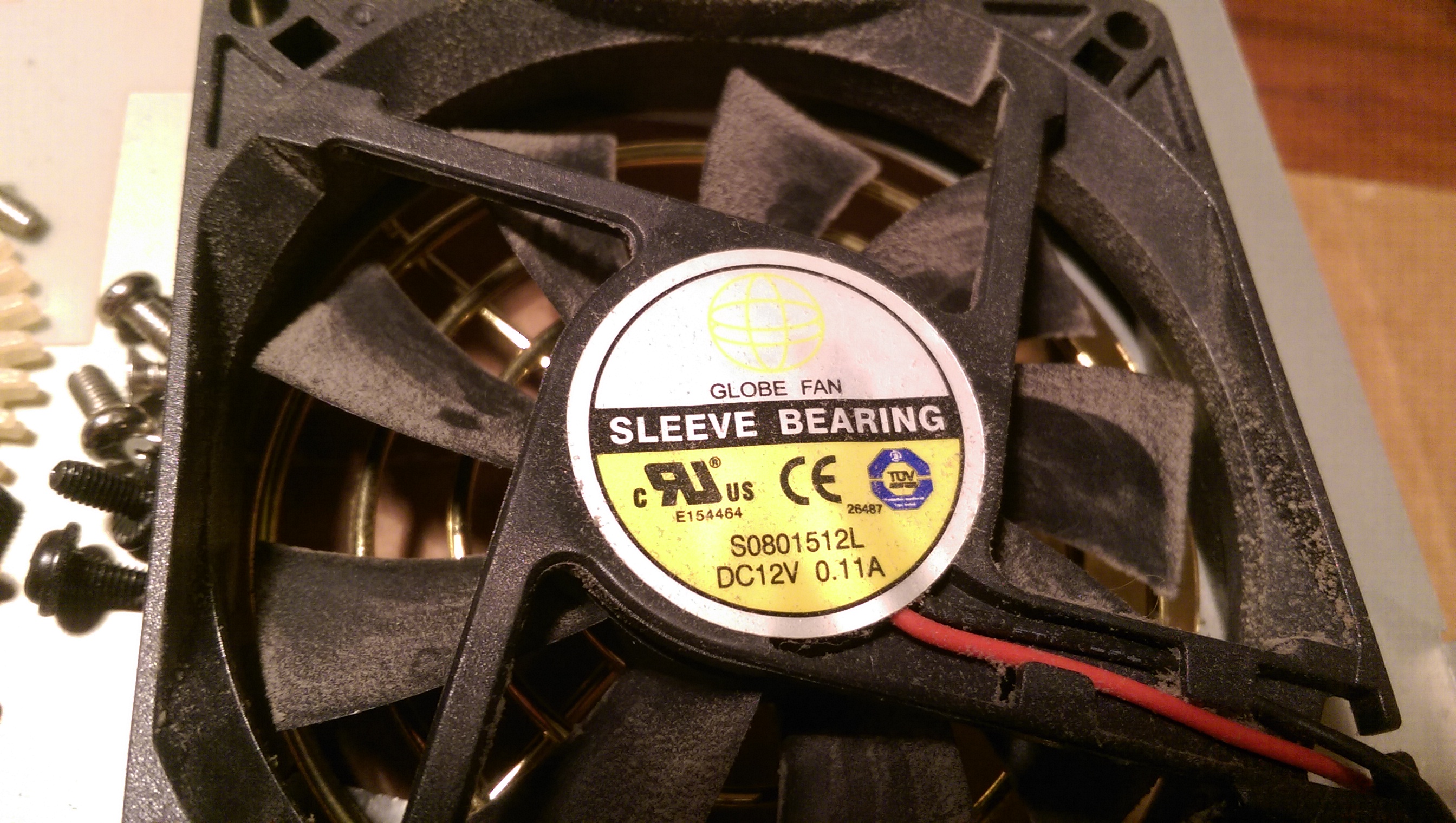

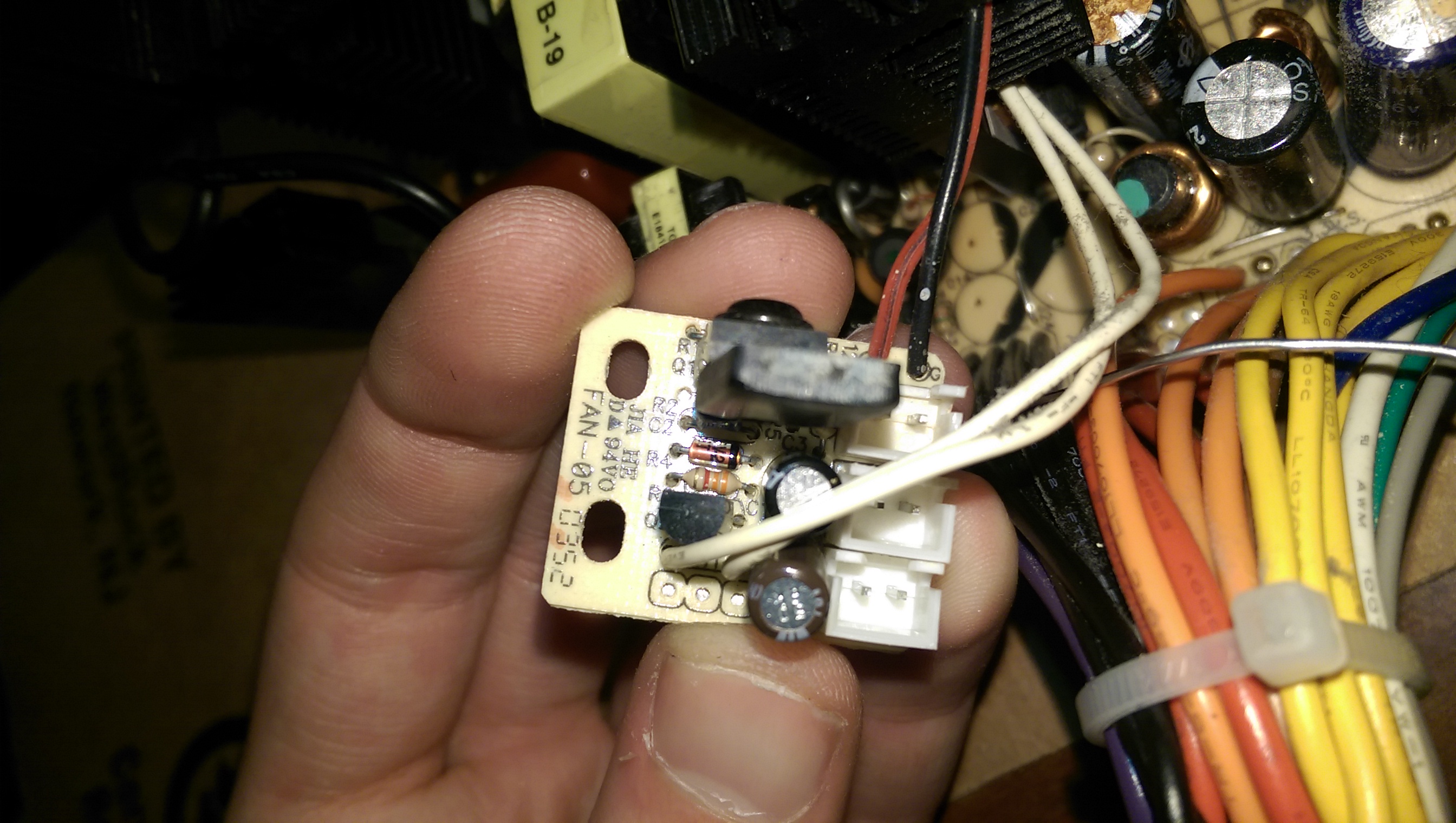

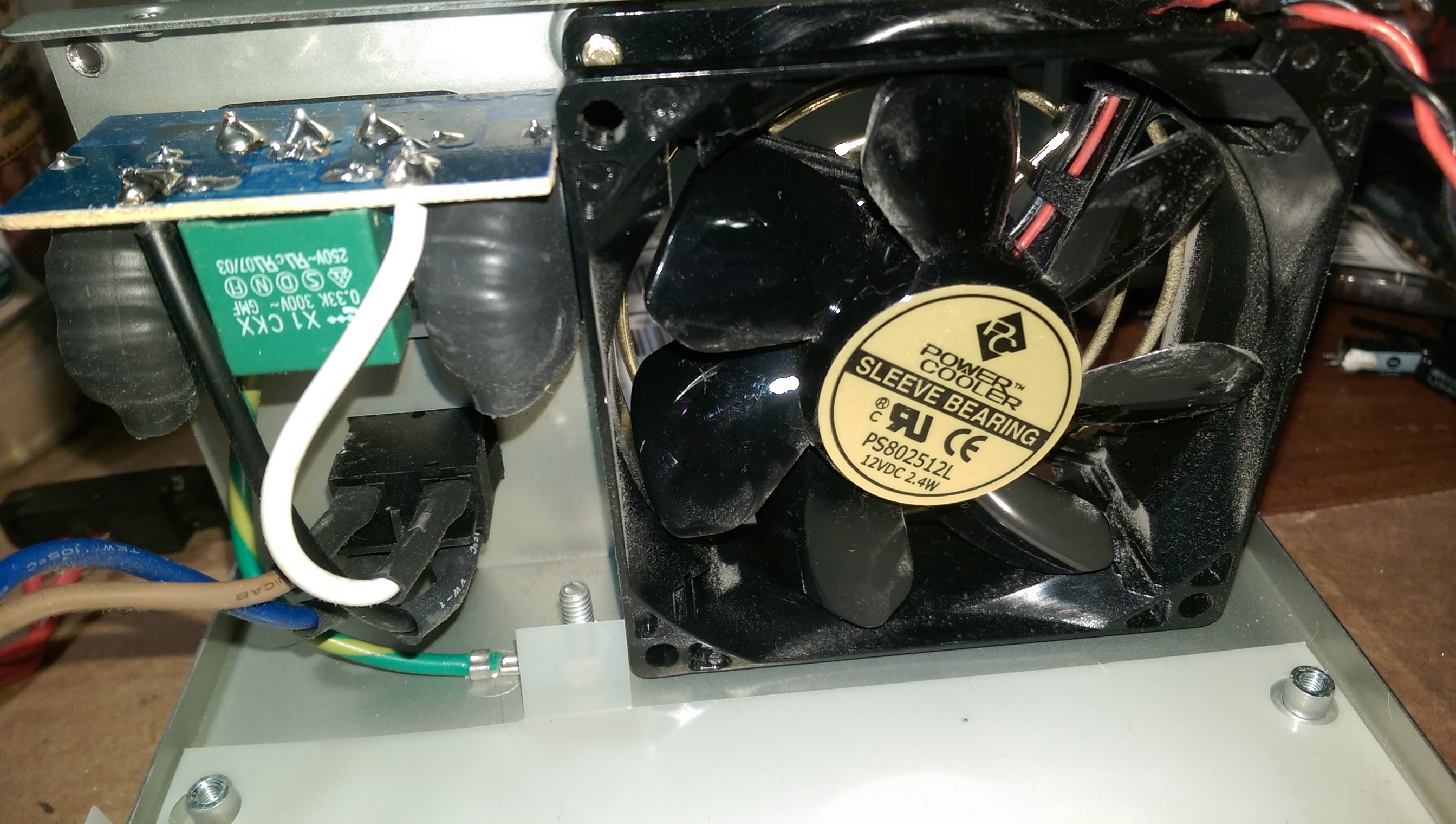

    The sleeve bearing fans surprisingly had grease left in them. I still added a drop of oil to them.
    This thing is currently powering my room's HTPC. It had a recapped Corsair CX430, which I pulled to put in a gaming rig I am building. This PSU only has two 10A ultra fasts on the 12V but it doesn't have to power much. Just a Pentium 4 661 (3.60GHz) 65W TDP version (D0) 4GB RAM, single HDD, fanless Radeon HD 4670.
    I will post some of the cap information later, because it is somewhat interesting

    After working on it. While streaming 720p video, the 12V rail sits at 11.97V

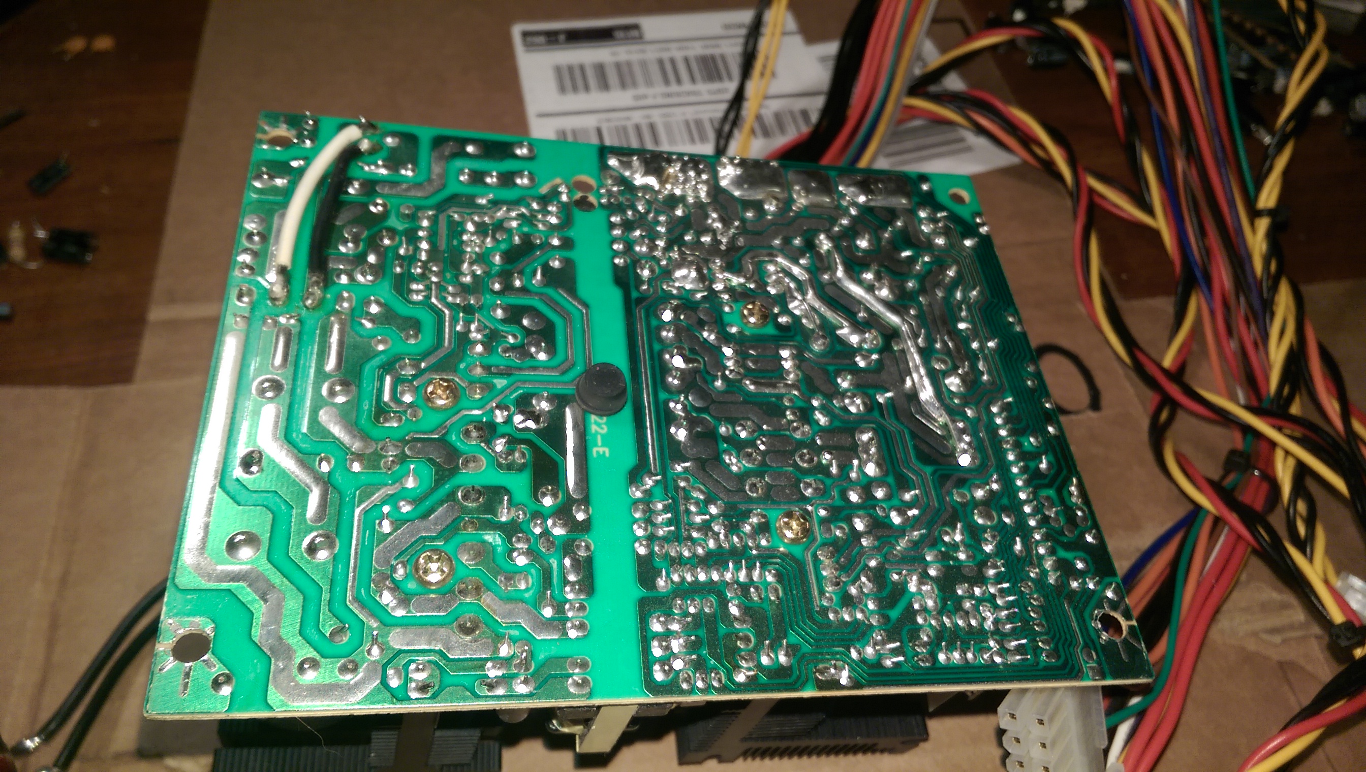

        That conductive glue is more appalling than the blown capacitors.

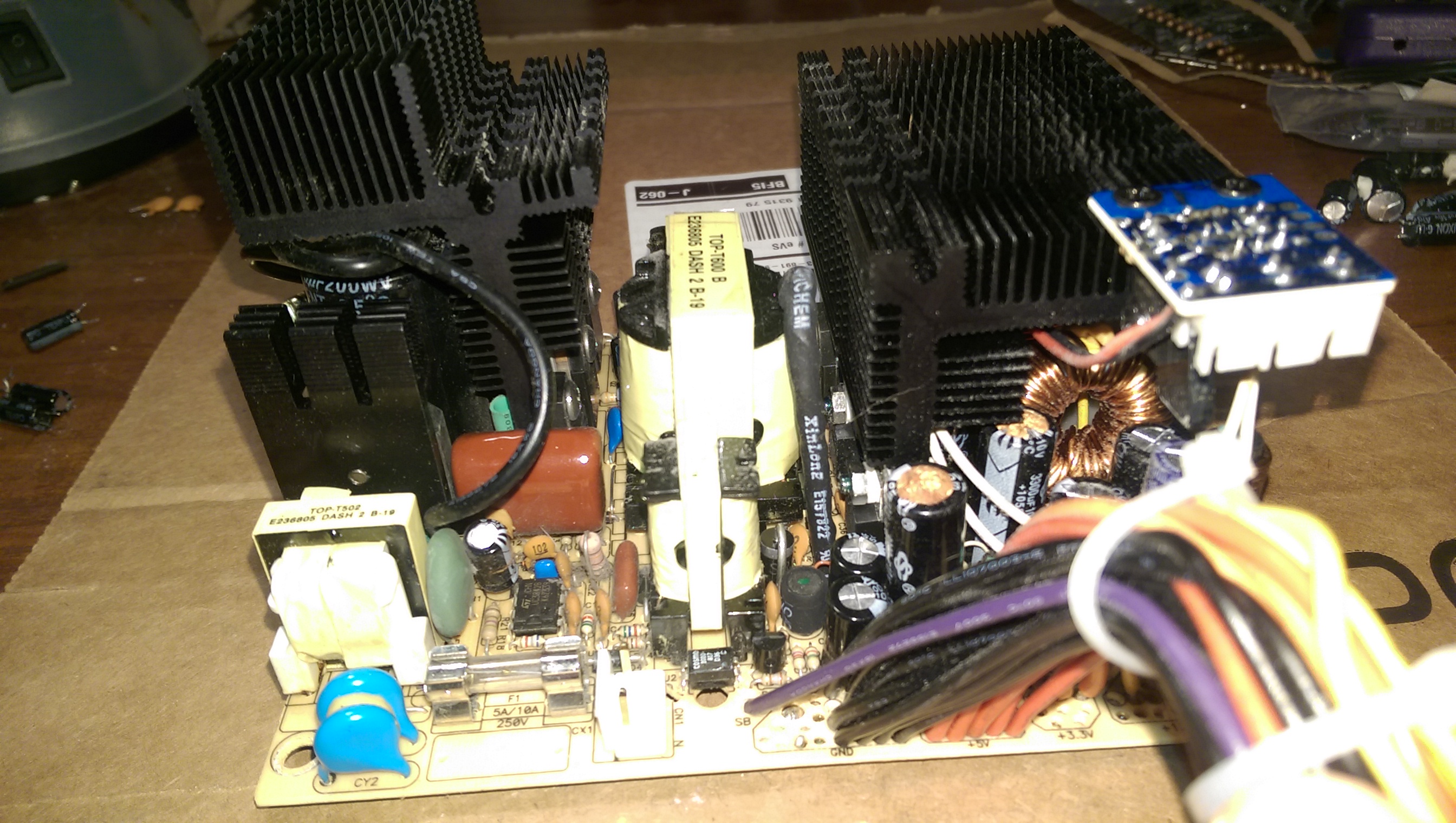

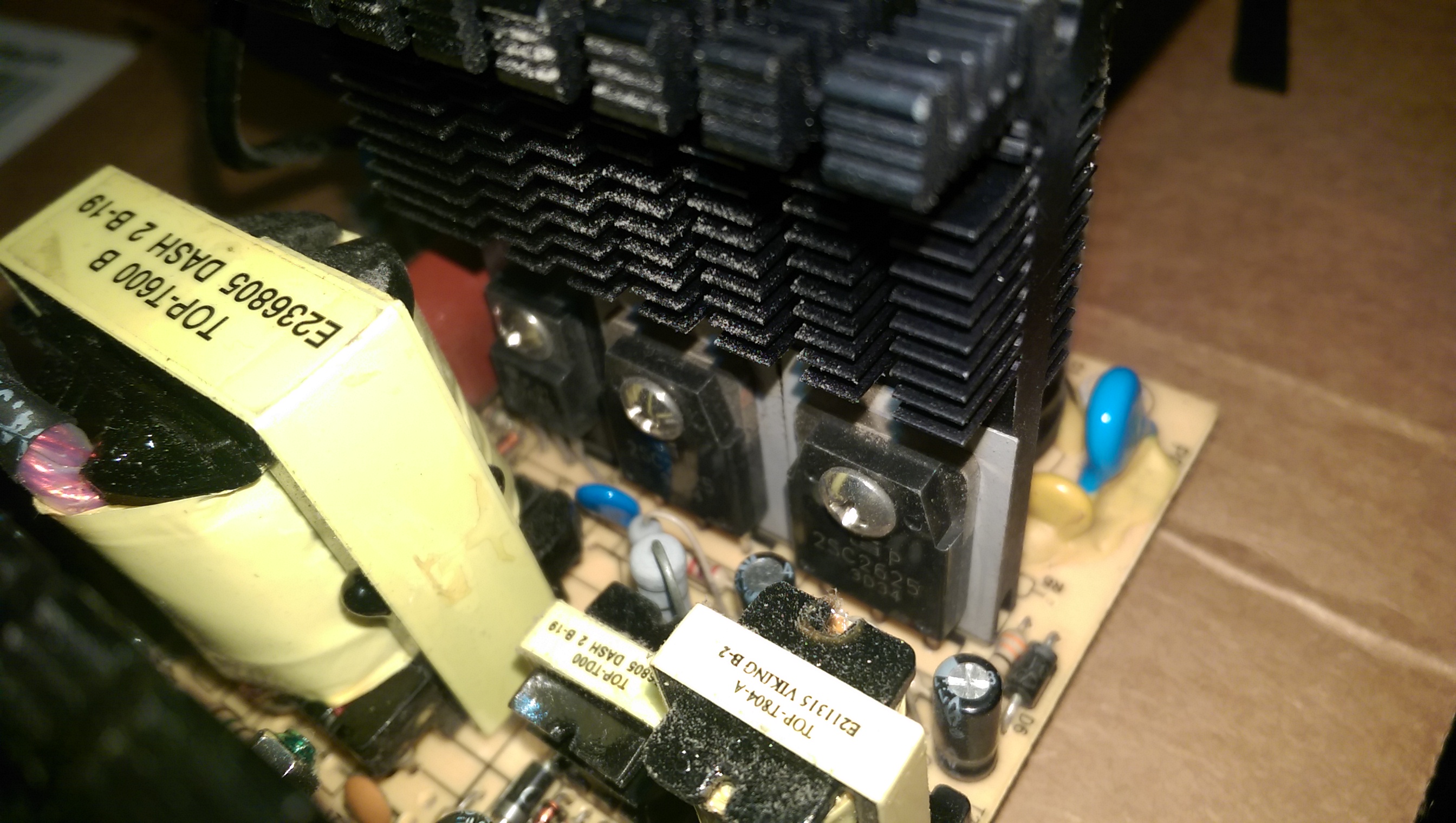

        I'm not sure if it's capable of 350W with those 2SC2625 bipolar transistors and only two 10A ultrafasts (but it looks like they're mounted next to one another rather than on opposite ends of the heatsink, which means they are more likely to be capable of 20A). Possibly 300W. I don't like that the primary heatsink is touching the primary capacitors (the primary heatsink can dissipate some heat in half-bridge topology), and that the secondary side isn't receiving much airflow between the overarching heatsink and that bundle of wires. No surprise the CS capacitors (and what looks to be a lone Fuhjyyu?) gave up, along with the fact that this unit is 12+ years old. The input capacitors in a voltage doubler last even from shoddy brands because A) they are much larger so they can dissipate heat better and dry up slower, as they are impregnated with more electrolyte than smaller caps and have larger seals, B) they aren't really under much stress as they're only smoothing and filtering 100-120Hz ripple and not 50-100KHz+ ripple, and C) the electrolyte is formulated a bit differently in high voltage caps, with a higher concentration of organic solvent rather than H2O so they are less prone to generating H2 (Hydrogen Gas).

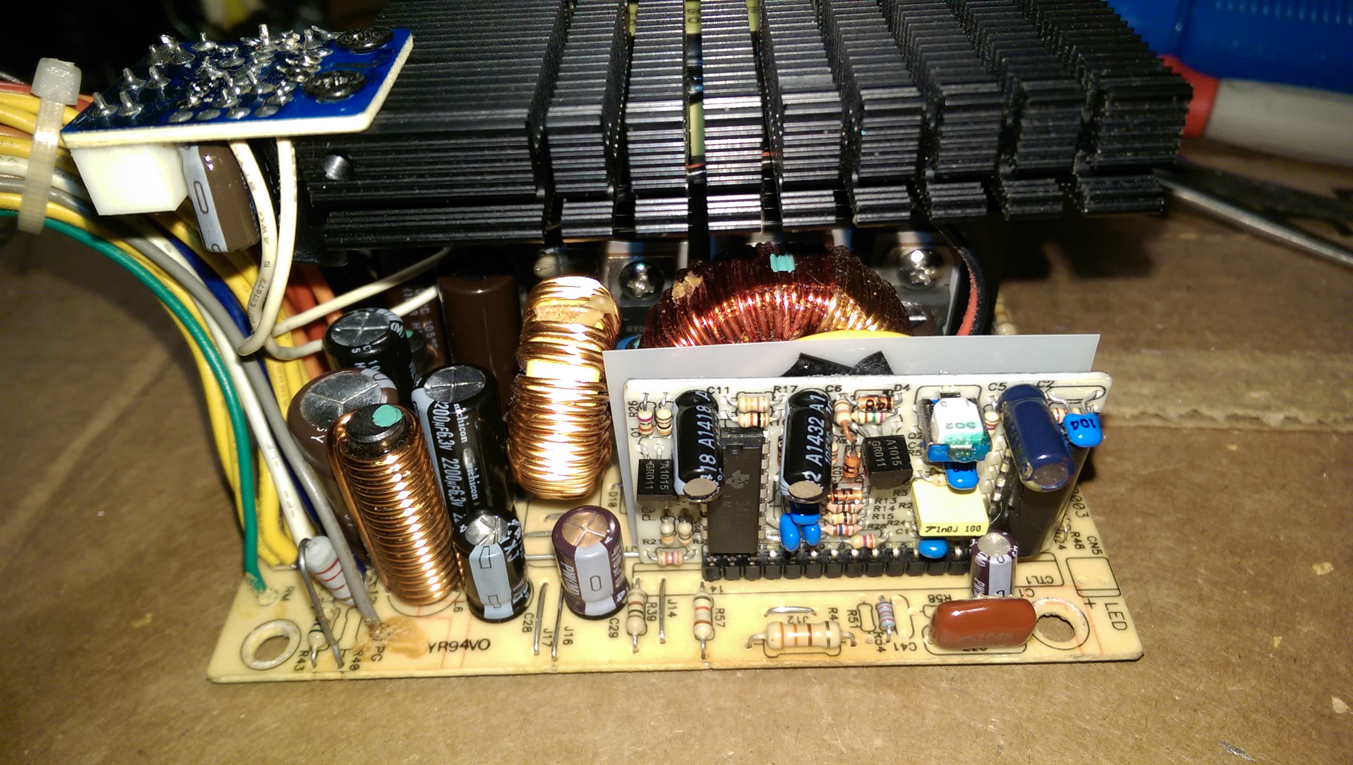

        That's a nice power supply overall, though. Good job on the repair. Interesting how despite that it's a half-bridge PSU, there appears to be a UC3842B IC on the primary side - possibly for +5VSB? Rather than heatsink the bridge rectifier, I think that money could have been better spent elsewhere, possibly on beefier switchers or output rectifiers.
        P.S. I spy with my little eye... bad G-Luxon(?) in the background.

          This thing could easily do 350W. Remember the MPT-301 that c_hegge reviewed? It did 350W with 2SC2625's, with a tiny heatsink! The heatsink in this Topower is huuuuuuge compared to this Macron: http://www.hardwareinsights.com/wp/t...-Power-MPT-301
          I was actually going to put two 16A or 20A rectifiers in this unit but I could not find my bag of rectifiers and figured that the ones it has would be good enough for the application. I'm sure the PSU is super happy with the new caps

              Yeah, the higher mains does help a bit. But those heatsinks could soak up quite a bit of heat. Especially with a fan blowing right over the top of it. The other PSU that c_hegge reviewed which was based on the same design with 2SC3320's managed 500W.
              http://www.hardwareinsights.com/wp/g...saf450-review/
              Ideally though, you would want some beefier 12V silicon. Not sure why they couldn't even spring for two 12A ultra fasts, which would even make a difference.

                  Hahaha, forgot to respond to this. They are indeed G-Luxon, original ones. They were on a Socket 478 motherboard made in early 2004. They had roughly 38,000 hours on them. They tested good but I replaced them with nichicon PW because I am taking the machine up north to my brother to use as a file server. Will be powered by the highest end CWT ISO series I've seen. The G-Luxon tested good by the way.
                  Wow! I think that is the first time I have ever seen APFC in a half bridge PSU that wasn't a piggy back board
                  I will post more pictures, but here are the ones from the 5V rail:
                  I believe "LOW ESR" is false advertising at this point in time

                    They had roughly 38,000 hours on them. They tested good but I replaced them with nichicon PW because I am taking the machine up north to my brother to use as a file server. The G-Luxon tested good by the way.
                    Yes, they tested good. How quaint. What's interesting is that whilst they were still failure prone, I noticed G-Luxon weren't quite as bad after 2000-2002ish. This is a stark contrast to Teapo which have taken a nose drive in quality over time (not that they were ever "good"), in the sense that it's a lot more common to see them blown than silently open after the early 2000s (datecode wise) than it was back in the day. Now, get this... Teapo went down in quality after the acquisition with G-Luxon and G-Luxon went up (although again, neither brand was ever good, still isn't good, and probably will never be good).
                    Or at least a hyperbole of sorts. They were probably on the "higher end" of "Low ESR" (IE general purpose low impedance, if that makes sense) when they were new. Now, of course, they are half blown to hell.
