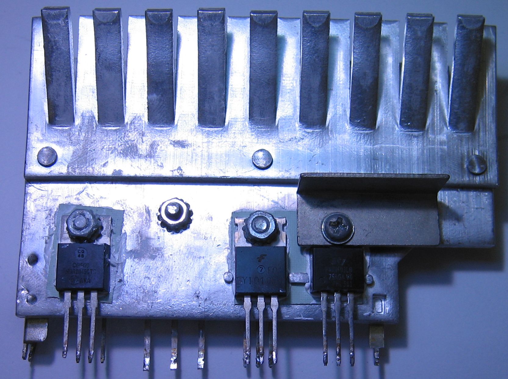

                      Here's an OLD power supply I've had here sitting for a re-cap for quite a few years now, the HiPro HP-P3087F3. It's a very early 24-pin HiPro, predating the more common HP-D3057F3x.
                      When I found this, the fan was completely seized.
                      As you can see by the brown discoloration on the PCB, things got pretty toasty before it was put out of its misery. I wonder if it will even power on after the re-cap. Some rudimentary measurements show no shorts anywhere.
                      Looking at the labeled bag of the original caps, I see mainly OST RLP series and Teapo SC. Both the RLP and SC are bloated, unsurprisingly.
                      I removed the heatsinks along with the transistors so that I could apply some fresh silicone grease... I did a thorough job, removing all the old grease between the pad and heatsink and between the transistor and pad, re-applying a fresh coat for all of them.
                      Please correct my terminology if I err, as I'm still sort of learning how PSUs work.
                      For the primary switcher, we have the STW9NK90Z:
                      On the secondary heatsink, we have the following transistors:
                      1) 2 x MBR2045CT. I assume these are for the dual 12V rails?
                      2) FYP1010DN (Not sure what this is for)
                      3) STP40NF03L (3.3V rail?)
                      4) STPS20H100C (Not sure what this is for)
                      5) STPS3045CW (5V Rail?)

                        That's a good power supply, mockingbird.
                        Not surprised to find the fan seized. ADDA sleeve bearing fans bear great notoriety for lacking the proper lubricant from the factory, but once oiled and maintenanced well, they're excellent and quiet fans. Nor am I surprised that the Teapo SCs and OST RLPs (especially the former) bloated when the fan seized long enough to cause that amount of discoloration to the PCB.
                        The two MBR2045CTs are actually for +5V rectification. The dual +12V rails are separated by way of the OCP shunts on the output. STPS3045CW is the +3.3V rectifier and STP40NF03L is the MOSFET that linear regulates the input (whatever that is) down to +3.3V. Being on the output of a forward converter, the FYP1010DN handles the pulses from the transformer and the STPS20H100CT is responsible for freewheeling. Yeah, it looks like Hipro used two capacitors in parallel for the +12V rail in lieu of a capacitor-input filter.
                            Thanks for clearing that up and helping me to learn.
