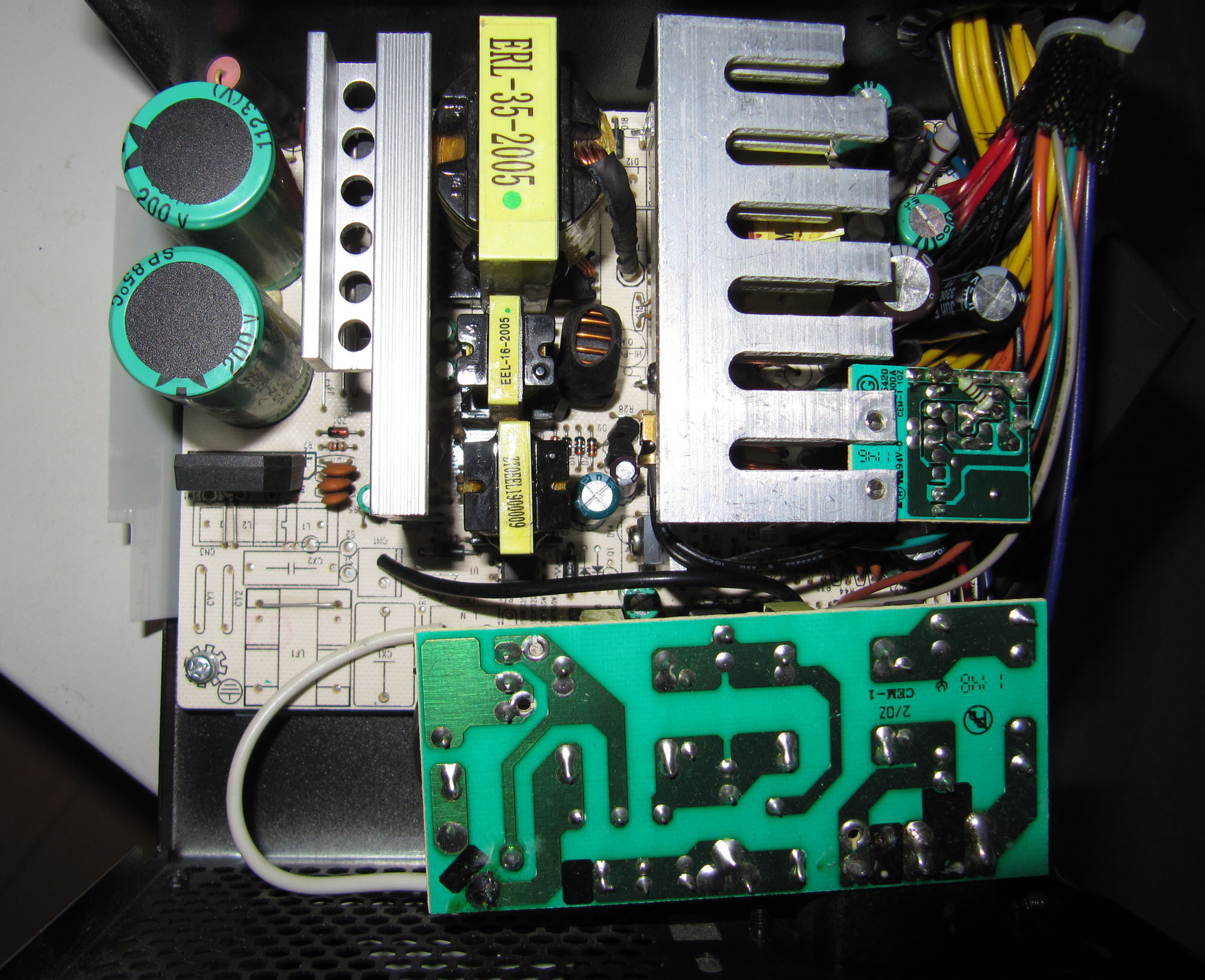

          TurboX 650W (DR-8600BTX)
          This is actually a decent 350W continuous 400W peal (maybe) power supply. Unfortunately the label claims it is an 650W unit.
          The fan is Globe fan sleeve bearing. Not seized, probably because it is thermally controlled with an add on board mounted on the secondary heatsink.
          It is a PPFC unit. The Passive PFC coil is not fake.
          All the input filtering is on an extra board. It includes:
          2 common mode chokes
          4 Y caps
          2 X caps
          sleeved thermistor
          fuse
          There are also 2 varistors near the primary caps.
          The primary capacitors are ANODIA 680uF, their real capacity was measured 650uF and 670uF. That's good.
          The 4A bridge rectifier is more than enough for 230V mains.
          The main transformer is real ERL 35 and the 5vsb transformer is 19 size.
          The main switching transistors are 2x D209L, actually better than 13009 and they come in a nice TO-3P package.
          I was surprised to see that the 5vsb uses a DL0165R IC and not the 2 switching flyback circuit.
          The output is rectified with SB5A60F that is bolted on secondary heatsink. I couldn't find a datasheet, but it seems to be a 5A 60V diode. Nice!
          PWM controller/supervisor combo IC is 2012 ATX chip of the year. No pdf available online
          The soldering looks quite good. There was plastic insulation bellow the PCB.
          3.3V and 5V use schottky rectifier SB3045ST.
          12V uses SBL3060PT schottky rectifier with 0.7V voltage drop.
          There are pi coils installed on every output rail but not -12V.
          -12V rail caps:
          470uF 16V yc (saturn)
          5vsb: 2x1000uF 10V yc (saturn) LE
          3.3V: 2x2200uF 10V yc (saturn) LE
          5V: 2x2200uF 10V yc (saturn) LE
          12V: 2x1000uF 16V yc (saturn) LE
          The heatsinks are thick and have fins, I think they are good for 350W or 400W for some seconds.
          I am going to do a partial recap, oil the fan and check the fan controller.
            Ha! Yeah, this ain't no 650W unit FOR SURE!
            Heck, I think even 350W continuous might a be a bit too much. Firstly, it's got a 35 mm core main transformer, so that's an automatic 300-350 Watt limitation for an old half-bridge with a slow switching frequency. The output filtering with those 1000 uF caps is also inadequate for anything more. Likewise, the primary caps being 680 uF is also probably a limitation to about 350 Watts before the hold-up time drops too low.
            If that's not convincing, I acquired a very similar Allied from nearly the same time period ("2012" PWM chip, and almost identical output filtering stage). I got it because it is blown - both the primary BJTs and the fuse. From the information I remember getting about it, that PSU was powering a fairly new i5 or i7 system with an AMD R9 290 or similarly power-hungry GPU. My guess would be the 12V rail for that system was probably peaking at 300-350 Watts (which you can say was probably the power consumption for the entire system) - and yet the PSU blew. So I'll stick with my guess that this is a 300W PSU with *maybe* 350W peak in its "reserve".
            But for a more basic PC, this would be plenty. The 12V rectifier was rated for 30 Amps IIRC, but I'll check. Heck, I have pictures of it. I'll see if I can post it later / in a few days.

              I tested the Turbo X power supply in a Pentium 4 3GHZ HT, 2 hdd drivers and Geforce 6600 PCI-E. I disconnected case fans and ran IBT + Furmark for more than an hour. The psu got warm but not hot at all. According to my online UPS I use to estimate watts of connected devices, it drew 210W.
              Partial Recap
              12V:
              I replaced 1000uF caps with 1x 2200uF 16V Nichicon and 1x 3300uF 16V JunFu WG.
              5vsb:
              I also replaced 5vsb YC caps with better quality parts.
              Fan mod
              9.13kohm resistor in parallel with the thermistor
              Psu remains silent without getting hot even when PC case cooling is intentionally compromised.
              Minimum load resistors
              Original --> New
              3.3V: 15ohm (~0.75W) --> 27ohm taken from 5V (~0.43W)
              5vsb: no minimum load resistor used
              5V: 27ohm (~0.926W) --> 120ohm taken from 12V (~0.22W)
              12V: 120ohm (~1.2W) --> 240ohm (~0.62W)
              -12V: 390ohm (~0.37W) --> no change
              Finally, I oiled the fan with original Singer sewing machine oil.
              Pics attached

                Might be worth replacing the secondary rectifiers as well. I replaced the 5v one with a 16A rectifier and the 3.3 with a 20A rectifier, as well as the 12v rectifier with a 20A 60v part. Now it's powering a 2.8GHz Northwood just fine, and the air that comes out of it isn't really hot. (just warm).
                    All the secondary rectifiers are Schottky 30A with low forward voltage drop
                      Yup, I don't see why goodpsusearch would replace them with 20 Amp ones.
                      Dan, I think you're too used to seeing 10A/15A rectifiers in those low-end L&C PSUs - they are skewing your expectations , man.

                                      Have I posted these ones?
                                      Controller seems to be a PIC - so some kind of Digitally controlled thing...
                                      Have no idea how that thing works...
                                      And it seems to regulate every voltage independently with its own transformer?!
                                        I don't remember if you posted it or not, but I do recall seeing something similar a very long time ago.
                                        It's a very strange design, indeed. Looks almost like each rail is mag-amp regulated, or something like that. But who knows. In any case, I would NOT want to try to troubleshoot that if something went wrong with it. Granted, at least I see lots of through-hole resistors there, so looks like there may not be that many SMD parts (if any?). That will certainly make troubleshooting easier, but not by much, simply due to the complexity of this PSU.
