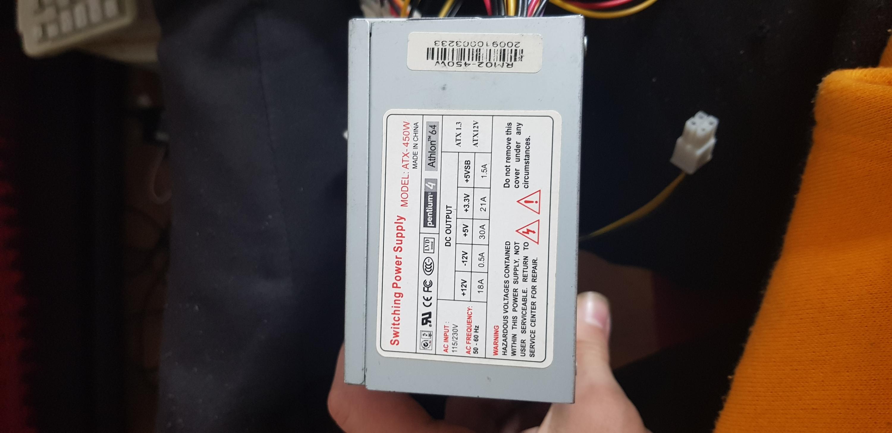

                        No. Just NO.

                            Re: the gutless, bloated, and fried power supply hall of shame
                            Originally posted by Dan81 View Post
                            This has to be one of the lamest attempts for a PC PSUs I've seen. Sure it's only an AT power supply and AT PCs weren't exactly known for their high power draw. But still... this is lame.
                            Originally posted by TechGeek View Post
                            L&C - Laughable & Crappy
                            Truly!
                            Or you could go with Lame & Crappy.
                            Either way, it's garbage.
                            That said, I'd still keep that PSU - for spare parts. If I were to keep it though, it would look a lot more like this after I am "done" with it:
                              No. Just NO.
                              Oof. Just four diodes instead of a rectifier.
                              Edit: What PSU brand is that? Raidmax?
                                ASIC LC-200C. So technically a Deer/L&C, and it's AT.
                                Just for ÃœBER laugh material, I'll actually take my time and upgrade it accordingly. Heck, I might still have some leftover parts from upgraded ATX L&C and Allied units.

                                          Sorry for not getting back at y'all in the first place, and now with some answers:
                                          30A on the 5v rail - I know it's a utter lie. I'd have to replace the rectifier and filtering cap (despite being a genuine Rubycon)
                                          Ripple? Would probably be high, but hey, it's a K6-2+ 500 we're talking about, not some advanced P4 or i3. Adding to that the fact that the mobo is also recapped with 1500uF 6.3v MBZs for the CPU side and 16v 1800uF for the RAM regulator since that LT1083 clone it uses gets horribly hot. No, it isn't broken, it's just running finger-burning hot in normal operation.
                                          The whole config consists of this: 40GB Maxtor Fireball III 2F040J0, Geforce 2 Pro 64MB, 384MB RAM, an K6-2+ 500MHz, Realtek RTL8169SC NIC, Yamaha YMF-719 ISA soundcard, VIA VT6212 PCI USB2.0 card, all running on 98SE.
                                          Secondary caps - yes, I have replaced the puny ChengX caps in there for good measure. This little box came to me with a partially seized fan (it was grinding horribly and lubing it up didn't help either) which I eventually replaced, as well as crappy "1500uF 16v" ChengX caps that were probably 220uF max. I used some Rubycons recycled from a dead mobo (don't exactly remember what socket it was, but it was newer than PGA370).
                                          Main caps - AFAIK this isn't the first time I've seen the OEM use those Yongxing VZ fakes. Yes, the OEM (which at first I mistook for Codegen in an normal ATX PSU they built, but then figured it's some generic chinese OEM as the PWM chip (CG8002 ) didn't match up anything I'd be familiar with.) is notorious for using those crappy Yongxing caps in the primary. Unfortunately, I don't think I can find suitable replacements mainly because of the form factor it uses which doesn't allow me to just drop in some Yang Chung (Saturn) caps from Deers - at least those are less crappy (about as good as CapXon, which, while crappy, is at least better than using Fuhjyyu or Yongxing primaries.)
                                          Topcat & Per Hannson - yes, it is that gutless. I already replaced the PCB with another AT PSU (an Essun 200W, which, while still uses the diodes-on-a-bracket for 12V, has much better construction than this crappy Deer.) and the machine it's powering (a 533MHz Mendocino Celeron on a PCChips M726MRT, which is a surprisingly rock solid board with no issues whatsoever - as rock stable as my Zida LX98-AT 440LX mobo, actually.) is running crash-free last time I powered it up.
