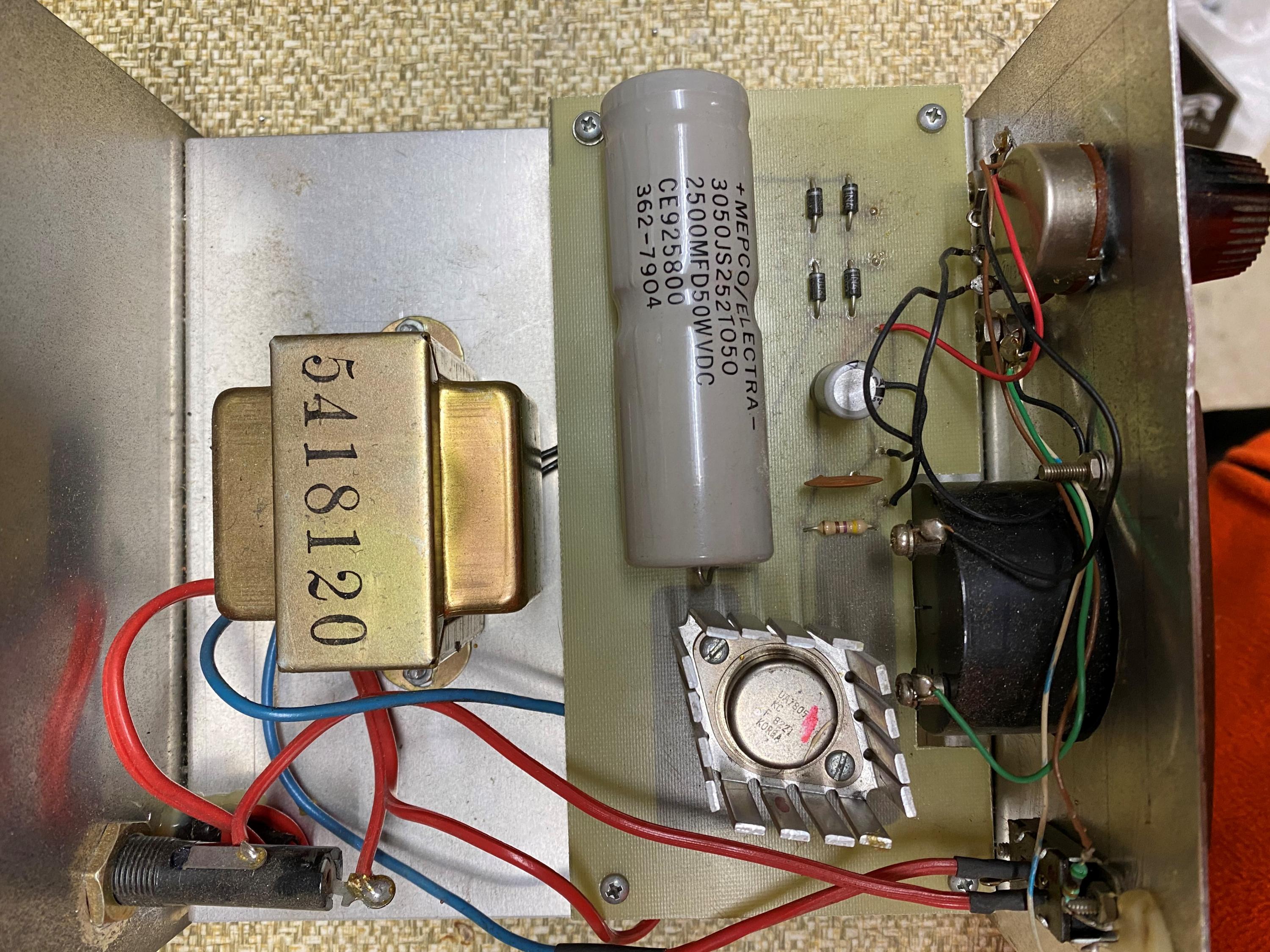

    I have had this old bench power supply which I have decided to look into repairing. I have no idea where it came from.
    Attached is a picture. I cannot find much information on it to even figure out what it is rated for. The analog display goes to 25V, but the voltage regulator chip is rated for 5V (UA7805 - KC - F 8221 - Korea). The cap is rated a 100uf 50V. There is noting on the bottom but some traces. Pretty much what is seen is what is there.
    Any insights into testing? Capability?

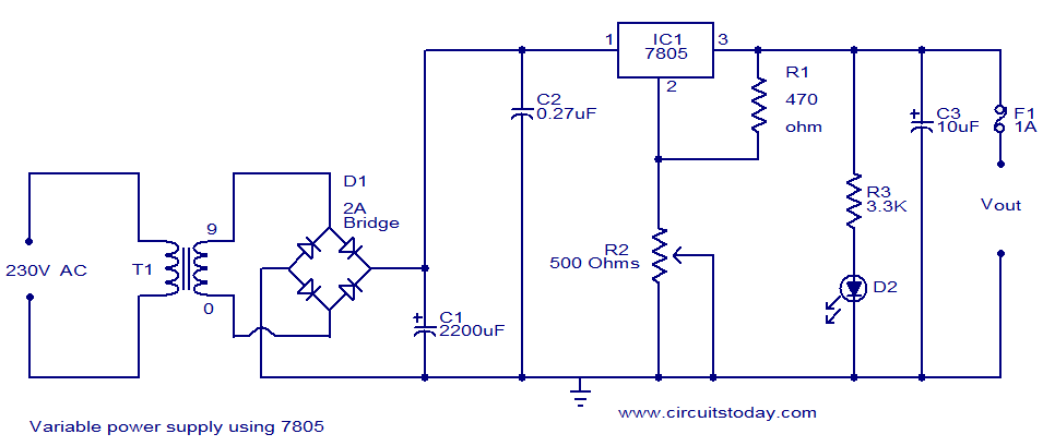

    The control is used to vary the ground of the 7805 so the output voltage will vary from +5v to something higher 12~20v
    There looks like a burnt resistor above the switch? or is it just a black shadow?
    Something like this: The component values are different but it shows the general idea of how it works.

      Thanks RJ - sounds like it may be worth some attention. I measured the transformer output and it is 25V a/c. Diodes seem to check out.
      Any suggestions on testing the UA7805? Can it be done on board or should I remove it?

        It was a trick to make a fixed voltage regulator IC adjustable by putting a pot in series with its GND pin. So you could get 5-30V depending on the transformer voltage. It has a 50V filter cap, IC is 35V in max. Similar schematic below.
        For the size of this, it needs much better heatsinking something I would add to the back panel. It won't make 1A for long without heating up too much.
        If the IC has failed, I would convert it to use a LM317 on a heatsink at the back.
        Why is the resistor burned on the brown wire?

          Just measure the voltages, the regulator should have around +35v input and the output should vary depending on the position of the control, (you can also check the ground pin voltage on the ic) The output of the regulator should ajust from +5v to around +30v If it does not, the regulator ic is likely bad.
          The burnt resistor looks like it is the current limiter for the led?

            RJ - The regulator reads about 30V on one leg and nothing on the other, regardless of where the pot is set. So the 7805 is dead.
            The browned resistor is for an LED and is working.
            I will look into the LM317 conversion - Redwire I assume you are talking a regulator with three legs vs this current through the board 2 leg setup. Any recommendation of wire gauge? I figure I could pull the 7805 and solder jumper wires in the existing holes and run it to the back per your suggestion.

              Do you measure any voltage on the output? If you get 0 volts the regulator must be open internally

                RJ- No voltage on the output.
                I put the ground of my VOM on the heatsink and poked the probe under the board. One leg read 30V and the other gave no reading.

                  It could be that the ground circuit is open, check the resistance between the large capacitor negative and the regulator common(can/heatsink) then vary the control and see what resistance you measure. The pot might be open?

                      RJ - I performed the test. VOM negative to heatsink and VOM positive to negative leg of the gray vertical 100uf 50v cap. As I turned the pot the resistance would increase and decrease.
                      I did the same for the really big 25000MFD cap and the resistance would vary, but not in a linear fashion.
