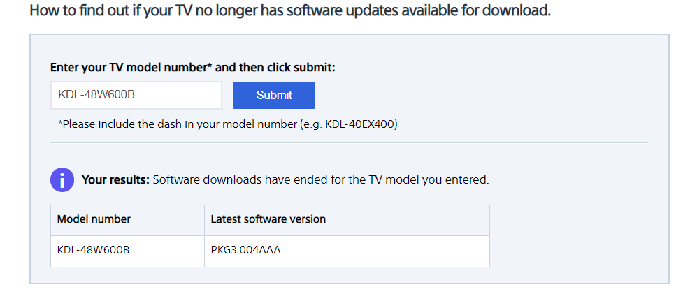

Need firmware for Sony KDL-48W600B
  • JohnCT
    Lurker
    • Apr 2018
    • 32
    • US
    Sony apparently deleted this from their support page.. Thanks.
    John

        I'm also looking for the file that works with flash drive. The only file around in the internet is 221Mb with extension BIN and it doesn't work. Does ANYONE have the file - FIRMWARE - SOFTWARE UPDATE?

          Latest software version PKG3.004AAA.
          In the root directory of the usb flash drive there should be a folder named sony_dtv0FA40A06A0A6_00003301, and in the bin folder there should be a file, and not all flash drives will pick up the update, look for old flash drives of 1-2Gb.
          https://drive.google.com/file/d/1G21...DOBaTW/view​

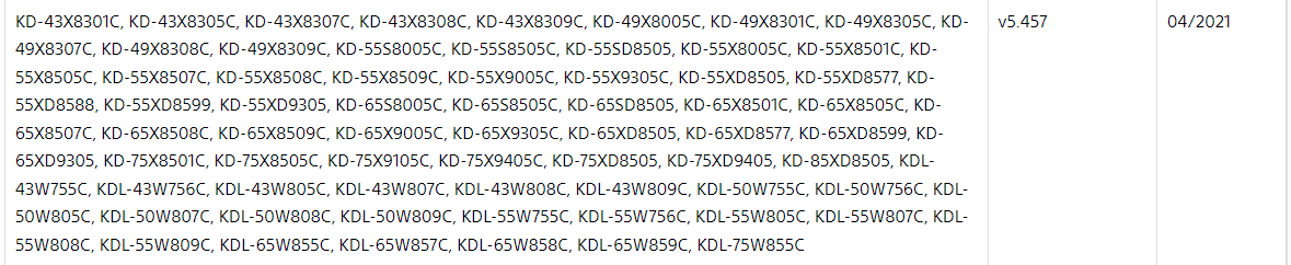

              Yeah, I have same problem with my KDL-50W756C. The Sony v5.457 software has been terminated on Sony website. Any chance someone may have that FW to share ?
              • lotas
                • Jan 2016
                • 4804
                • Russia
                v5.457
                https://disk.yandex.ru/d/Tau0sq1P2s-rOg

                  Originally posted by lotas
                  Hi!
                  I am trying to update the firmware of my Sony KDL-40W808C to v5.457, the last published by Sony but not available any more from their site.
                  I have tried your file with different USB drives. It detects the drive has a firmware update file but it keeps saying something like "I cannot update from that USB drive".
                  Should I try yet another USB drive? Or may be it is not the right file? Is there a file specific to my model?
                  Thanks in advance.
                  jorge.

                      I have two firmware versions: sony_tvupdate_2015_5457_eua_auth and sony_tvupdate_2015_5457_eub_auth. Which one do you have? There's no 40-inch version in this series, maybe a 43-inch version?
                      • jjchico
                        • Sep 2025
                        • 3
                        • Spain
                        Hi!
                        Thanks for your prompt replay. It is the KDL-50W808C, sorry.
                        I was able to download sony_tvupdate_2015_5457_eua_auth.zip from:
                        https://tv.update.sony.net/OND/0000/...7_eua_auth.zip
                        and it worked. "...eub..." did not work.
                        So I confirm the firmware in the link works for the KDL-50W808C, and probably many others in this series.
                        1. Unzip file.
                        2. Copy the .pkg file to the root of a FAT32 formatted pen drive.
                        3. Insert the pen drive into any TV's USB port.
                        4. The update should start, if not, unplug and plug your TV while your
                        pen drive is in.
                        Best!
