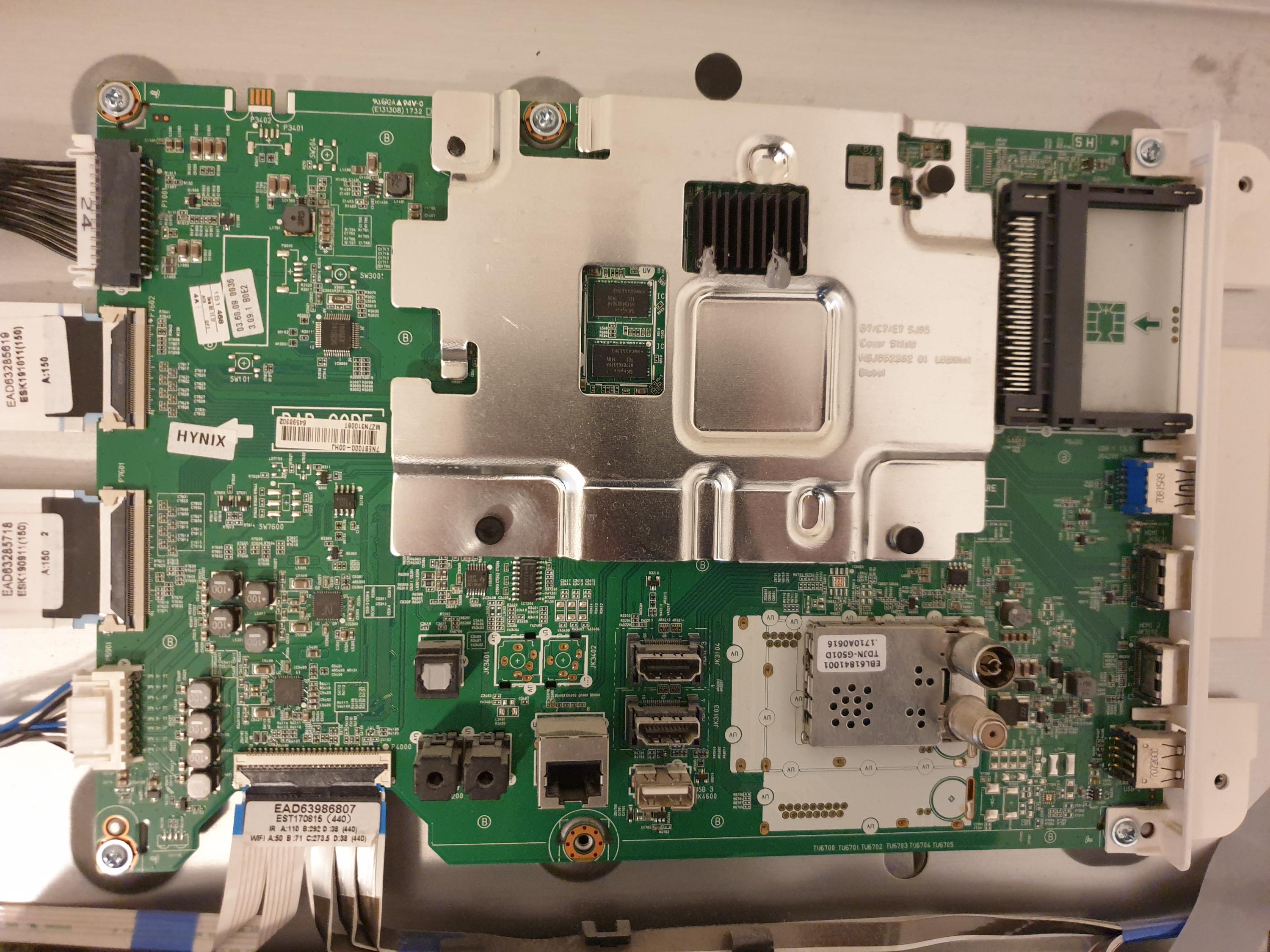

    Hello all
    My first post here.
    I have a LG OLED 55b7v which suddenly getting problem with no video.

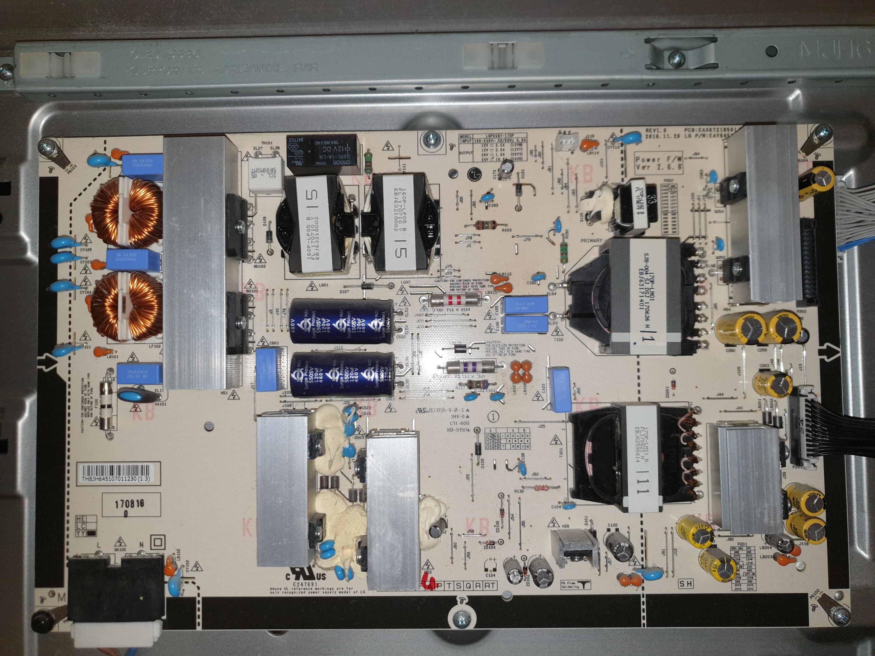

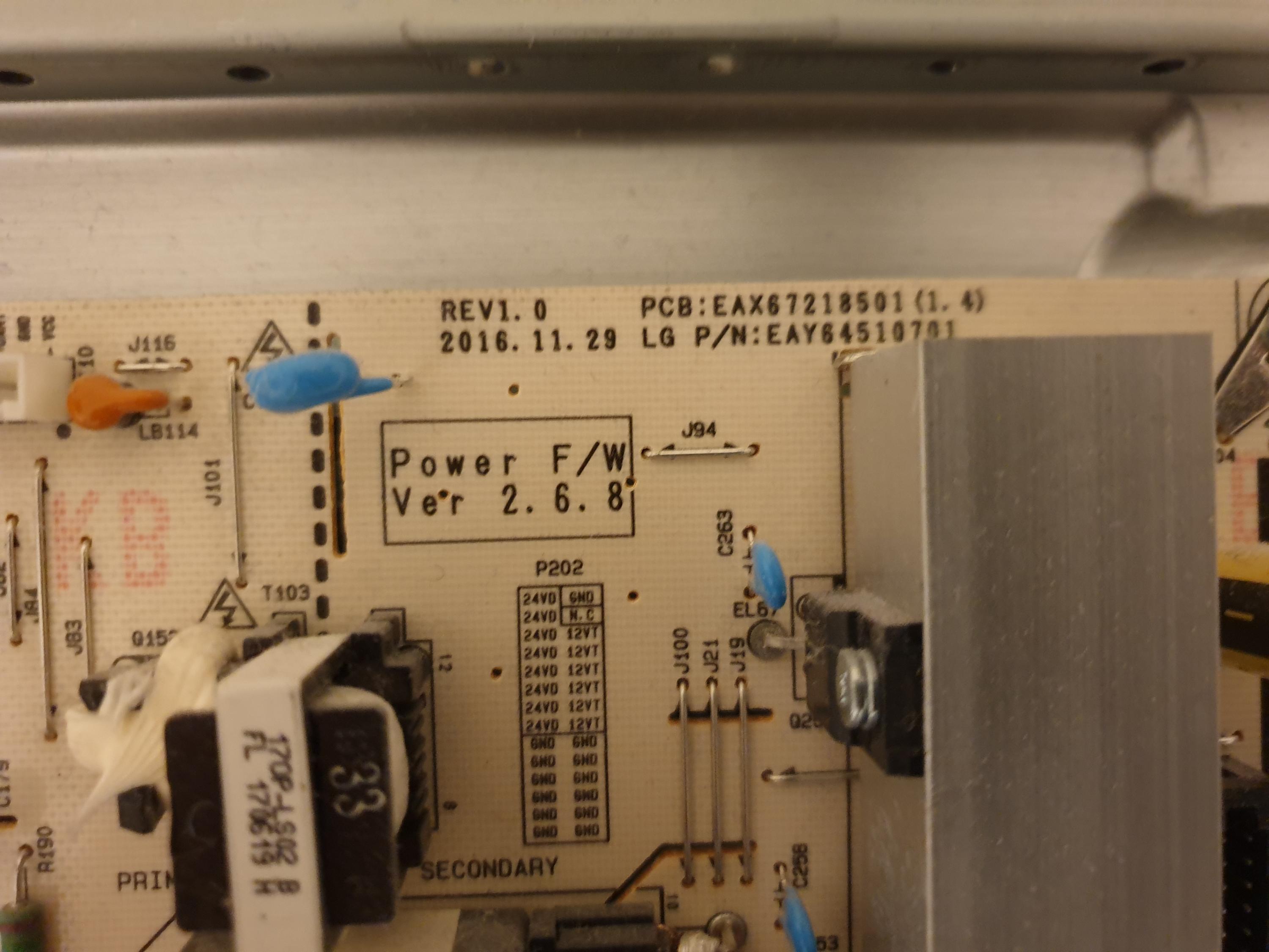

    I have opend the TV up and found that the 24 v is missing on the output from the Power board.
    I have seen alot of posts related to similar problems but my Tv seems to behaves a little bit different
    I can turn the TV on via the remote and the TV starts to consume about 55 W but nothing happend. I can also turn it off via the remote via the remote.
    The Tv stays on when I turn it on. I cant see any red light from the optical output.
    As far as I can can mearure all outputs to the main board seems to be correct.
    Anyone having any ides how to resume the trouble shoooting .
    Isssues with powerboard, mainboard or Tcon card?? I do hope someone having any clue how to solve the problem. Anyone knowing common issues with those boards

        when you disconnect the 24V socket from T-CON side... you need to measure the 24V on power boards if it exist or not... if not you need first to take the power boards out and test it as stand alone to be sure it supply all needed voltage.

            its okay... only you dont have DRV_ON which are responsible to turn on the 24V line.
            so if you want to check this 24V. you need just plug out the cable ( single wire ) from the socket 201 of DRV_ON .. and feed the pin of DRV_ON 3.5 V from PWR_ON ( 3.5V ) then turn on if the line 24V okay... it will exist.. and the screen will turn on too .... in case the screen had issue for example you can see it too.

                  When looping the 3,5 V from pwr_on to drv_on I got 24V from the powerboard so quite sure the powerboard is ok.

                    you have issue at 5V line on MB which it go to front LED wifi / BT. you need to check for short first at those module or terminated them one by one from system. then check.....
                    BTW i wrote before... disconnect the both LVDS and check
                    • nicke74
                      • Mar 2023
                      • 16
                      • sweden
                      Re: LG OLED 55b7v No video
                      I can add that the panel was replaced by LG due to burnt in issues just two year ago so it is a quite new panel. Ofcourse it could be broken .
                      Now I also tried to disconnect all cables between the T-con board and my mainboard and still no power to usb or optical output..
                      Is t possible to reset the main board sw in some way incase it went into some bad state?

                                  Hmm, I have performed some measurments . It does not seem to be any shortcut to ground , atleast nothing I found but still no 5V power on the board
                                  I have verified bot 12v and 20 v incoming on the board.
                                  Anymore advise what to check or do I need a new mothercard?

                                        Originally posted by nicke74
                                        slightly but I do not think I manage on this level..
                                        Do you know anyone which have the knowledge...
                                        disconnect socket P4000 on the MB.. and plug it in... you need to follow all part with FL name.. measure from both side with reference to TV chassis
                                        any strange reading marked it on photo to the part section and upload here.
