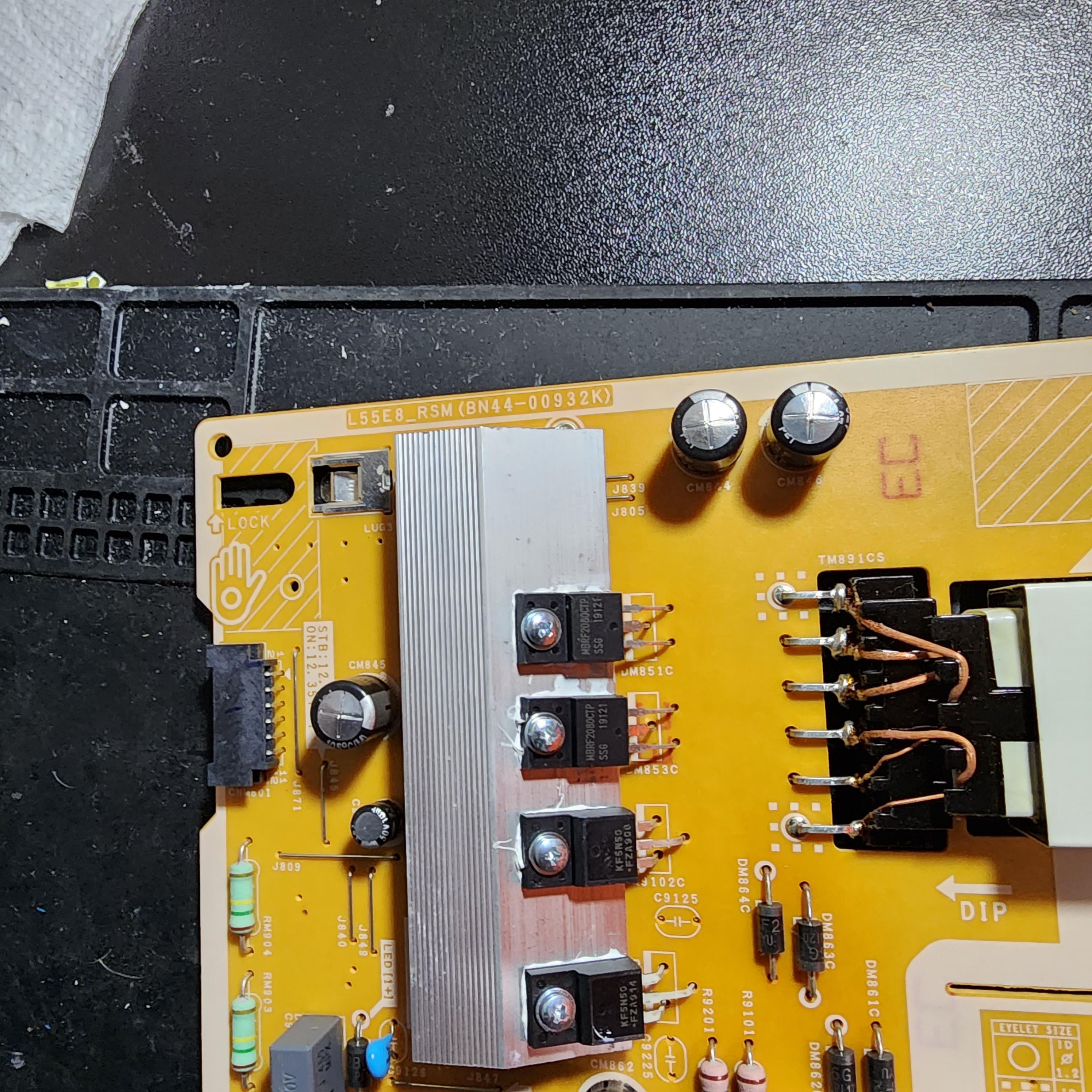

but ive been burned here before just recently on a samsung tv where i replaced the power supply but still no backlights even tho i tested them ok with my tester. so i have to point out any areas of doubt:
