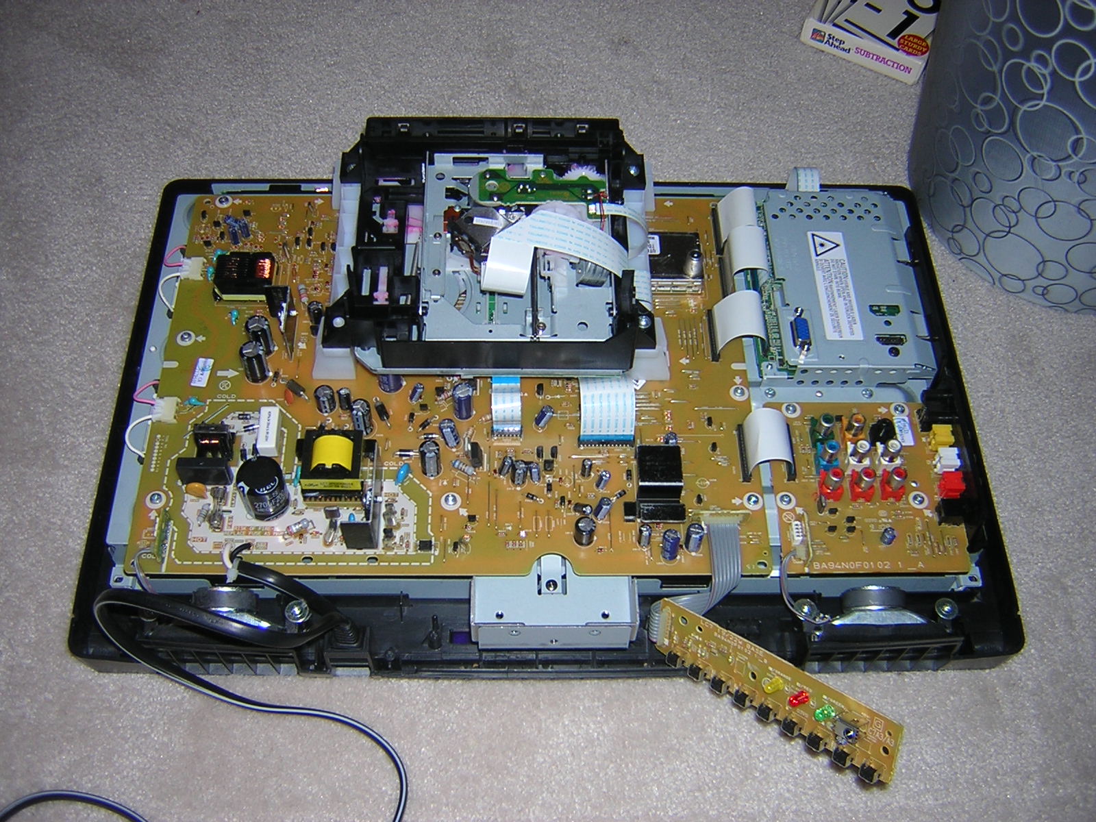

    I have an Emerson TV Model LD195EMX. When you plug the unit it it shows some text on the screen (shows the text "Digital Television) and then it begins a loop showing a red screen, blue screen, green screen, white screen...........and it just keeps doing this.
    I am not a TV repair person......but i have worked on a few LCD monitors but i am not an expert.
    Note: Dont know if this is helpful or not but the "on/off" button does not seem to work. WHen i plug unit in it is "already" on and when i try to turn it off with the on/off switch it has no effect.
    Note: I found a troubleshooting manual for this unit online but i am not sure how to proceed.......since i cant find my symptoms in the manual.
    http://www.tvrepairtips.org/files/ti..._pdf_12349.pdf
    any help will be appreciated.

    the first thing i will try is to unplug the off/on panel, there maybe a short on one or more of the buttons.
    if that doesn't fix the problem I will look into the firmware

        i disconected the on/off switch panel from the tv...........so the on/off, reset, and other functions that are on that control panel are totally removed from the tv..............i then plugged power to the tv and the same thing happens. No change.
        Any other thoughts?

          You're stuck in some kind of service mode. Most likely you have a bad EEPROM, you're going to need to reflash it. Equipment to do that isn't exactly cheap - for a one-off better look if anyone is selling preprogrammed chips.

            I very quickly read through the service manual link you provided, it doesn't describe your problem exactly but it does describe a service mode that is accessed with the remote control. There is something in there about removing or cutting a plastic cover on the remote to get to a service button. To exit the service mode they say to power the set off with the remote control.
            If you don't have the original remote you could try to program a universal remote to turn the set off.
            I have no idea if that's the problem your having, or if it will work but it can't hurt to try it.

                  this is how you fix it for anybody having trouble with it... if you have the original remote what you do is you keep the tv on and with the remote u press up and down on the remote controller... not the channel or vol buttons but the ones that control dvds... unplug and replug the tv in and BAM there you go.. i tried it and it worked great... give feedback if it doesnt work and ill try to help you

                    I almost went out to buy a boat and a lake because I had an expensive art device and got an estimate from a local place that advertises Resonable Prices! and asked $175 to replace the main circuit board. They did get my $15 to get an estimate.
                    THANK YOU

                      I had the exact same thing to happen to my tv, exact same model, and i read vampy's message about pressing the up and down buttons on the dvd button section of the remote and it had no effect, but it got me to start pressing other combs. of buttons and found that pressing the left and right buttons in the dvd section of the remote fixed it and got it back to a picture screen, so i got on here and went through making a user name and password just so i could put up a post, so hopefully this helps anyone else who needs it, so if up/down doesnt work try left/right..

                          I would suggest try to use a universal remote .

                            I got mine straight with a Direct TV remote.I just pushed the side to side buttons next to the Select button and it popped back on.
