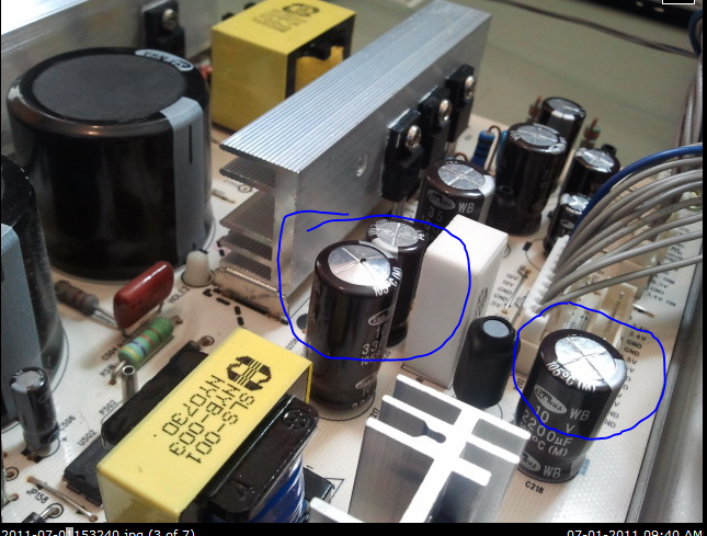

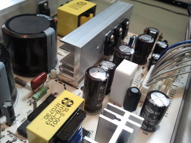

    psu has 1 dodgy capacitor 3300uf 10v, its got i little blacky brown mark on top.

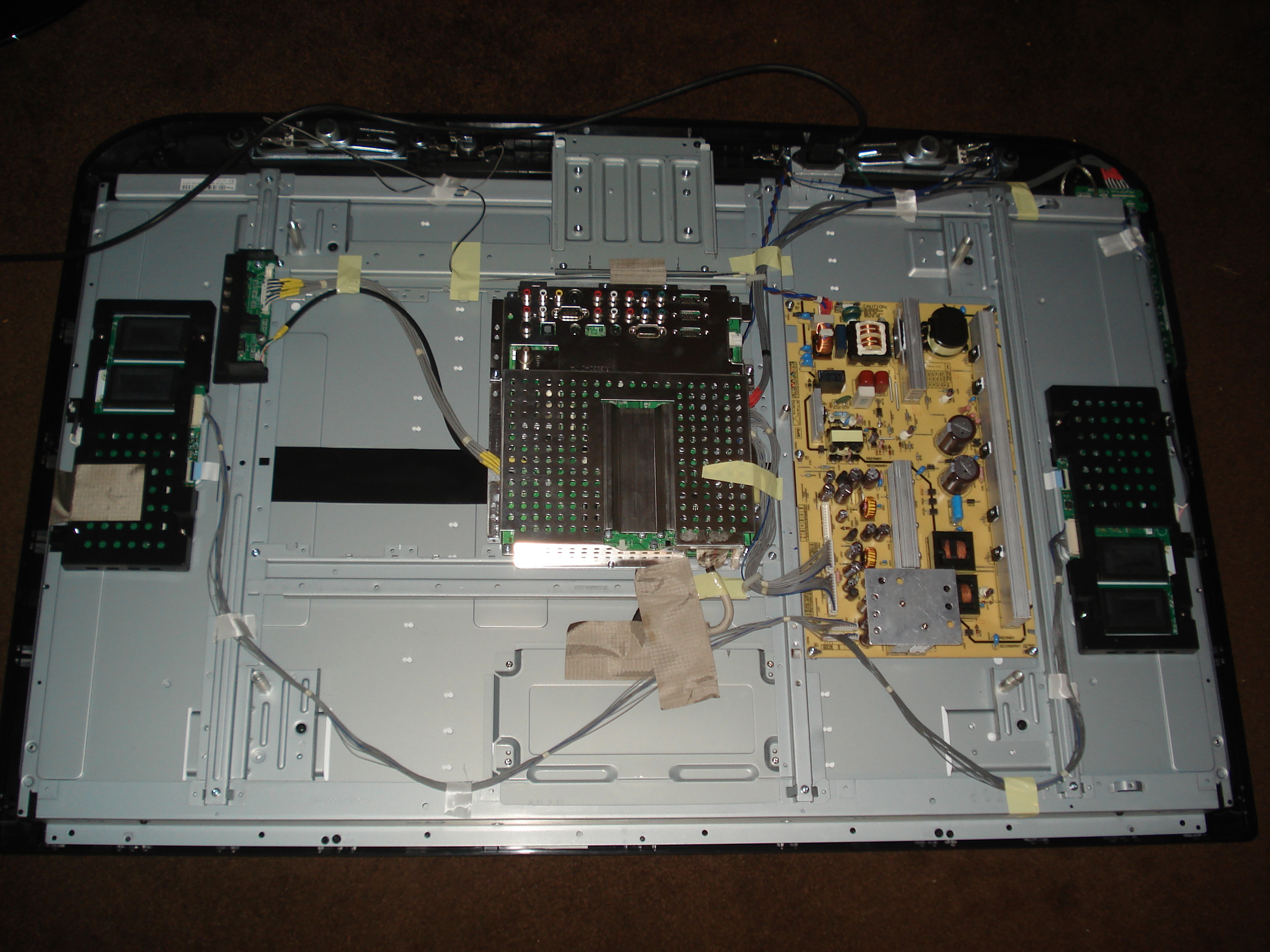

    2 inverters, one either side, they seem to be hidden with the lcd, i havn't seen that before.

      There are no separate inverters the power supply outputs voltage to run the ccfls. Most likely a bad inverter section on the power supply. I had the same problem on a Philips and a new power supply fixed it.

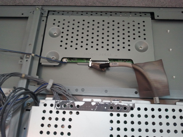

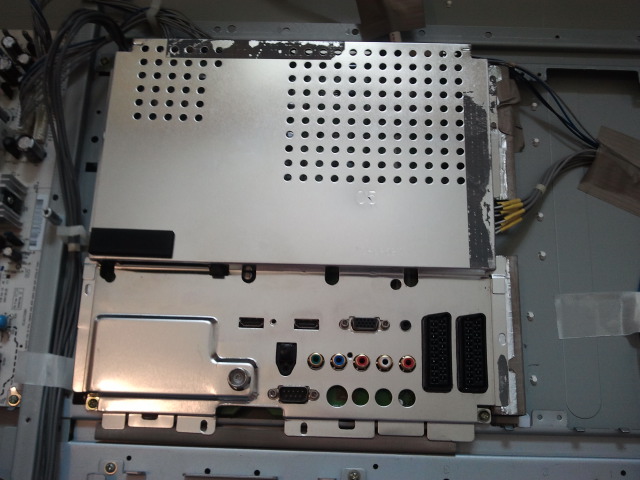

            It would be useful to see pictures of the inverters. LG has produced a number of dodgy master-slave inverters that are failing.

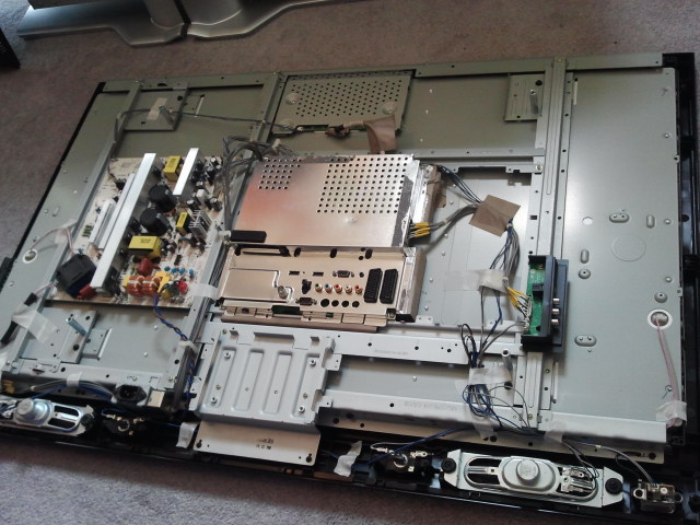

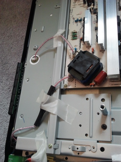

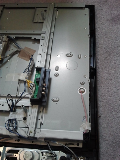

              hi plain bill. where are the inverters? theres 2 single wires, both goin from psu to either side of the lcd, it doesnt even look like the inverters are seperate but i might be wrong, i cant see how they come out??

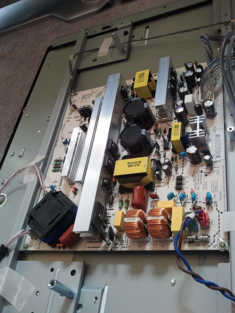

                That PSU has bulging caps in it, I'd replace the circled ones first.....

                  Re: LG 42LF65 LCD (No picture - Sound ok)
                  so thats:
                  1 x 2200uf 10v
                  1 x 3300uf 10v
                  went to maplin in uk today, no luck.
                  im going to google.
                  Thank you, i will keep you informed.

                    I strongly suggest that you change all eight of the caps in that section. There is no way that I'd not suspect the remaining caps after I found two bulging. If you cannot find what you need nearby, order them from either here badcaps.com or digikey.

                      This panel is a newer panel that does not have inverters. Many of the newer LG Panels have the inverter contained on the Power Supply.

                        right i found the 2 caps i needed in my glory cupboard. replaced the 2. still the same problem.
                        im debating whether to just pick up another power supply tomorrow. 30 mile trip to bolton, thats when i get home test it and still same problem. fingers crossed.

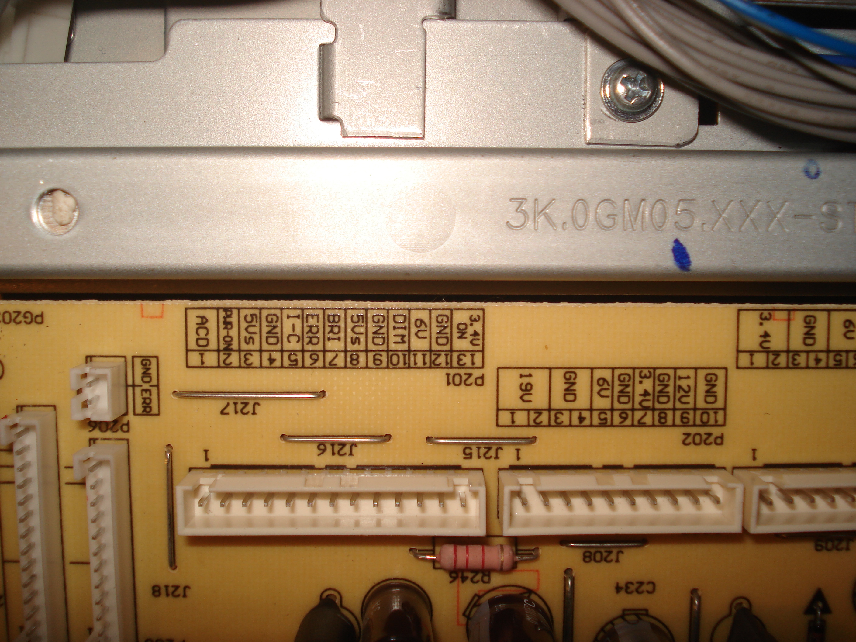

                            I have the same issue. No back light. I can see faint picture with flash light. But I have two slave inverter left and right. Is there any way to test the inverter? Anybody can tell me if I have bad inverter or faulty power supply?
                            I am getting 24v from power supply for inverter. But I am getting only 1.9V output for main board where it should be 3.4 volts ON.
                            Is is possible that this low voltage stopping the inverter from turning on?

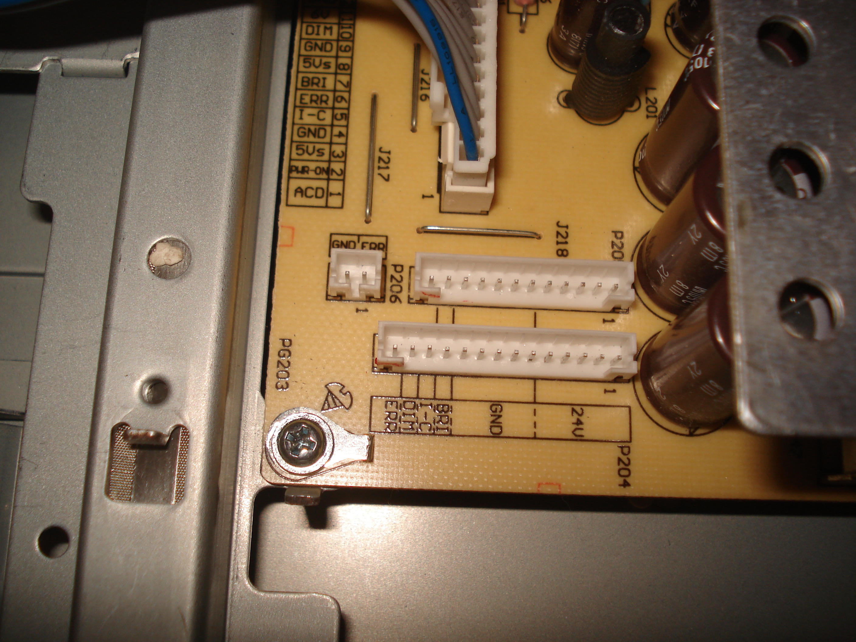

                              If your sound is ok and also since you do have a picture without the backlights, I would mostly suspect that the master inverter is good but the slave is probably the problem. Usually, you won't get any picture at all with a bad master. I could be wrong though.
                              Take the coverings off of the master and slave inverters and post pictures of the boards. There should be four mosfets that need checked on each board.
