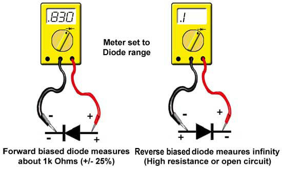

              The diagram below shows how to connect a digital meter to test the diode. There are a number of things to remember:
              • Make sure you are using the diode range.
              • Using a digital meter, connect the black lead to the cathode and red to the anode (forward bias - around 1kΩ).
              • Reverse the meter connections (reverse bias - infinity reading).
              * Note some times depending on how diode is wired into circuit may need
              to remove or lift one side for more accurate reading.
              Ron Driver,BSEE,CET,ISCET,NESDA

                Interesting results. I did unsolder one side of each diode to check them out of the circuit. When I put the meter on diode check, it said 0l. So I assume that is an open circuit.
                D607 gave readings of 0l in one direction and 707 in the other. No sound. Diode D668 read 1s in both directions and the meter made a continuous sound.
