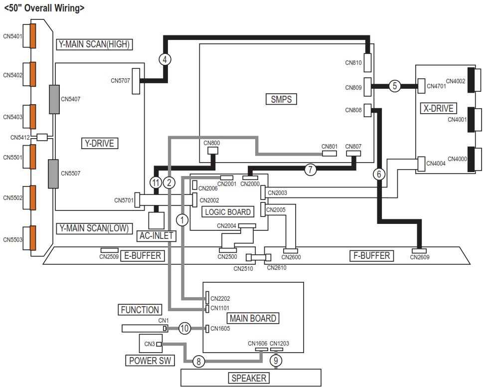

    I have downloaded the Service Manual. http://elektrotanya.com/samsung_f30a.../download.html Overall Wiring diagram attached below.

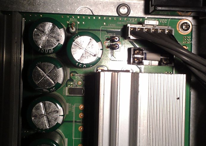

    3 fuses found and checked. 2 on SMPS board OK. 1 on Y-DRIVE board next to the power lead connector CN5707 is blown. Marked 3.6A.

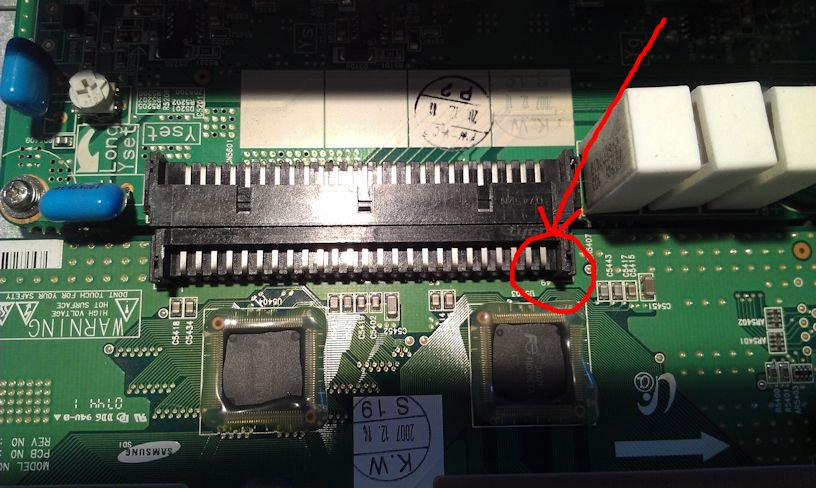

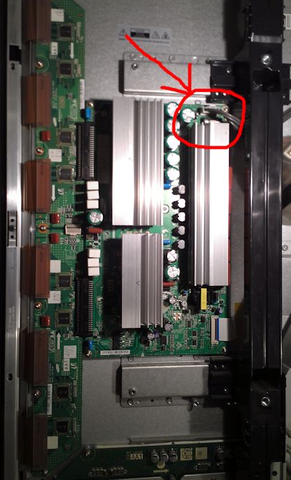

        Can you post a picture of that fuse?
          Re: Samsung PS-50C96HD - No picture - help needed
          The lighting in the room is not tooo good. I used a small halogen desk lamp to get better light but it isn't the best.
          Images are;
          The board with a circle indicating the fuse location.
          A closer view of the fuse location.
          The fuse.
          Is that what you are after or do you need something else?

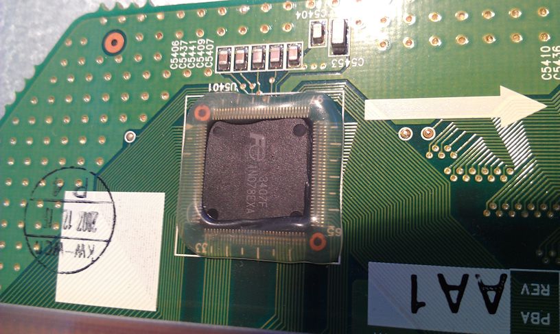

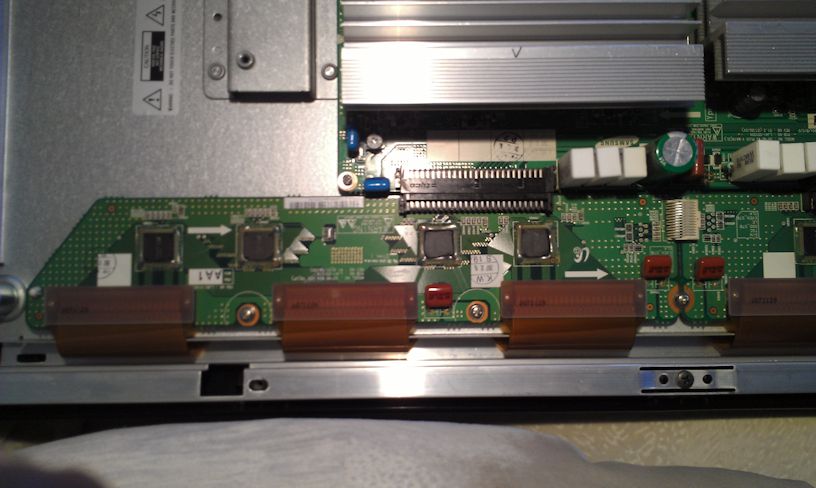

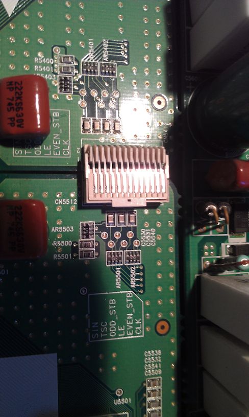

            Check the surface mount chip on the top right hand board hooked up to the Y-main board (the one with the fuse.) Does it show signs of failure?
              Do you mean the board top left [Y-MAIN SCAN (HIGH)] as viewed from the back?
              All chips on Y-MAIN SCAN (HIGH) & Y-MAIN SCAN (LOW) appear to be good. Attached is an image of one of the chips as an example.

                  You would want to check the Y-buffers, which is what you have taken a photo of above, not the E & F.

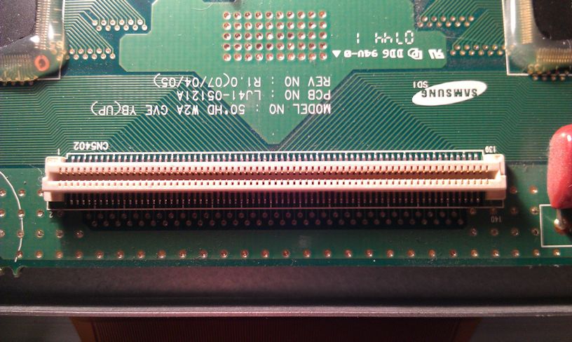

                    Same procedure? The Y-MAIN SCAN is in 2 parts (high & low) with a small connector between. I am assuming I need to check for shorts between the connectors to the PDP and the connector to the Y-DRIVE board.
                    My main question is which pin(s) should I check from on the Y-DRIVE connectors (CN5407 & CN5507)? Both have a single pin marked as 49. Pin 49 on both are closest to the centre connector between the boards. See Y-MAIN_to_Y-DRIVE_connector image attached.
                    Can this be done without removing the board. Not a problem, just quicker.

                      If you look at my video you linked, you can see me test this same buffer board from a very similar model. It's been a while since I did that test so can't quite remember where the test point is.
                        Your video? LOL!
                        From the video it looks like the pin furthest from the middle connector. Off to test so back in a while.
                          The good and bad news.
                          The Y-MAIN SCAN(LOW) board read OL on all pins = good.
                          The Y-MAIN SCAN(HIGH) board had non Open Circuit readings on most pins = bad.
                          I uploaded a video of the meter readings while testing the pins on the outside of the CN5401 connector. Most are other than Open Circuit. http://youtu.be/4xVM6HYemkQ

                              Yep. that's dead. I don't think these TVs blow these buffers when they get cracked screens. But you can replace the top buffer chip.
                              You also need to repair the Y-main. If the fuse blew you're probably looking at the 88N30W's being bad on one of the large heatsinks.
